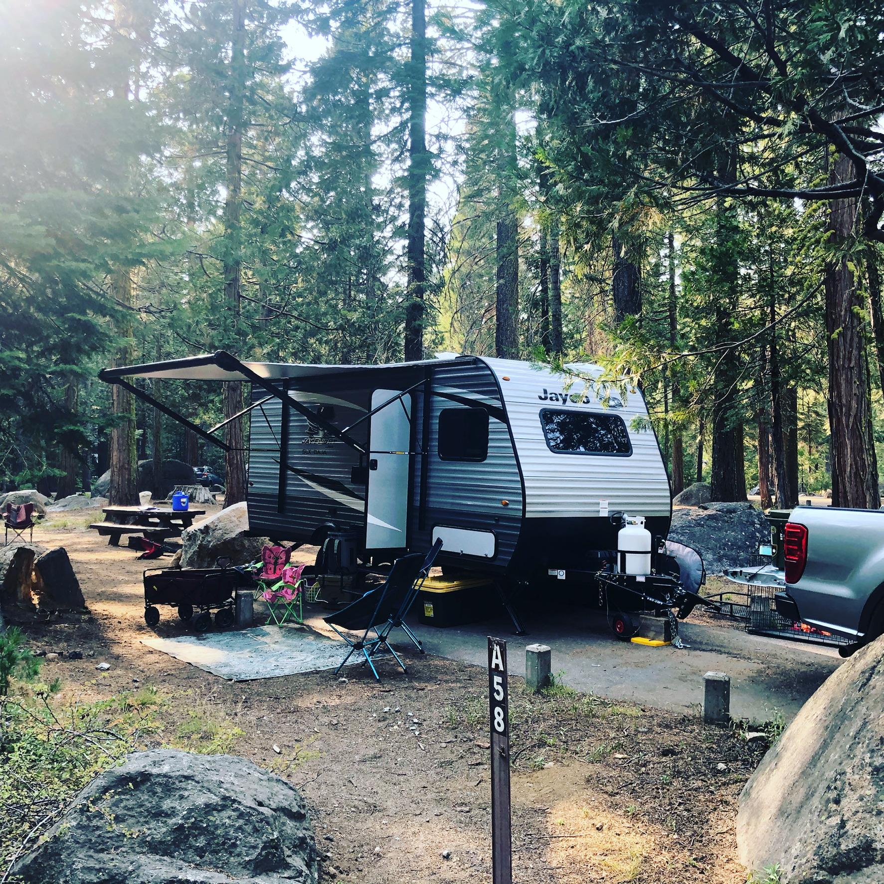

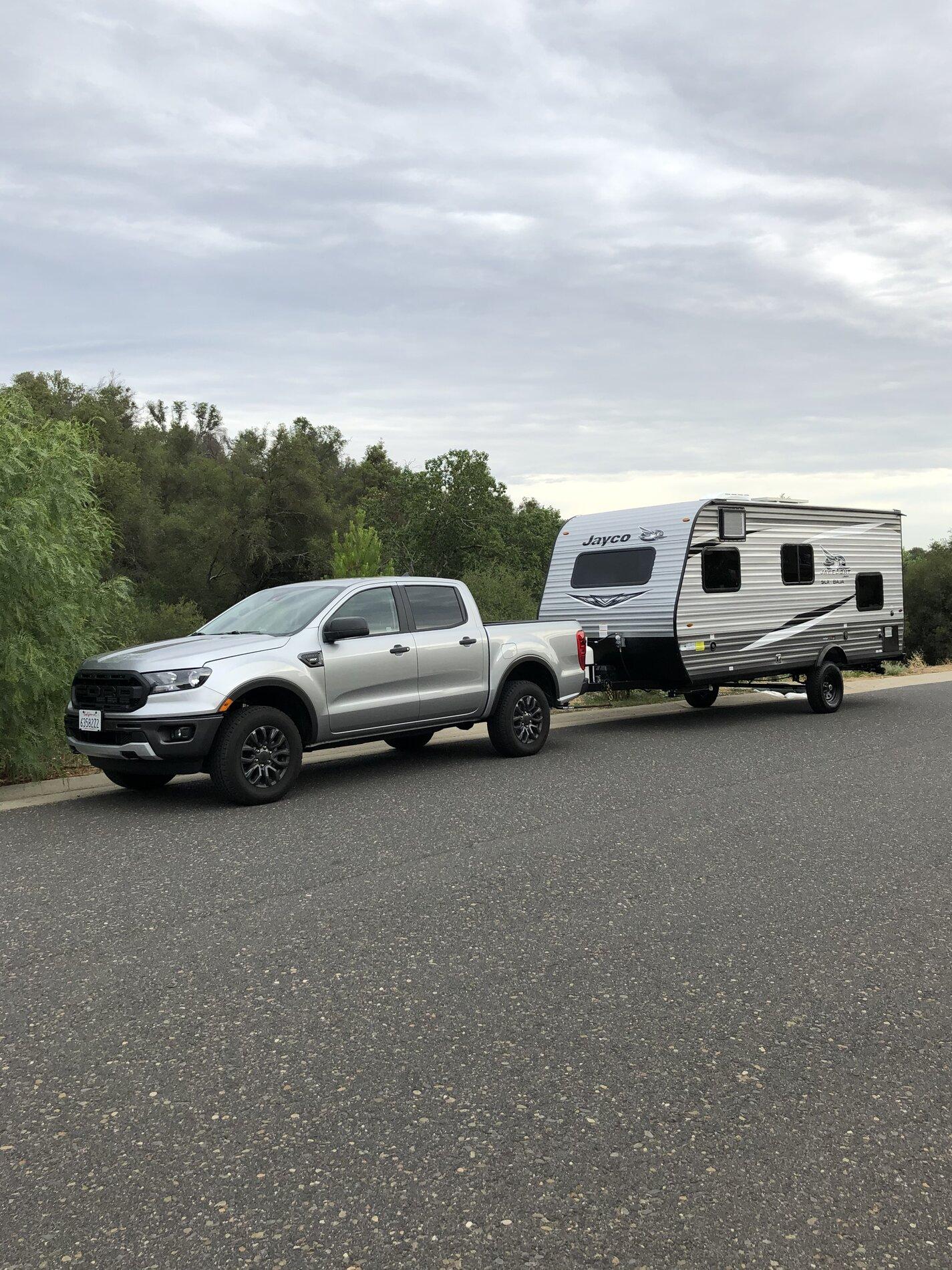

I drove over 5,200 miles with our travel trailer now called "Treehouse" and noticed that the truck is optimally when I go 55 mph. I tried to keep the RPM under 2K and it seems to do better. I, also, use premium gas whenever I travel with the Treehouse. The MPG is much better whenever it is under 2K. Does anyone experience the same?
