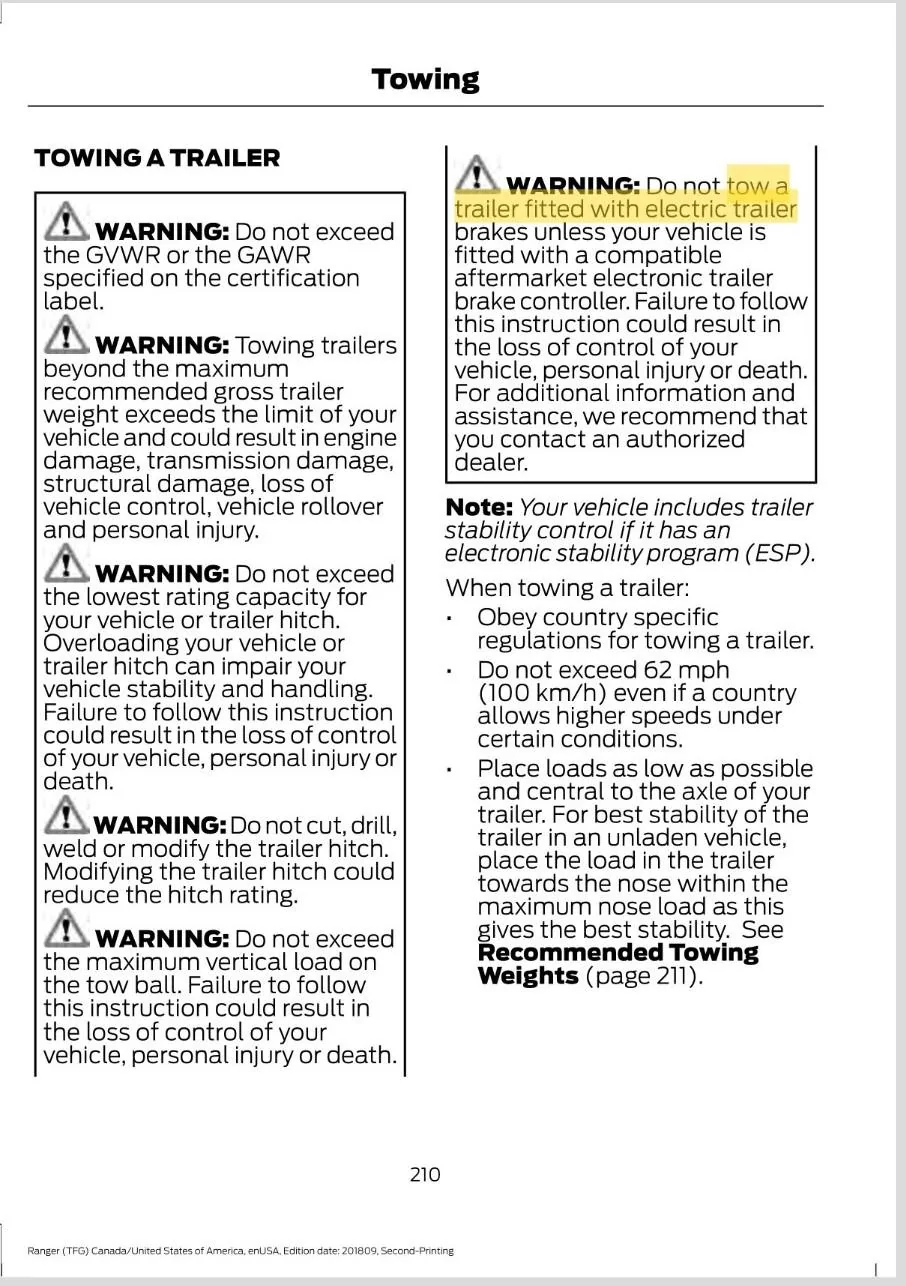

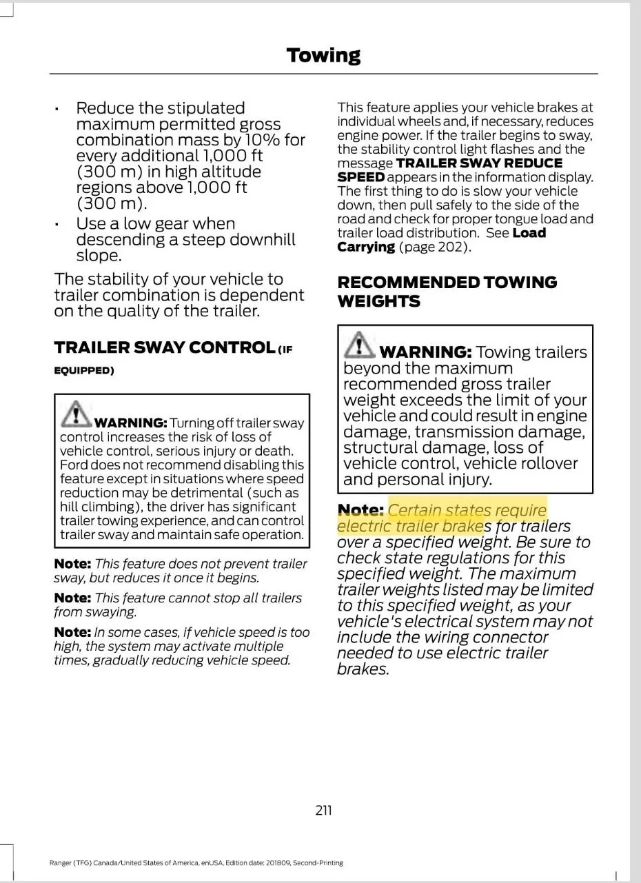

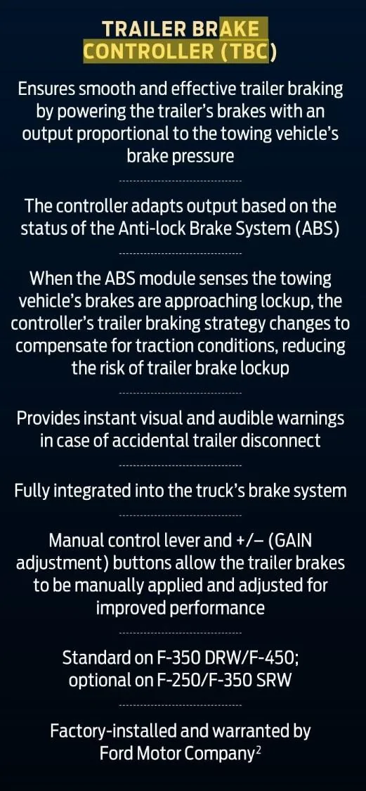

It states it needs brakes, not a TBC. 2 different things entirely.
Thanks for the correction! I have much to learn and am glad I'm not moving quickly. I went back and looked at the 2019 Ranger manual and the Ford tow guide searching for TBC and trailer towing. Sharing the snippets for information.

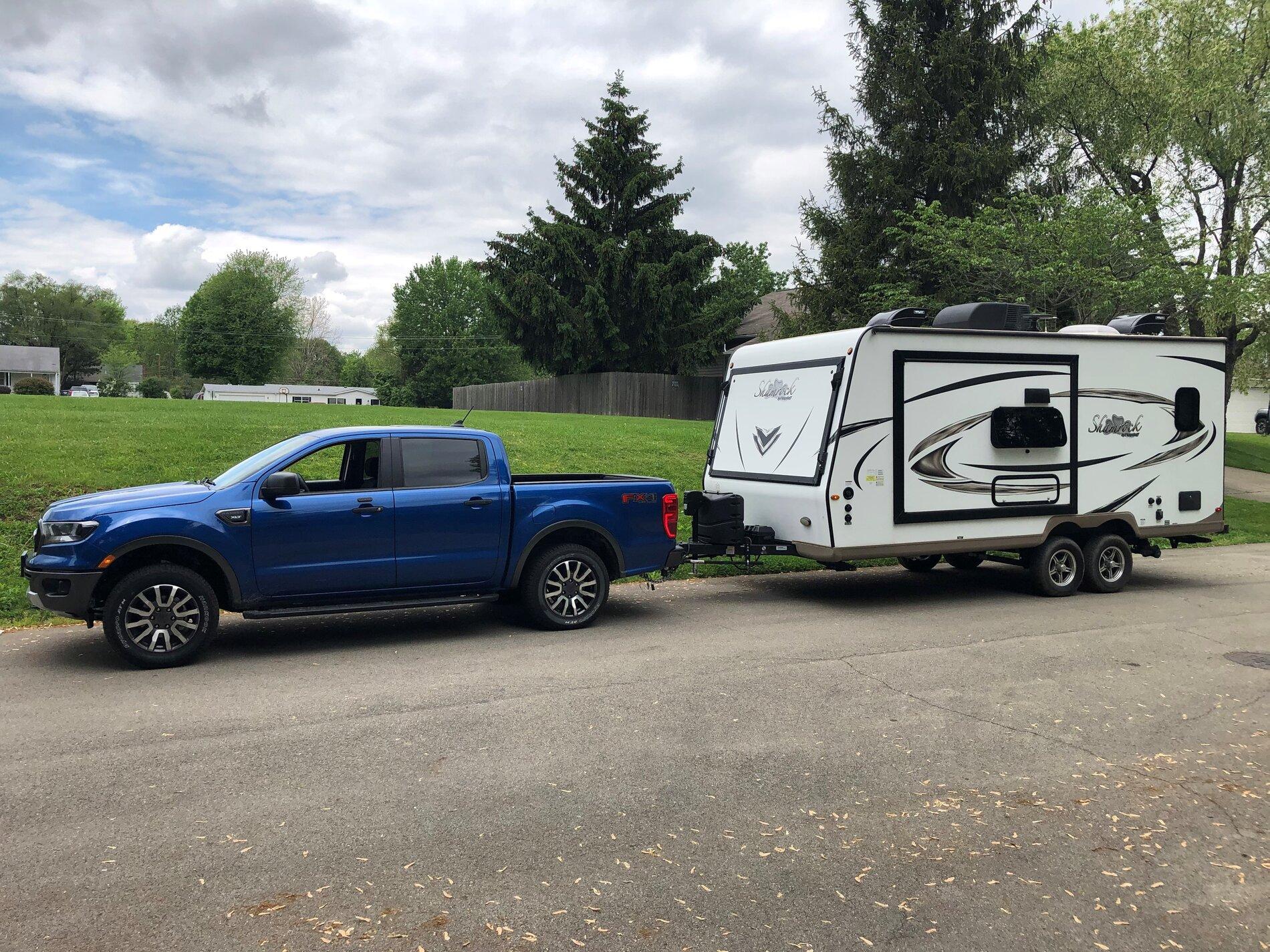

We have a Hybrid camper that works great for us. It is a Shamrock 21DK (same as a Rockwood ROO) . As you can see from pic it has a large slideout (Kitchen). 2 Queen size beds on each side and a U dinette that makes a full size bed and a bathroom with small tub/shower. Dry weight is 4350#. Probably close to 4800# loaded with gear. I have no issues pulling this. I just pulled it 500 miles down the interstate at 70 mph over labor day weekend. I was getting 12-13 mpg. I get 14-15 mpg at 60mph on state roads. It is Indiana...so relatively flat. I have a E2 Weight distribution hitch, which works great. On top of that i usually have bed full with 2 kayaks and 2 adults in the cab. Not sure i would like anything bigger than this for long hauls. I has seen what other are pulling and not sure I would push the weight of a camper over 6000 lbs, but that is me. Also, I have the Ford authorized Brake controller. One of the issues with a bigger camper can be the front wind resistance with the higher weight.

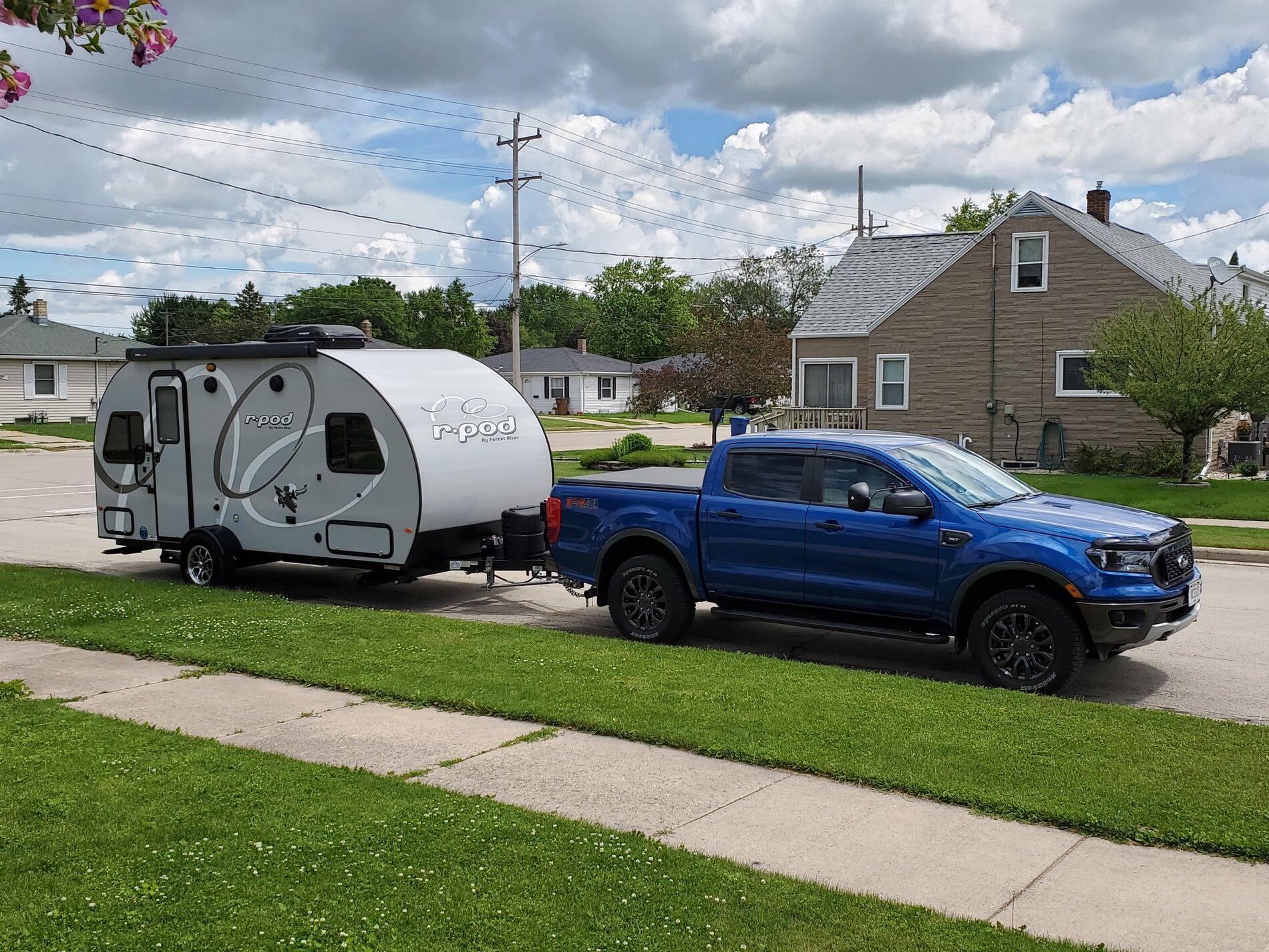

I'm pulling an R-POD 191 and we love it. Just the right size for the two of us. They make a number of floor plans some even a little bigger than ours. I'm using a Husky Centerline hitch with sway control and the Ranger pulls it great. I agree with the others on staying below 6000 lb GTW, 5000 is even better. Lots of options out there, so find one you like.
As far as trailer brakes I would go with the Ford controller so I would have the AEB and ACC tie in. I know a lot of people are using the Echo with no problems. I personally am a bit leery of what electrical programing they are using to control the brake based on the trailer brake lights. I also like having a hard wire button to manually apply the breaks if needed. Seen to many bluetooth connection issues to trust. JMHO. FYI, I have the Redarc controller I installed before Ford got their act together and it works very well.

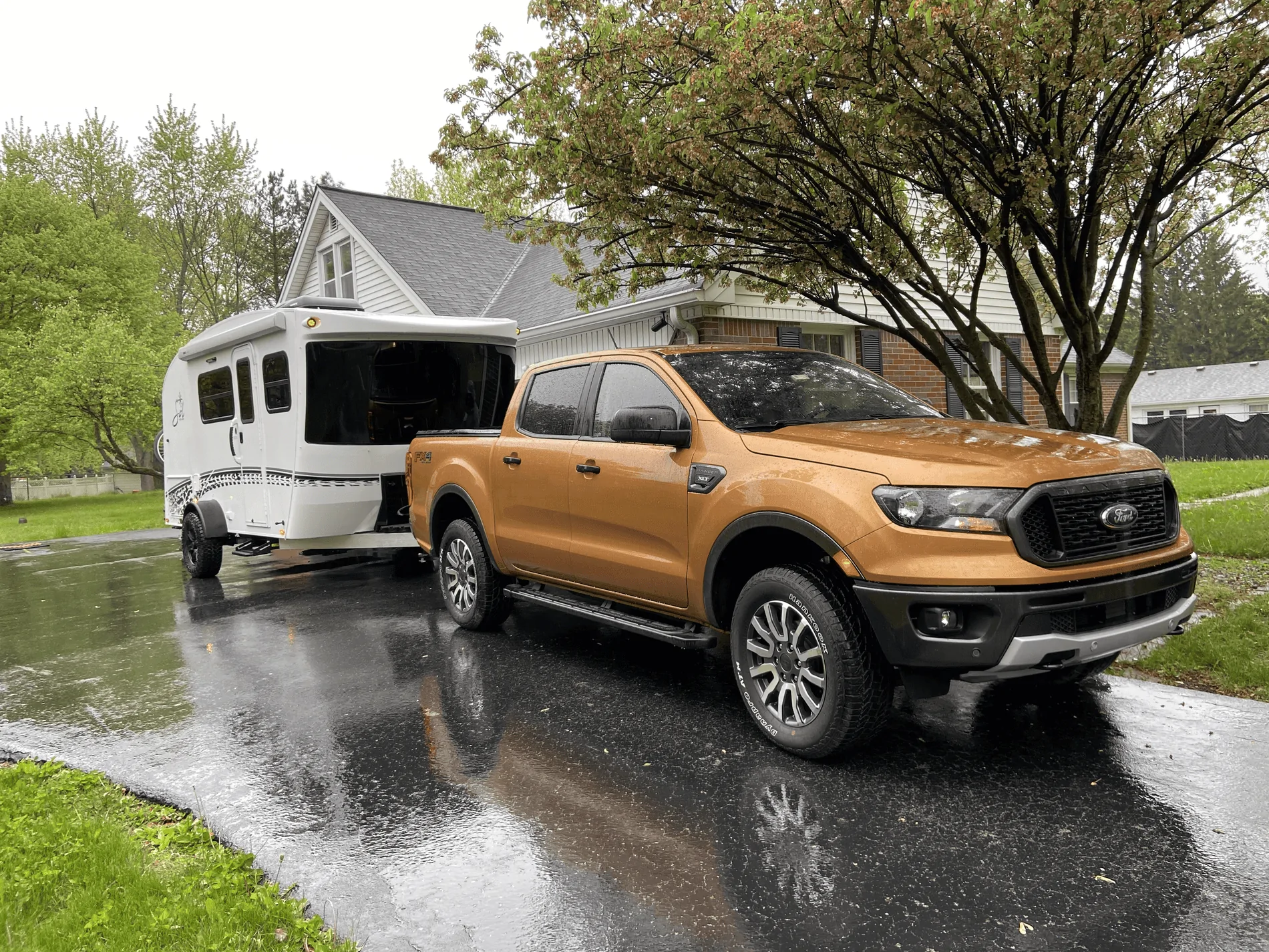

How do these hitches differ from the ones that came originally as part of the standard tow package? Do you recommend a Ford install or the trailer dealership install? What is the approximate cost? Thanks
Ford dealership install it on my truck. I would encourage you to check out www.intechrv.com and they make wonderful travel trailers. I love their wet bathroom. So huge. Depends on the model you select of Sol travel trailer. The bathroom for the three models is same. The largest one (Horizon) has a kitchen outside which is a deal-breaker for us. Its weights at #3500.
