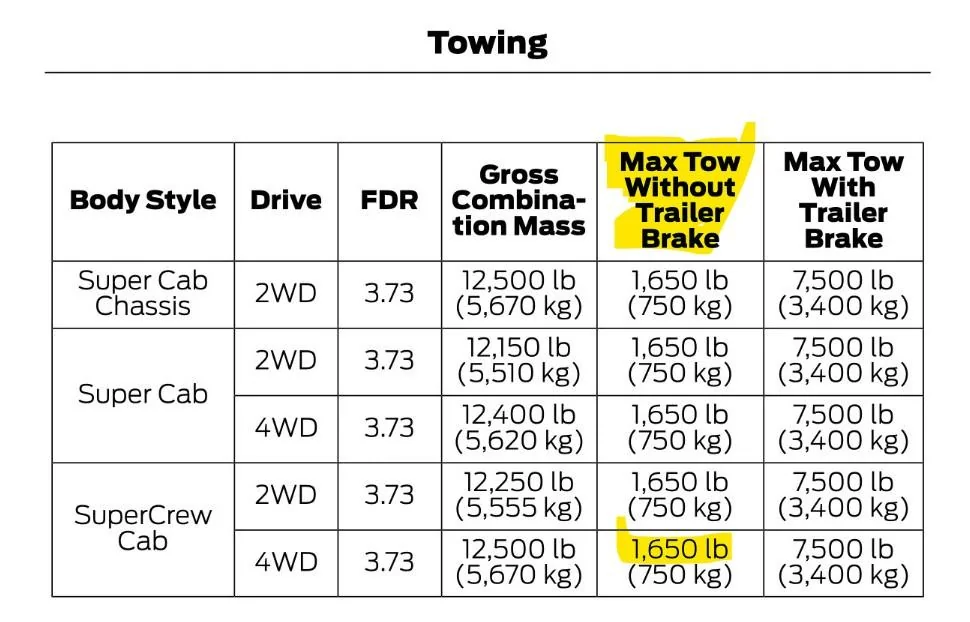

The Ford Ranger towing guide states anything over 1650# requires TBC. On Solar: Several manufacturers offer this as an option but you will need to consider a few things.
  • Type, weight and quantity of batteries. Standard lead acid have limited ability to use stored energy (you may get 50-60% of rated charge) and LiPo batteries carry close to 100% of available storage. Batteries weigh a lot and are "additional" weight if adding one or more. Look also at the inverter size. A 1500W inverter will not handle a kuerig that draws 1800W. Most small trailers I've looked at only have a 1000w inverter.
  • Refrigeration: 12V or 120/LP- research, solar may not be the best solution. I'm a big proponent of solar in homes. My place in Baja (offgrid) has run off Solar for 20 years and stateside house for 7 years. That said, I'm not 100% convinced that I'll get what I need with 2 batteries and 2 panels. Sometimes you don't know until you do it.
  • Solar adds weight also.
  • Go to a site like lance trailers that lists the weight of the options to get a better idea
  • Rpods mentioned here are one of the trailers I'm considering (Lance also but they are pricy)

Check your state laws but a TBC is most likely going to be required for anything over 1,500lbs. Even if it isn't required by law you're going to need one. The official Ford option is going to be the best bet. The normal Redarc works great but the Automatic emergency braking isn't able to active it.
This comment has me curious since Im on the fence about a TBC.
Most states require brakes on trailer with a dry weight over 3000lbs. Thats just brakes on the trailer though, nothing to do with the TBC. The brakes can be surge brakes.
Talking to my local truck shop and friends with campers, none of them seem to think a TBC is necessary for the smaller type of camper Im looking at.

It states it needs brakes, not a TBC. 2 different things entirely.
