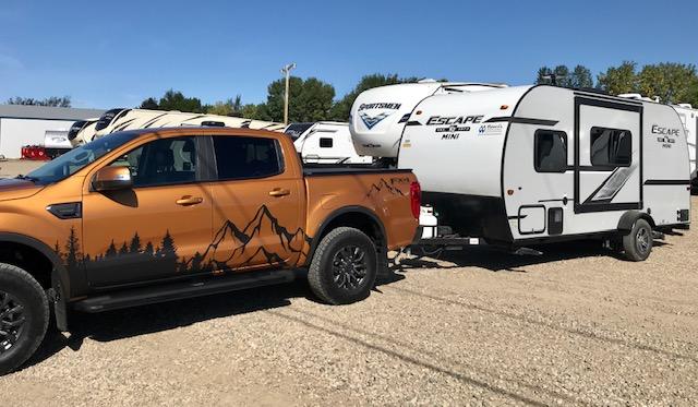

We just bought a 2020 KZ Escape-Mini. 2850Lbs. I can see past it with my factory mirrors. We did a TON of research, wife had her wish list, I had my Technical list for towability. Its basically a couples coach for the 2 of us, can accommodate another adult or 2 smaller kids on the dinette if required.

The sticker set on your truck is something I've always liked (if done right) but am too afraid to do. haha It's such a commitment to a certain type of image. I'm all for that image though. It's almost like me and tattoos. I have nothing against tattoos, but I don't have one because there's nothing I can commit to having on my body for my life. haha
THANKS !
I had those graphics in my head for months before my Ranger finally arrived. Gave a sketch to the stripe shop I dealt with and their graphic artist brought it to life for me. Turned out really good - and I get lots of compliments on it. As for tattoo's = I have many.
