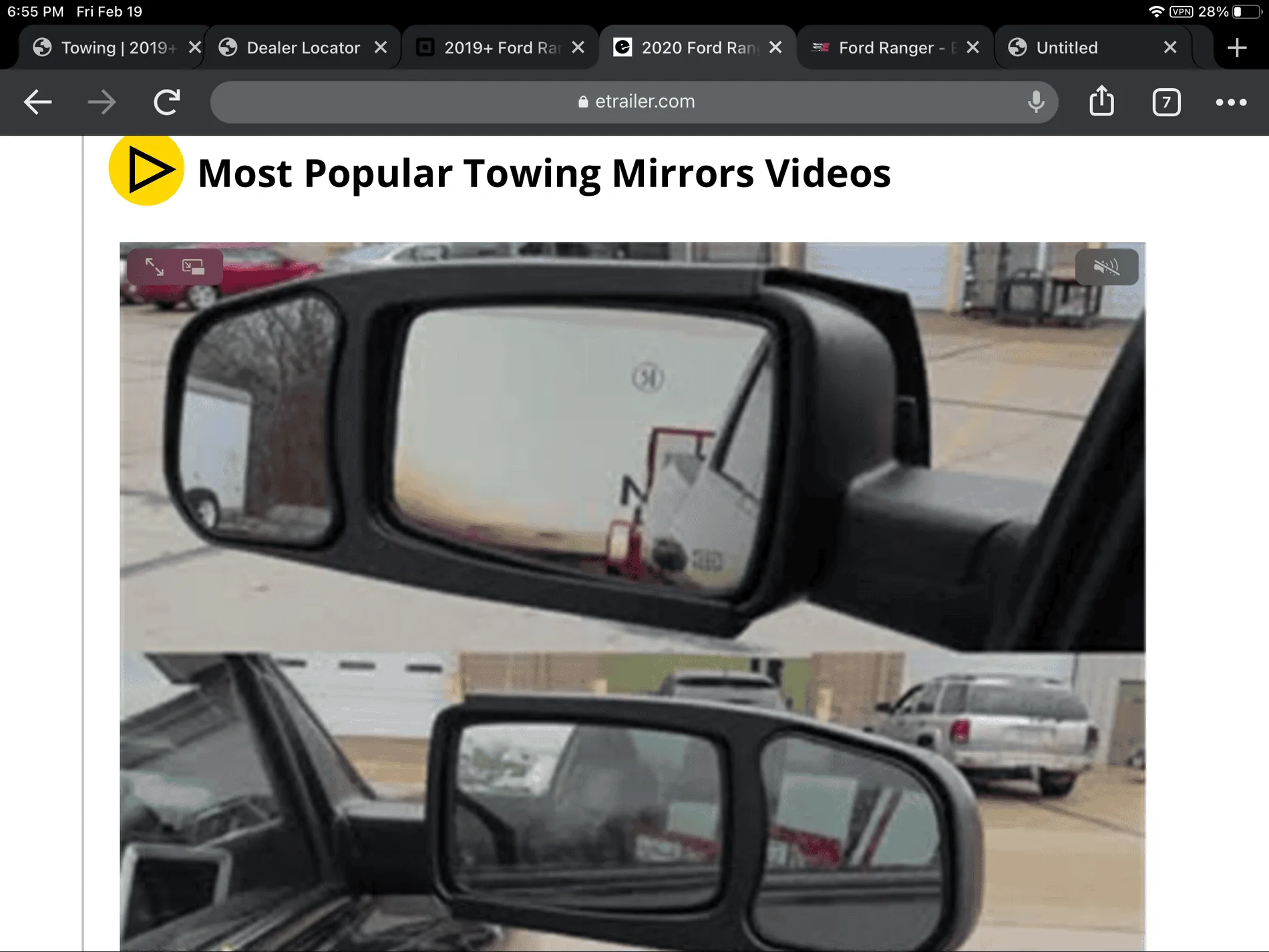

Has anyone seen or know of a slip on mirror that will for our Rangers? Seems like every other truck has one online, just not ours ? I bet there’s one that could be used from another but any ideas? How about in Australia? I’m willing to go to the other side of the world to find a good solution. I did see the thread on the bolt on option, but if it takes out BLIS, I’m not in. Easy on, easy off slip on would be awesome!
Any ideas? Something like in the picture.

I've tried a couple slip on mirrors from Amazon. They were more "slip" than "on" due to the tapered shape of the mirrors. I returned them. I'm waiting for the aftermarket to come up with a working towing mirror. Anyone know of any?

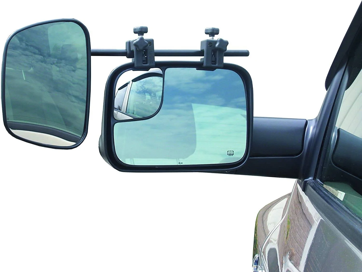

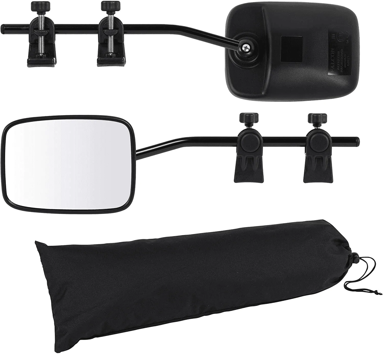

Yeah Ford dropped the ball on the trailer brake controller, why would they think about towing mirrors? Even in Australia it took aftermarket companies. In the US the aftermarket companies make them for the Taco and the Colorado/Canyon but show no interest in the Ranger, even when asked. They say there's no market. WTF
I currently use the Milenco MIL-2912 Grand Areo 3 towing mirror. They clamp on instead of using straps. Just finished a 4700 mile trip across country, 70 mph on highway, no problems. About $110/pair on Amazon.

I use a set with straps and they are very annoying to setup each time. I am looking at replacing them with something like the ones you linked.

I got the Milenco MIL-4381 Falcon towing mirrors over the weekend. HUGE improvement over the set with straps that I was using previously. Much easier to install and remove, and easier to adjust once installed. Major points for how far out from the vehicle I can position them, allowing me to see the rear corners of my trailer and other vehicles behind me.
I have found 2 annoyances with them, though. One is that there aren't separate knobs to loosen the clamps from the bar they are on and to loosen the clamps from the vehicle mirror, which means they need to be readjusted every time I put them on. The other annoyance is that they are a bit small and aren't convex at all, so they only show the specific areas you aim them at and nothing else.
I may return them for the Milenco MIL-2912 Grand Aero 3 towing mirrors like @Big Blue uses. They appear to solve both problems. Reason why I didn't get them in the first place is that they're $150 CAD vs $80 CAD for the ones I chose.
FYI for anyone looking at Milenco mirrors:
  • Falcon = single knob per clamp
  • Aero = dual knob per clamp
  • Grand = larger mirror
  • Platinum = larger and more flexible grips on the clamps
