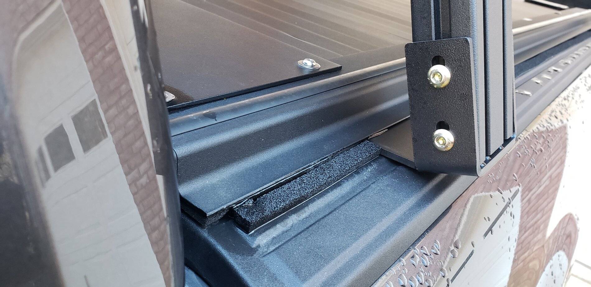

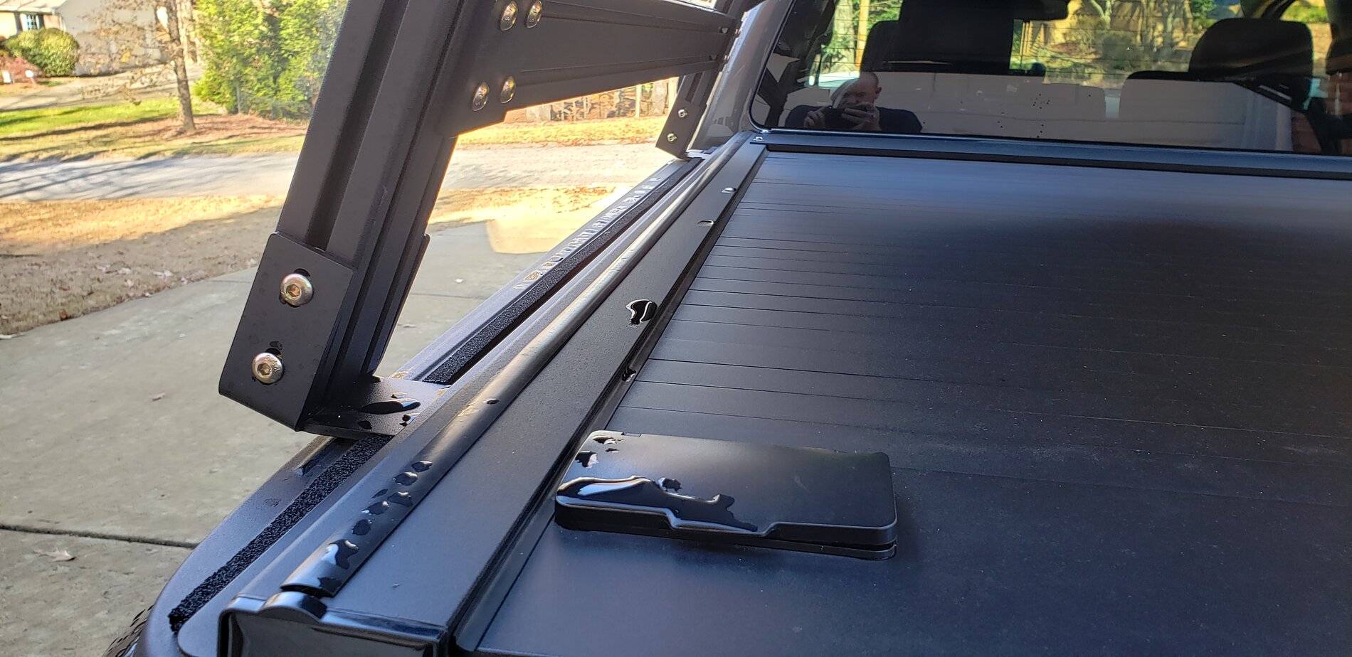

I was literally just looking at this rack on the suggestion of someone in the overlanding group I belong to. It’s a very nice setup, my only question is with how far those mounts stick out. Any issues yet?
They sell different mounts - I went wide to make sure I cleared the tonneau. They don't stick out horrible at all, in my opinion!

Might just have been the angle of the one picture. Just looked like it was out there a bit. 2nd doesn’t look so bad.

I think the bed tapers in towards the rear.

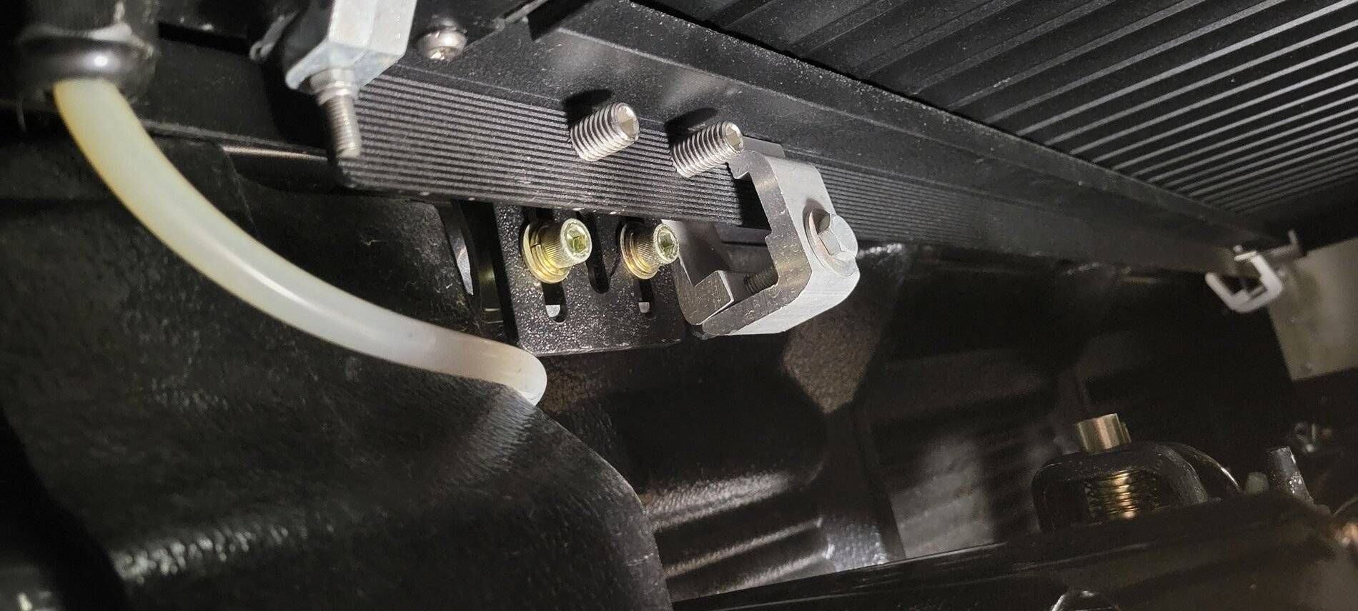

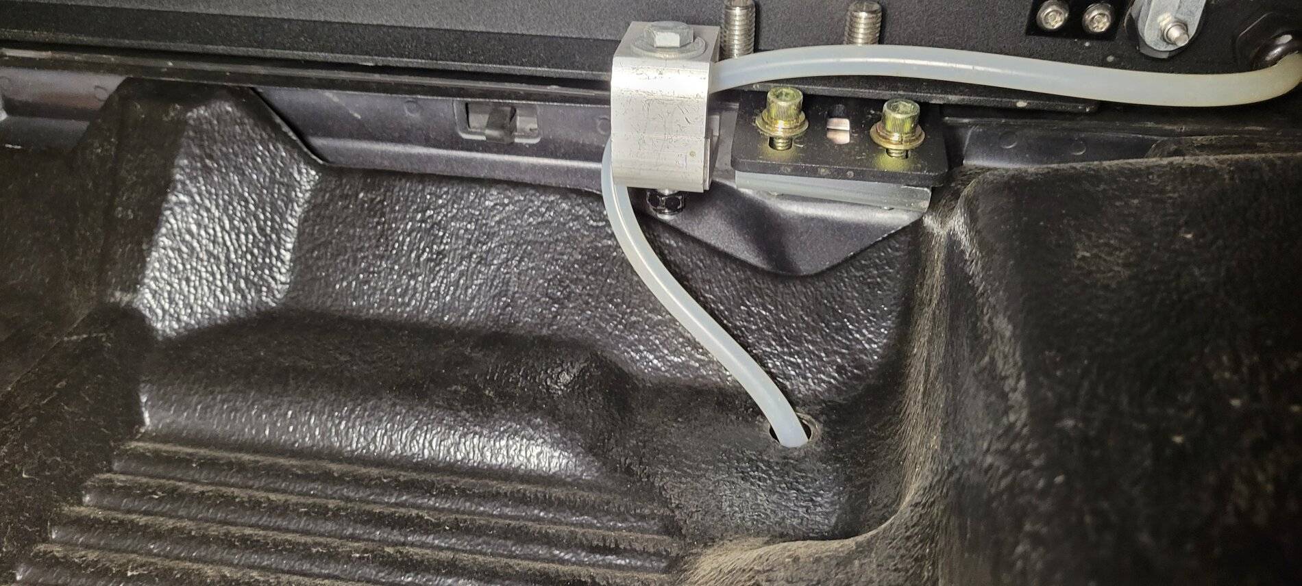

Not the best photos but here you go. The black bracket with the two gold colored fastners is the bed rack mount. The long extruded black aluminum with the silver clamp and two silver threaded studs is the bed cover.
I love this bed cover by the way. It does take up a little room in teh nose of the bed but I love the cover all-in-all.

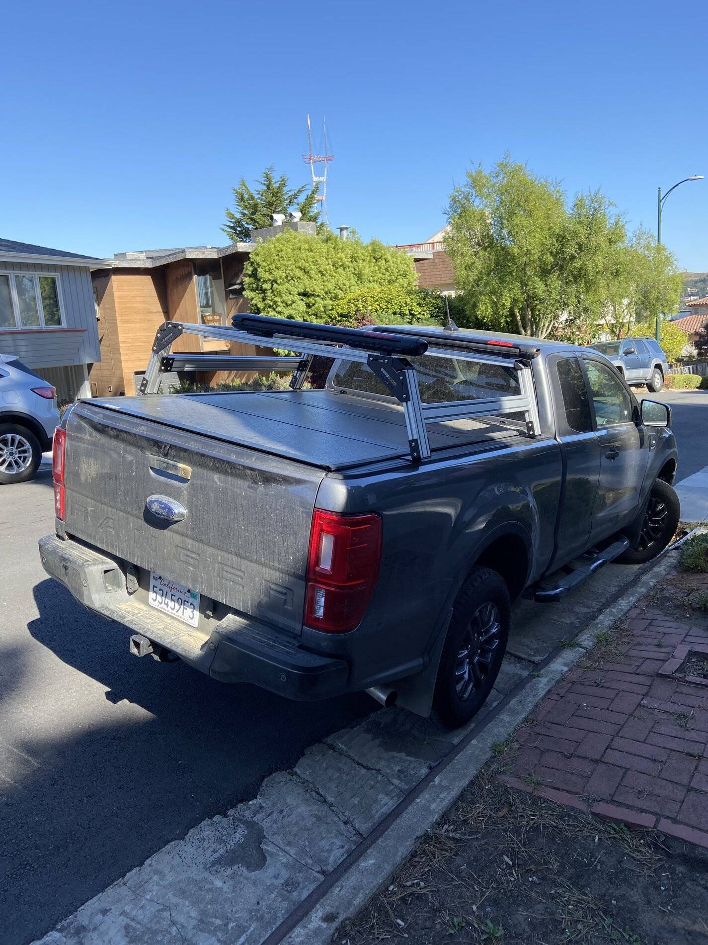

Here’s my setup…xtrusion xtr1 with Yakima Fatcat 6 Evo ski racks. Hard fold Gator tonneau. Haven’t fully tested it all out…need snow to do that :)
The tonneau doesn’t open very much…but in fact I don’t want it to. The idea is to raise up the back third and hook it open. Then slide in/out a bin with the ski gear or whatever. Any greater opening will bring too much snow in.
And yes, I know the truck needs a clean.
