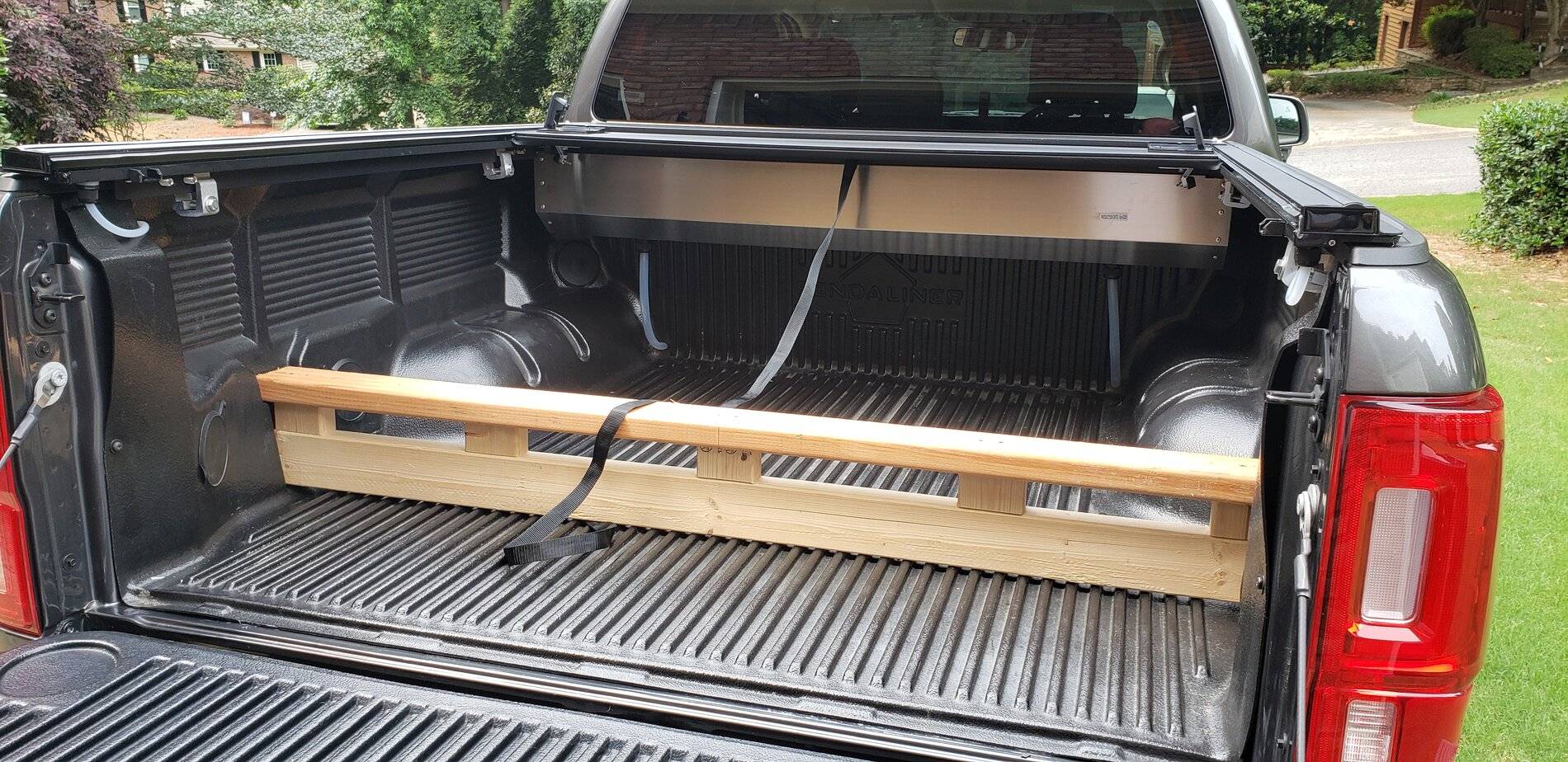

The length is dependent on the inside length of the bedrail. If you pop your tailgate you'll see you loose about 6" of bed rail due to the interior contours of the bed sides.

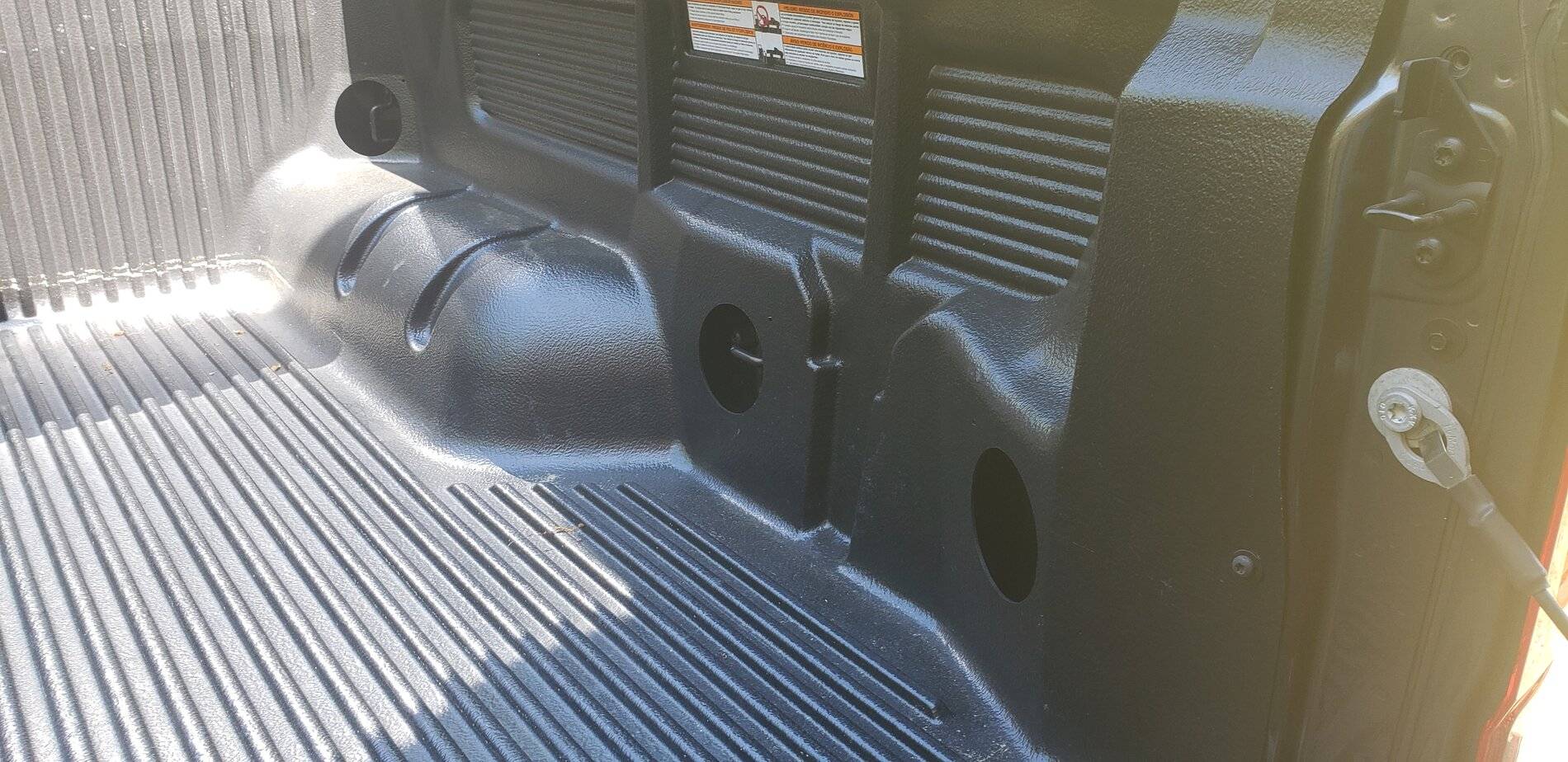

No, what I'm saying is the contours of the bed side interior limit how much room you actually have to install the brackets. On the 5' bed, you can't actually center the rack front to back on the bed because of the interior bed contours. I've highlighted on this image what I'm talking about. The bed brackets only fit onto the truck in the space highlighted by the blue line.

Ooooohhhhhhh. That makes a lot more sense. Appreciate the additional explanation!! Shoot so that makes my idea more difficult or maybe impossible idk. So what RTTs can you actually fit up there then if you only have 48” of rack space to accommodate anything. Even the smallest RTT by Roofnest is 60” when it’s closed which is why I was hoping to be able to use the 6’ bed version of the rack which is 58” long and I’d only have 2 inches of overhang which could easily be accommodated over the cab.
if what you’re saying is accurate; what RTTs are compatible with a 48” rack? That seems really small.I guess I could use a 60” RTT on a 48” rack but that sounds like a lot of overhang in either direction. I would be concerned about even weight distribution at that point.

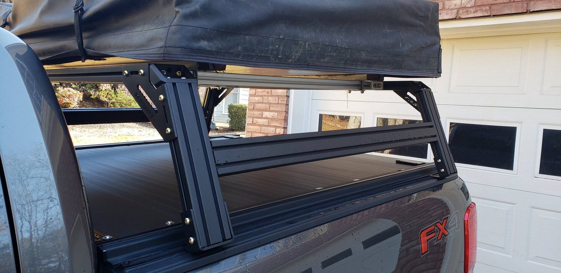

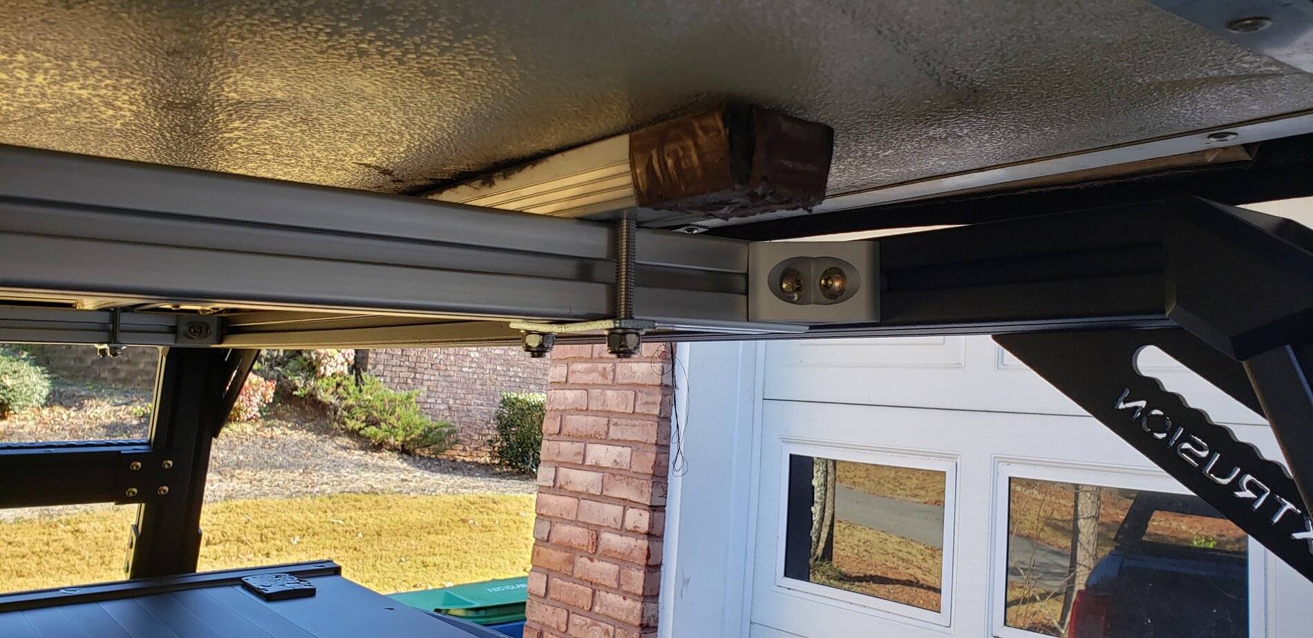

Here are some better pics of my RTT on the rack so you can see how I've got it mounted. I could've moved it back several inches but I'm good with how it's all mounted it.
