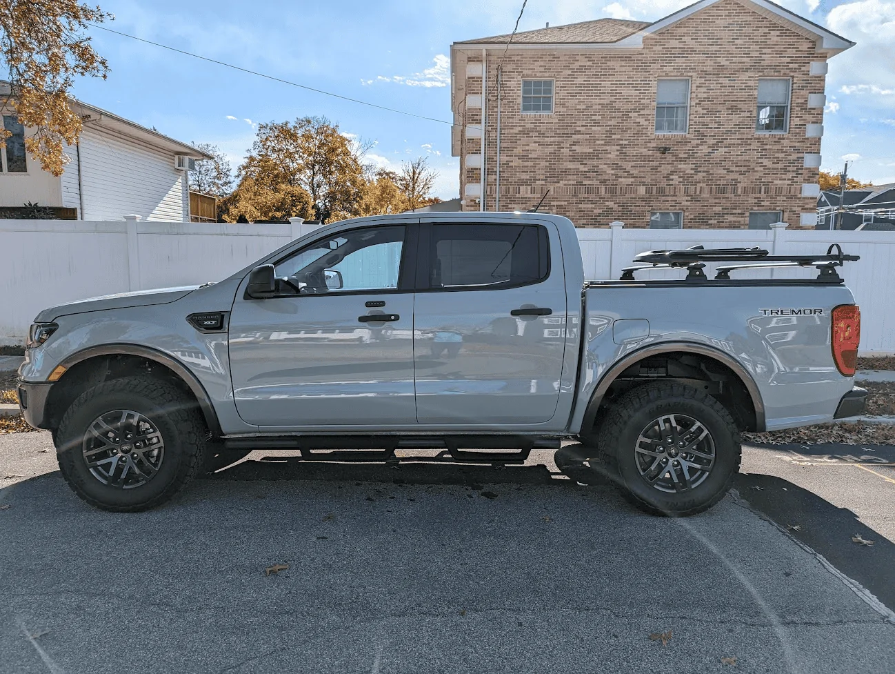

As usual, the best answer is "it depends"
I have the Ford version of the Embark Retractable Locking Tonneau cover on my Crew Cab.
I used the Yakima Outpost which puts the top of the rack (bottom of the tent) basically at the cab roof level. The system worked great and I even had a 4 gallon rotopax hanging on one side.
But that is not what you asked for. The Bedrock is the lowest system that Yakima has that will will work with the Embark hard cover. https://yakima.com/products/bedrock-hd-system
One thing to keep in mind is how your RTT is configured. The Yakima RTT I used had windows on 3 sides, which meant the rain fly needed to extend over the roof of the cab.
Well, I guess unless I wanted to have the door facing frontwards so I would have to crawl out onto the roof to exit..........

Do you have a link to those towers and bars by any chance. Great looking truck also.
