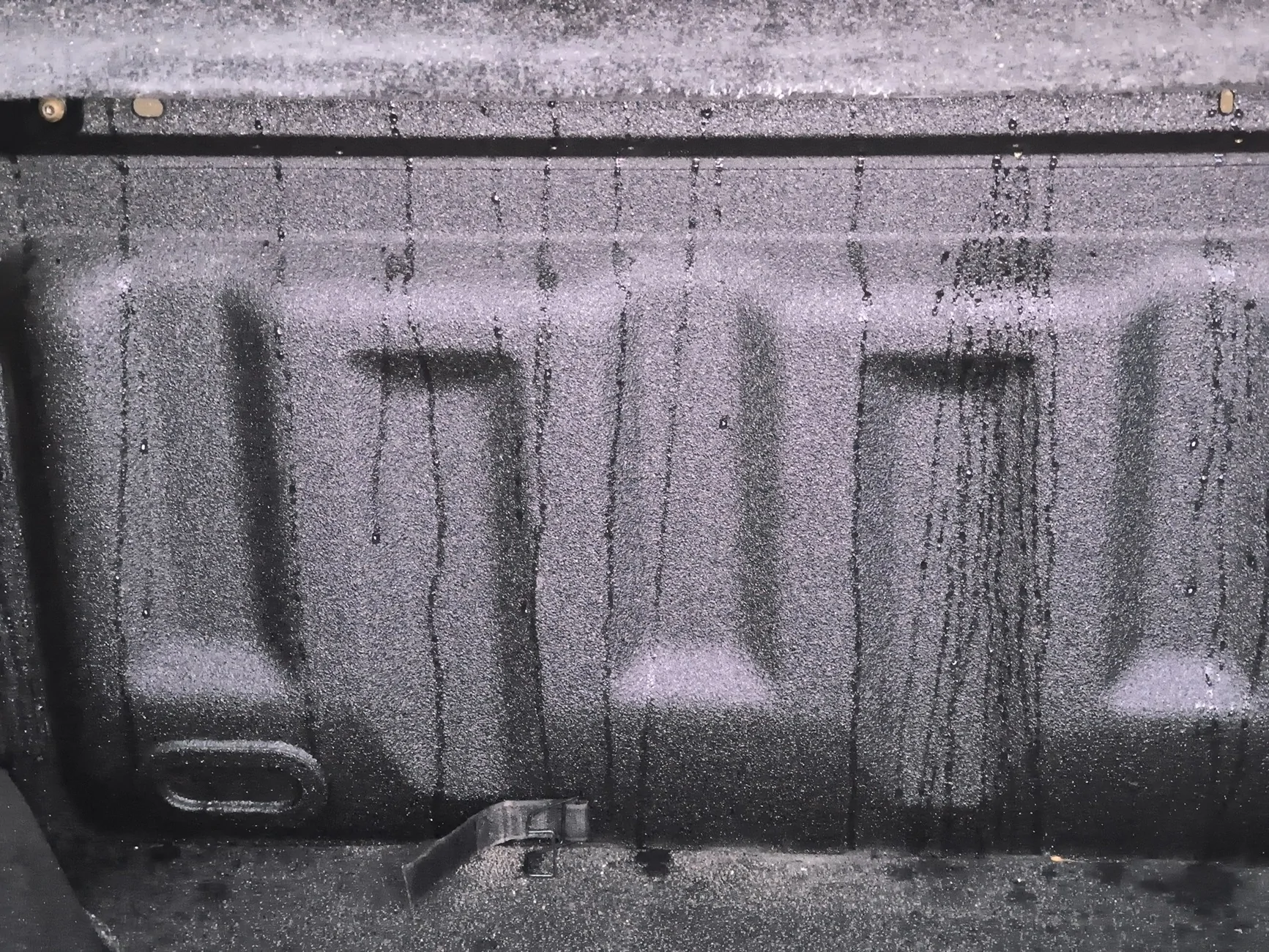

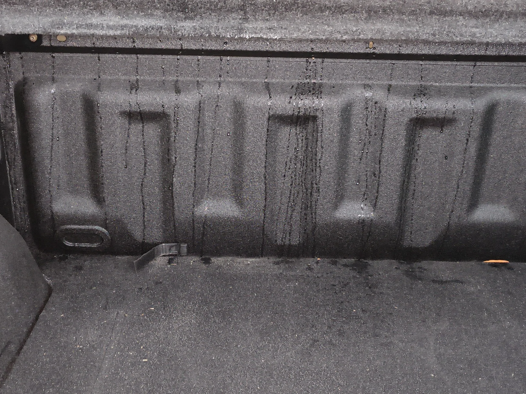

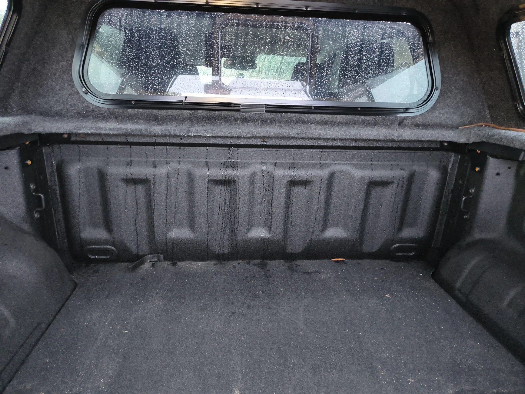

I have a 2025 Ranger. I had a A.R.E. topper installed and it leaks in the front, at the bulkhead. For some reason, Ford designed that drone beam with holes in the to, sides and bottom. It's actually a "C" beam, not a solid beam
So, be aware of this if you are planning on installing a topper or even a tonneau cover. It will leak in heavy rain.

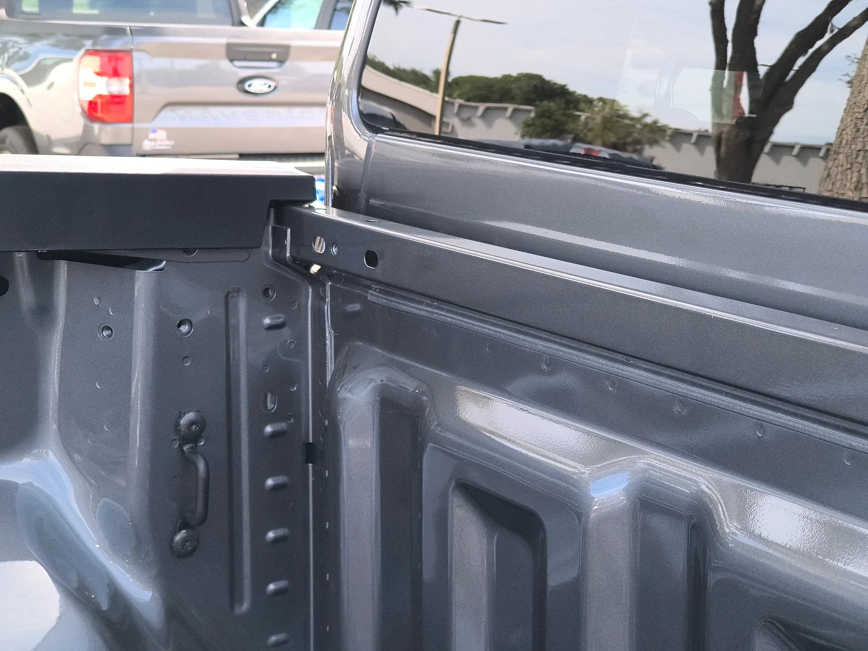

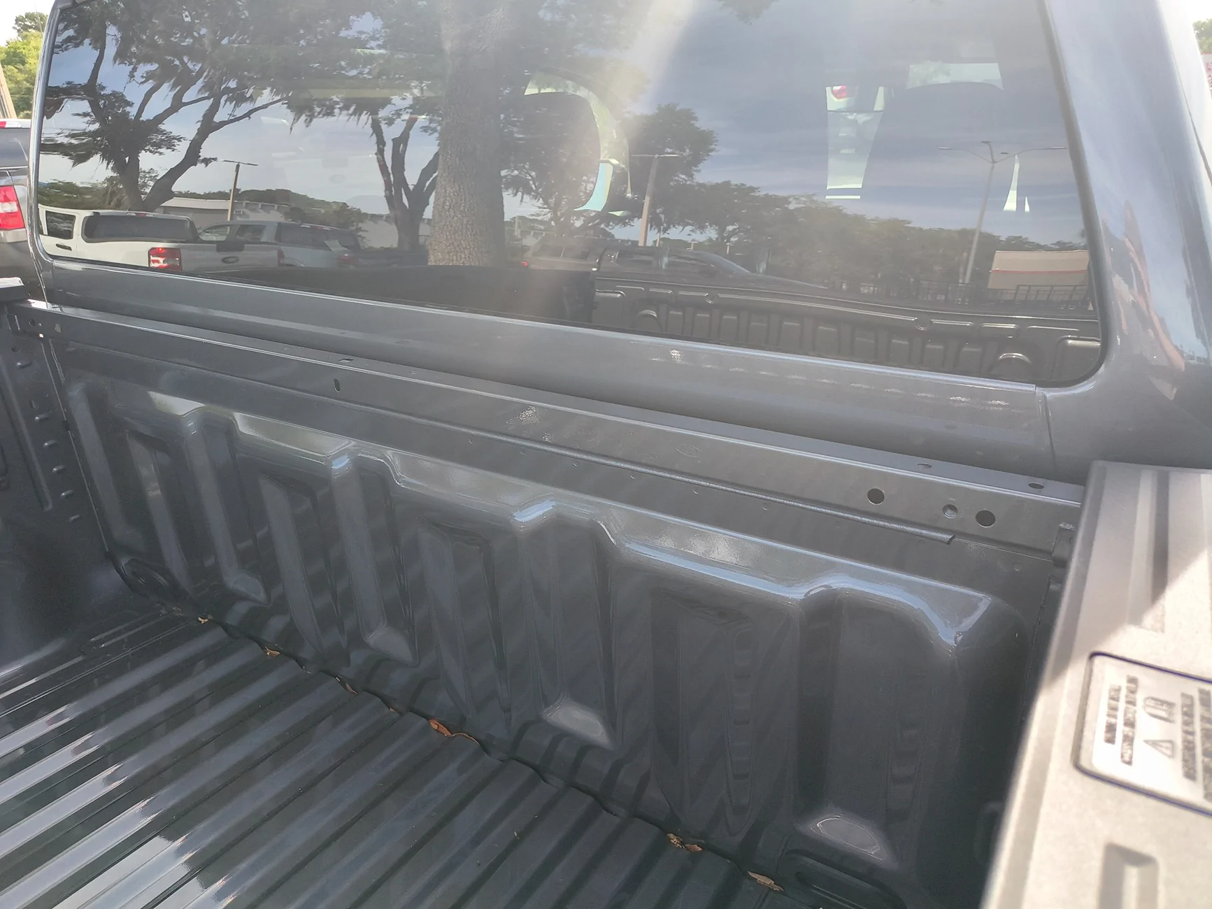

I went to a dealer and took pictures of the area to see why the topper place said they couldn't stop the leak.
I also looked at the F-150's and they have a solid beam, no holes.
Pictures enclosed.
Look closely at the holes in the beam. They are in the top, bottom and sides. Look especially in the corners. You can see light coming thru.
