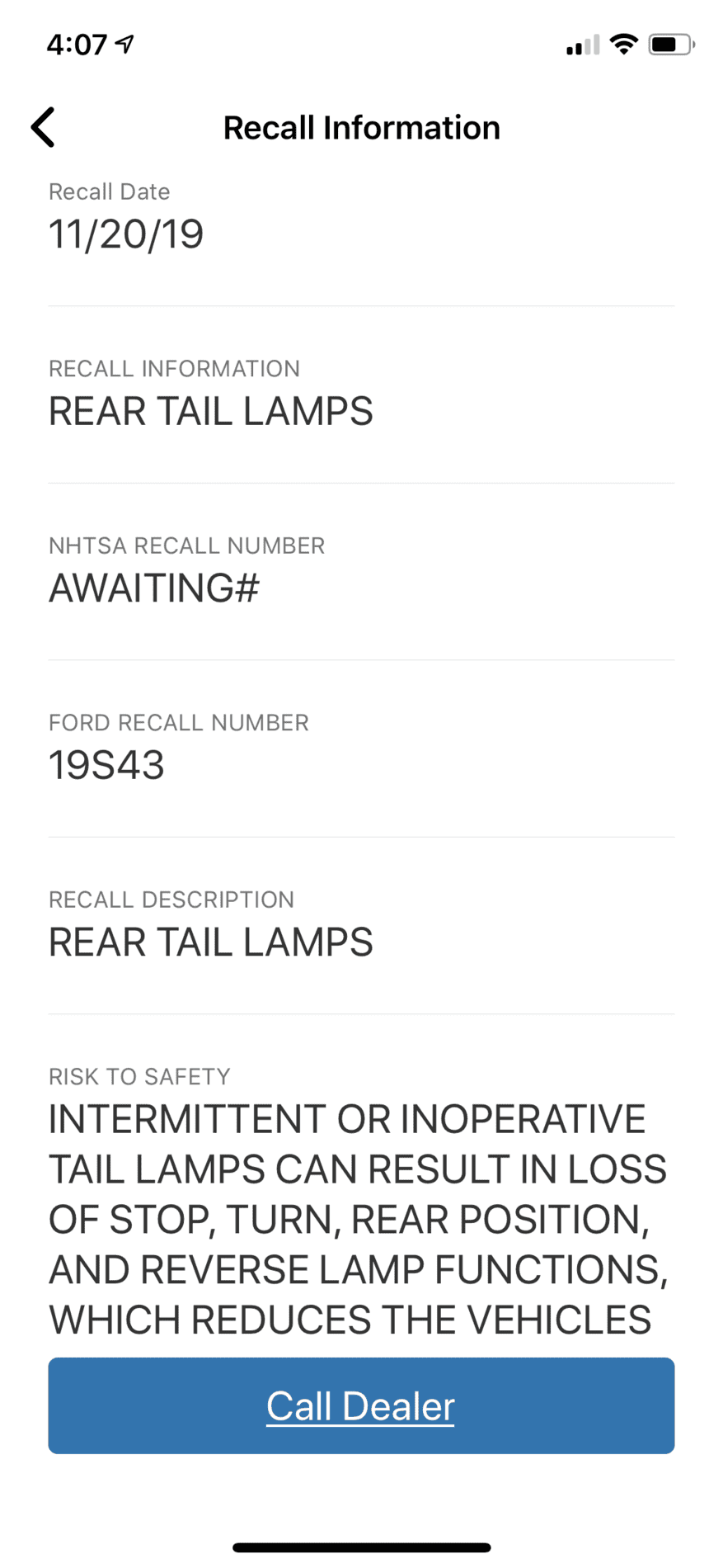

Just saw the recall notice today when I used Ford Pass to auto start the truck. Guess I will have to set up appointment with dealer. I knew this form was the place to go before doing that. Thanks everyone.

Got the recall notice too.
