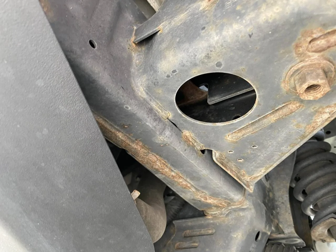

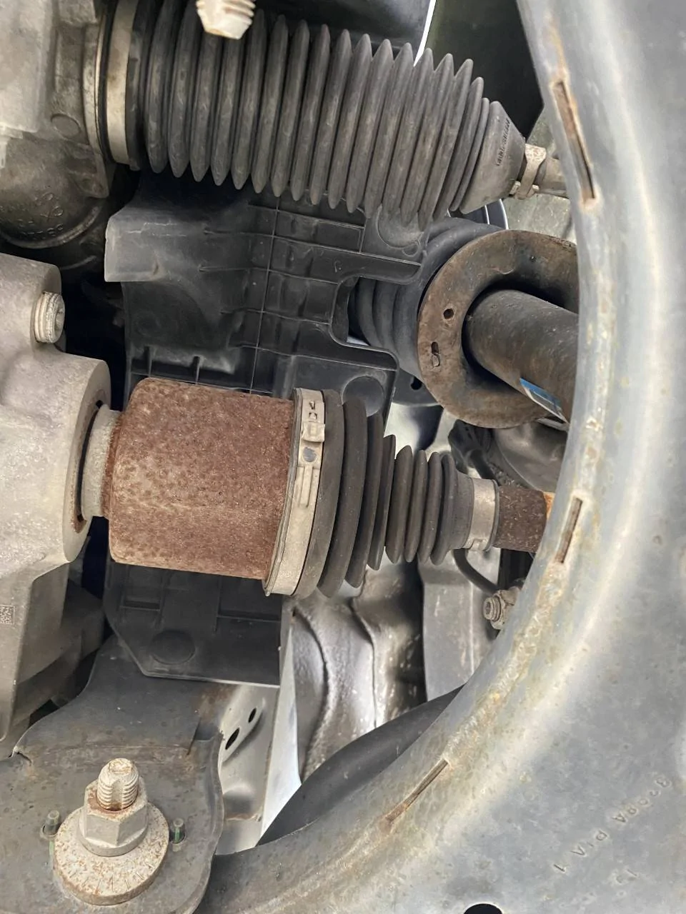

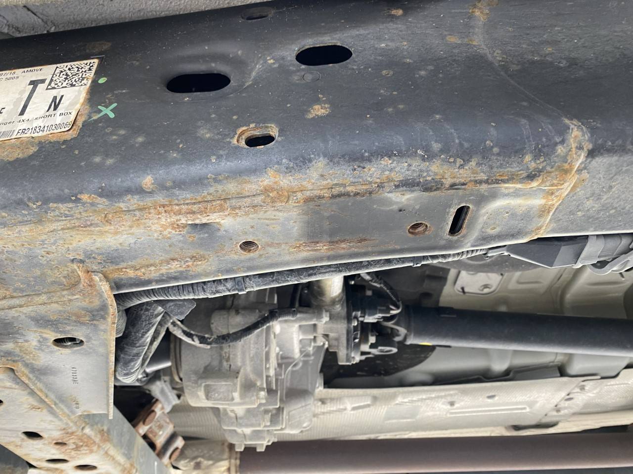

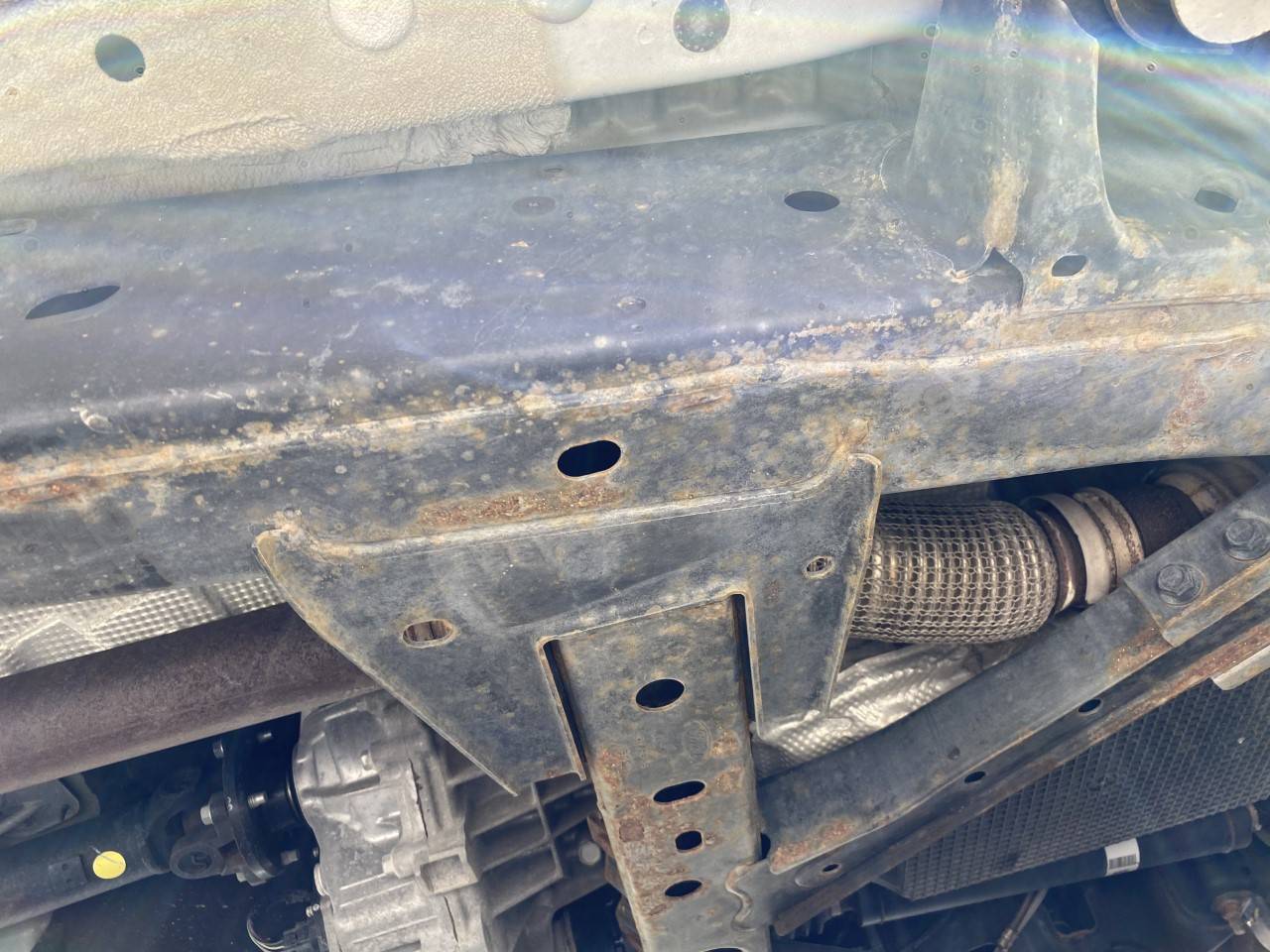

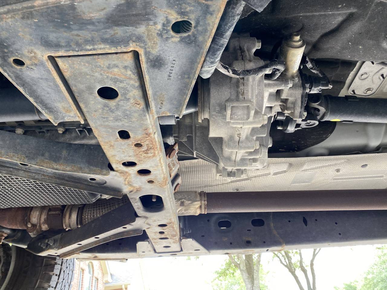

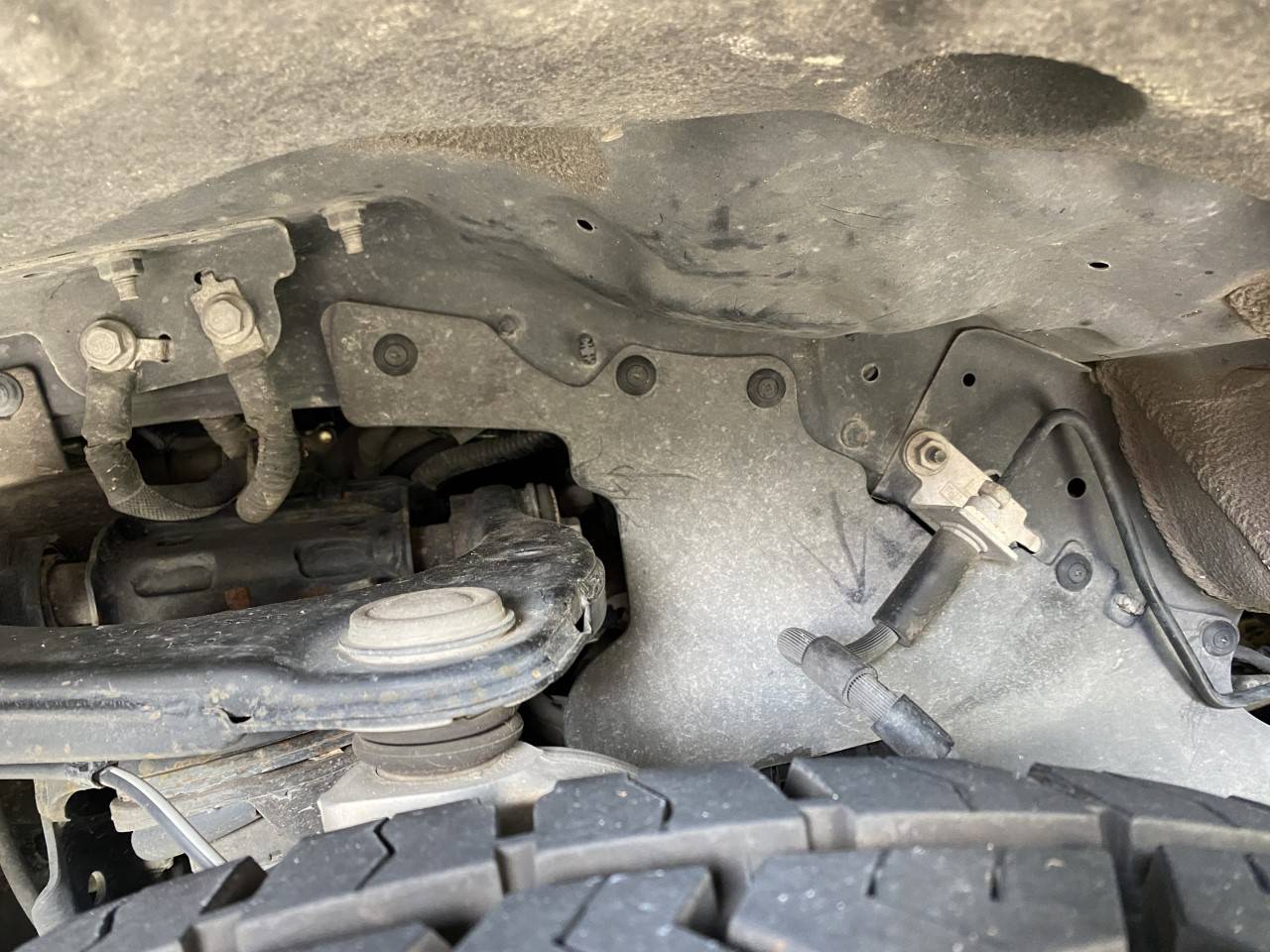

Similar results from the Gulf Coast with many trips to the beaches of the Texas Gulf Coast and direct exposure to salt water. Meaning driving through some salt water to get to the good fishing spots.
The MI road salt appears to be a little bit worse in causing rust.

Learned this from my grandfather an old Navy officer. They would wire brush the rust spots then treat it with naval jelly. (You can buy it still today) let it sit and then wash it off. This has two effects. First is it neutralizes the surface rust. Then what it does at the same time is passivate the base metal. (Lifts off free iron)This will keep the rust or oxidation process to start again. Then paint it with something like POR15 for additional protection. Shouldn’t see rust in that spot again for a very long time. Navy still uses this process today to keep our ship fleet from becoming rust buckets.
