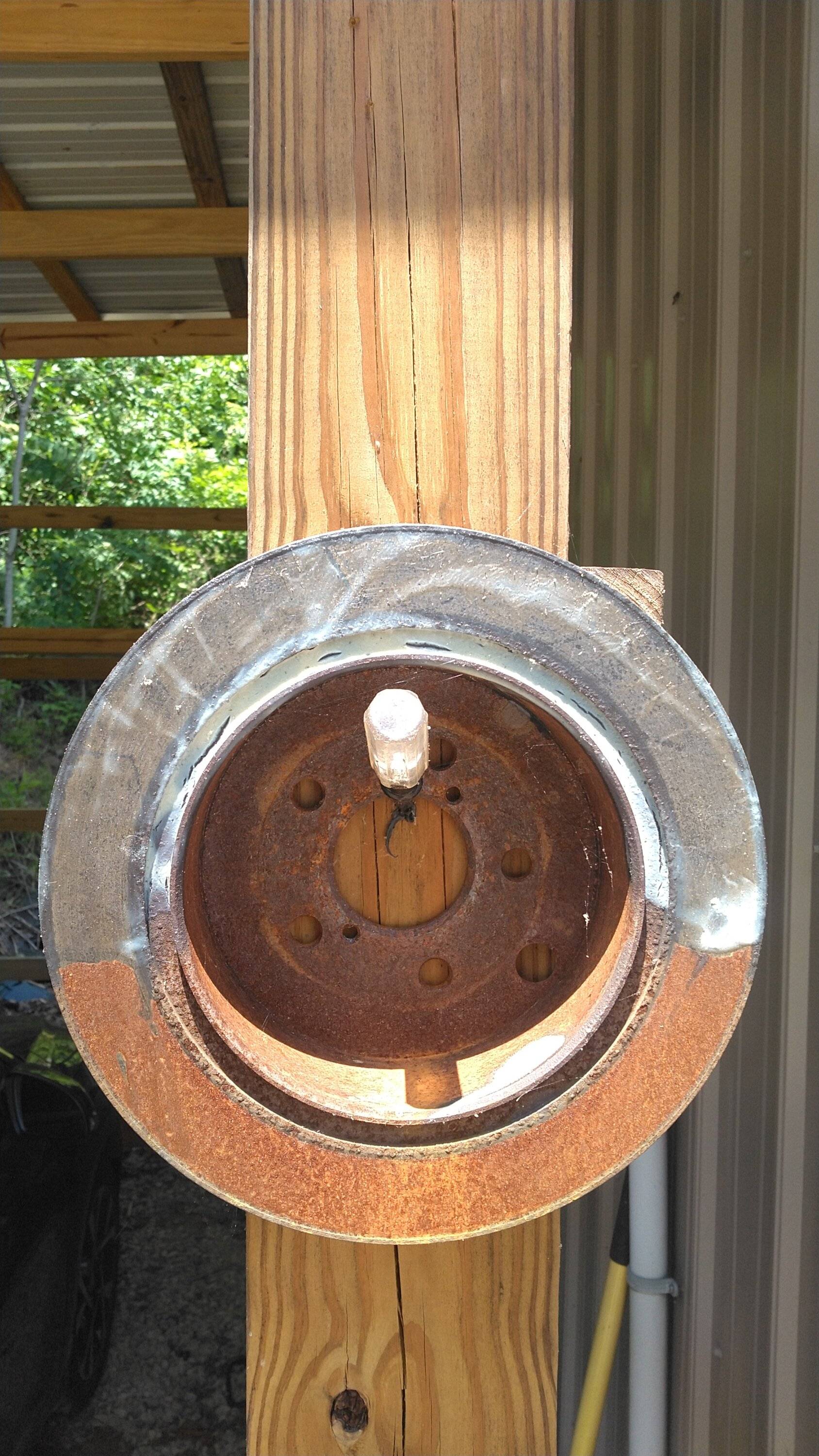

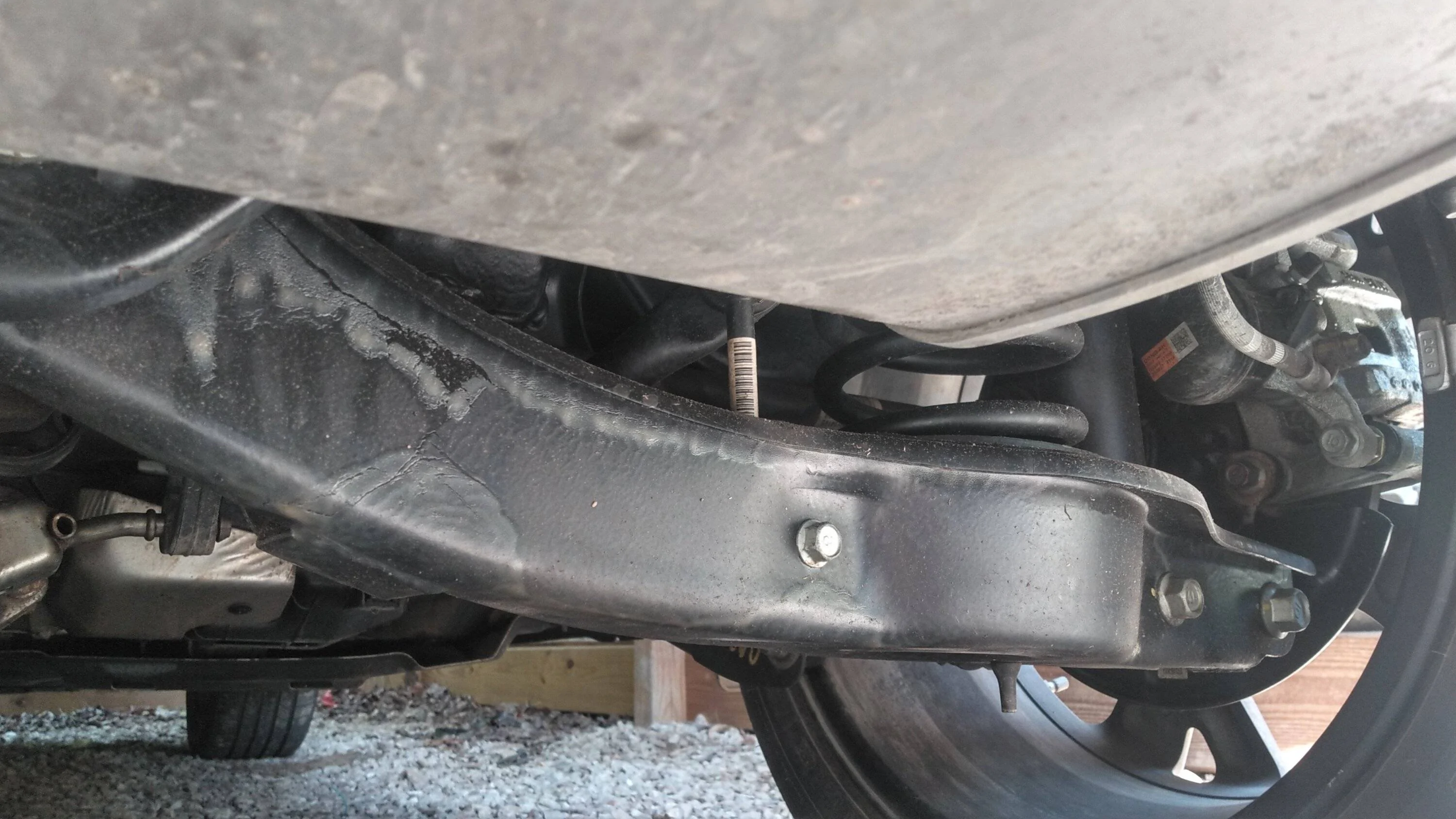

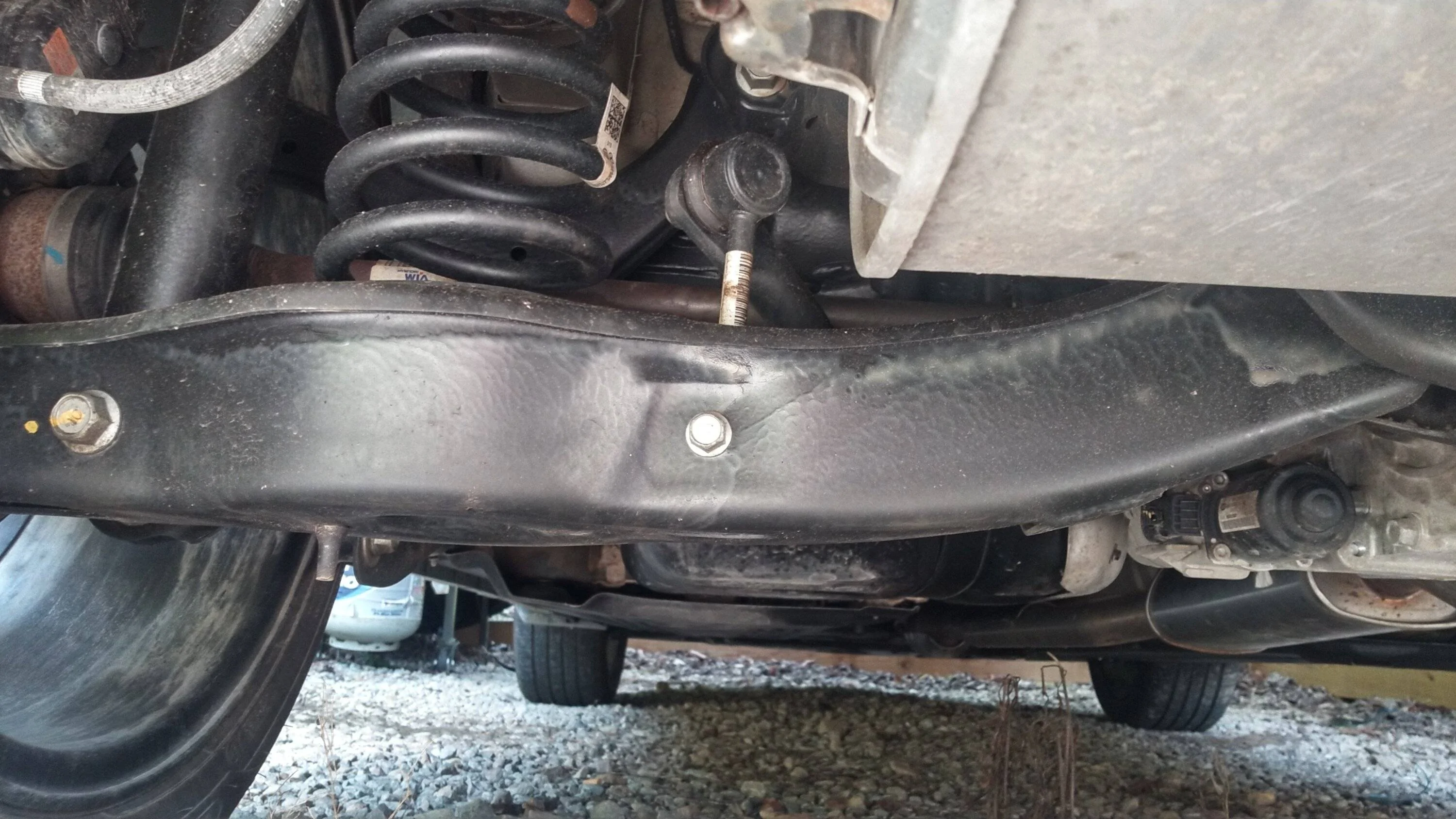

I'll add a update pic of rotor. After all the rain in Ohio. Also a couple pics of wife's car that I did really quick before vacation 4 weeks ago. I put hers on pretty heavy. You can see a couple of thick spot. Rust won't be there, that my main concern.
