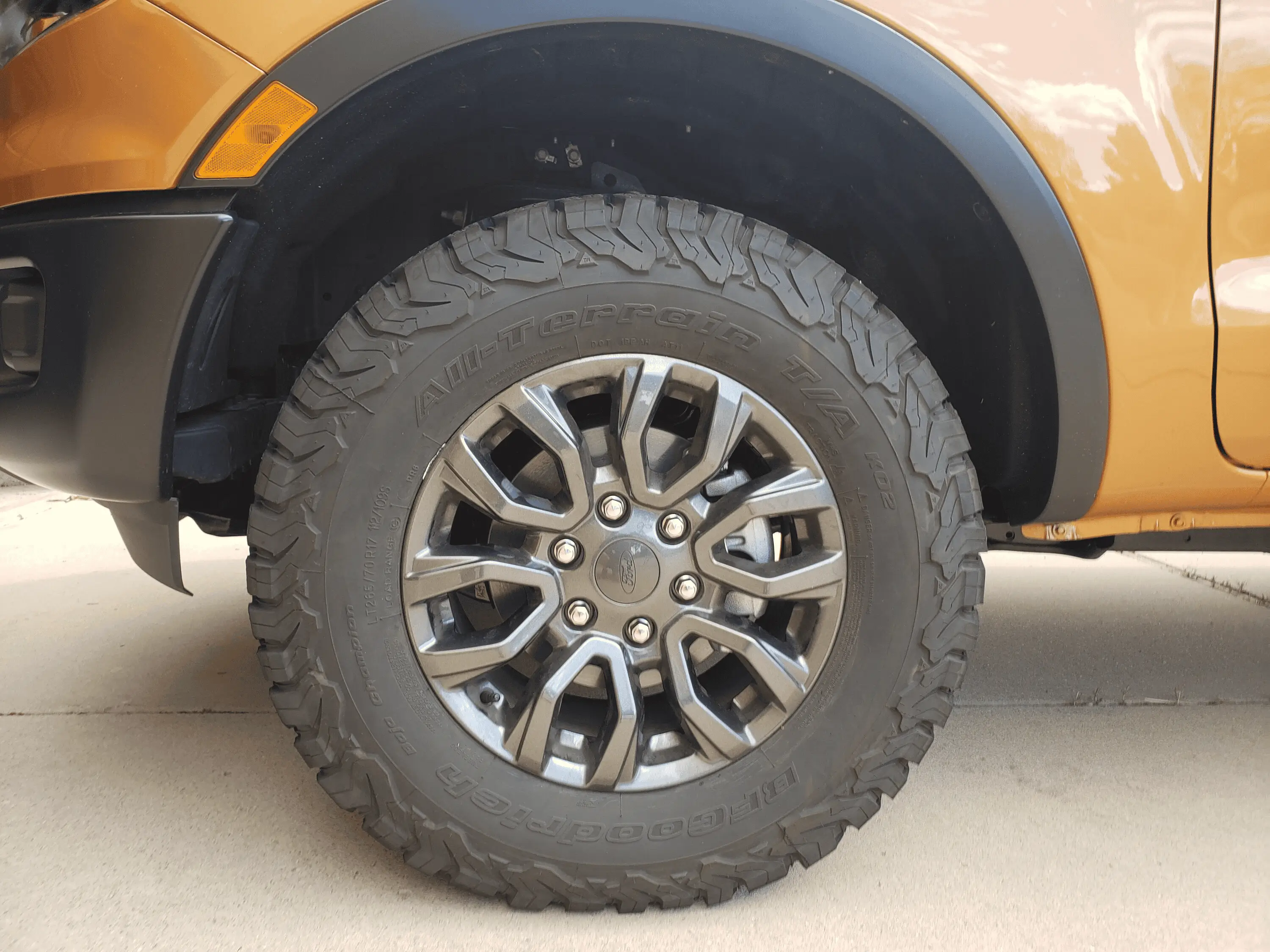

My truck came originally with Bridgestone Dueler 255/65/R17 AT's and they were not bad at all. I upgraded to Ford OEM charcoals with BFG K02's 265/70/17 AT's and these are smoother riding than the Bridgestone's...probably because of the larger size. The ideal ride is at 36 psi cold. This was also the recommendation that BFG gave me. I have the pressures checked once a month at Discount and have them to adjust it so they will come out to about 36 psi when cold. The TPMS runs about 2 psi lower that the actual pressures in the tires. The KO2's are showing very little wear and most of the reviews indicate a long wear cycle. They handle perfectly in every situation with the stock suspension and are very quiet and smooth riding for AT's.

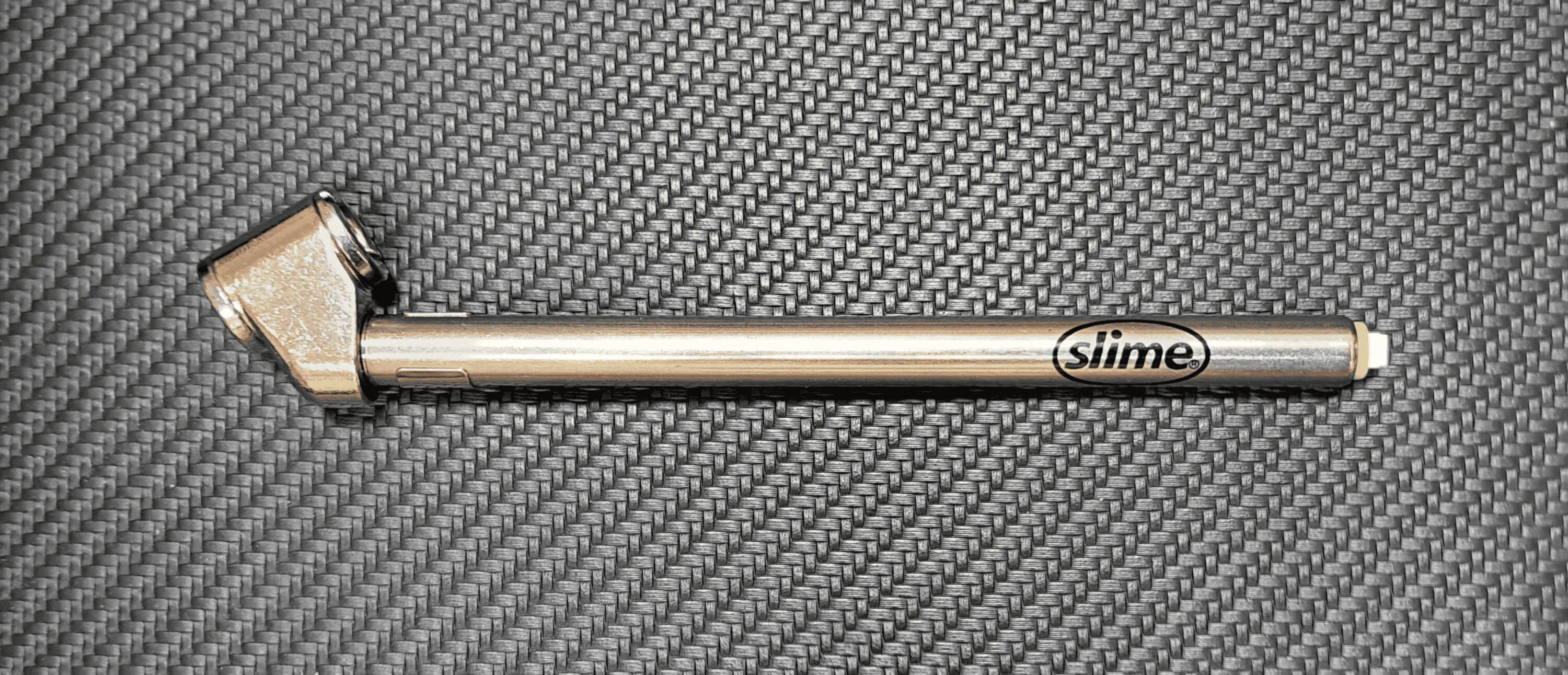

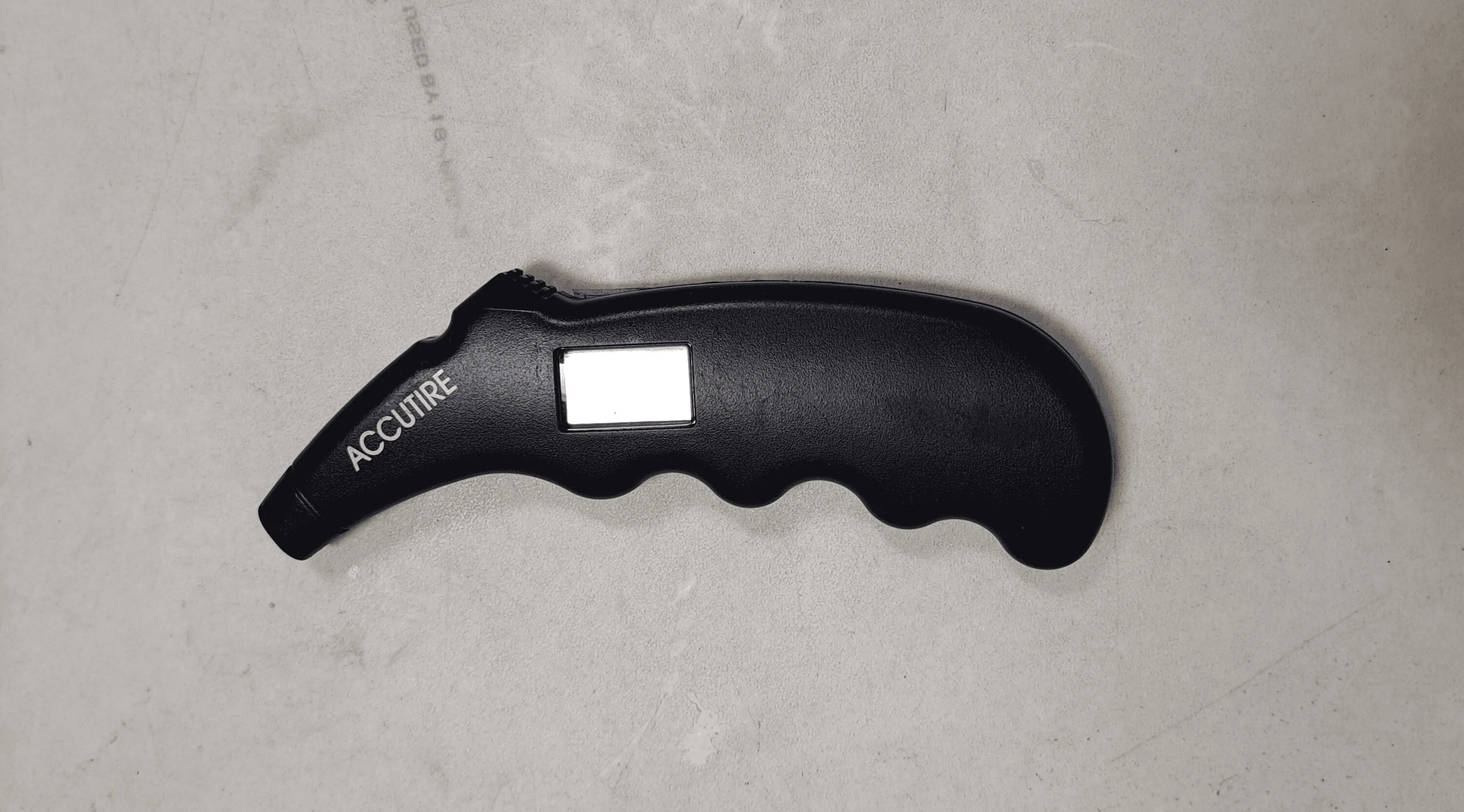

Brian,
I got this Slime tire pressure gauge and tested the accuracy at a Discount Tire pressure check. Their reading was 36 and the Slime reading was exactly 36. My Accutire guage tested at 35.5 with the Slime at 36. Use this guage for my truck and Mtn. bike. Carry it on the bike because it is small and lightweight. Also have a built-in gauge in my bike tire pump to compare it with.
Amazon.com: Slime 2016-A Dual-Head Pencil Tire Gauge with Bonus Valve Extensions, 10-120 PSI : Automotive

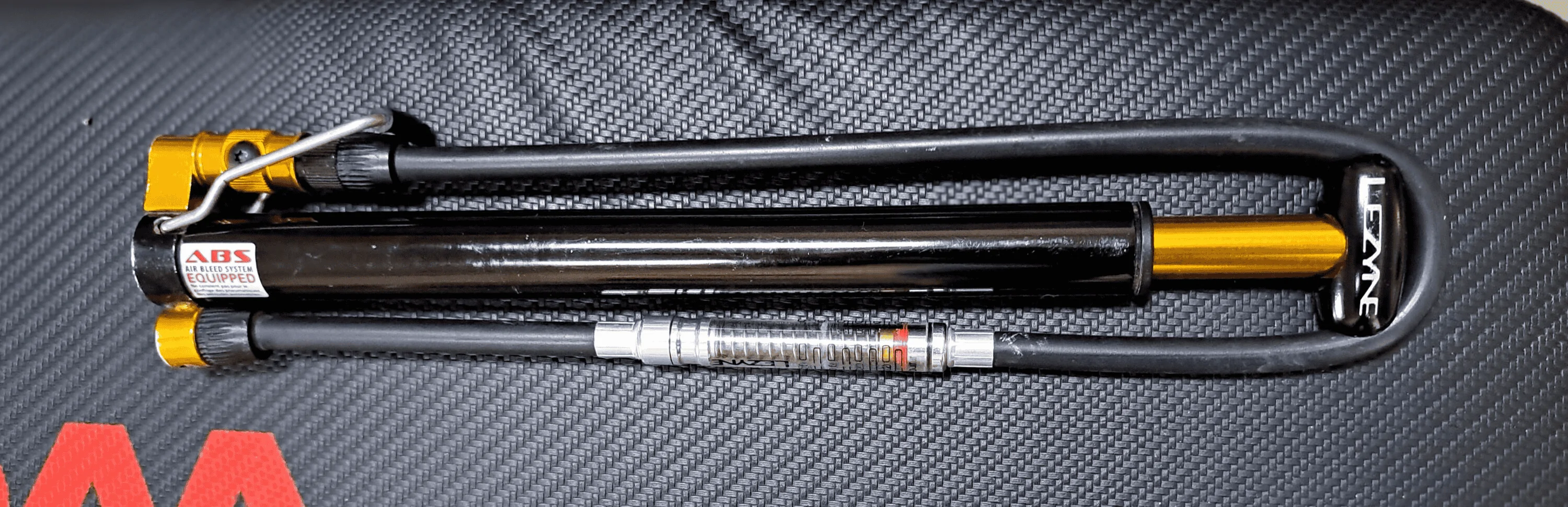

Thanks Paul! Think I'll head over and order one! Thanks for the link!
