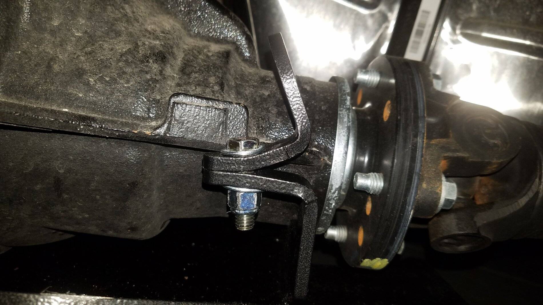

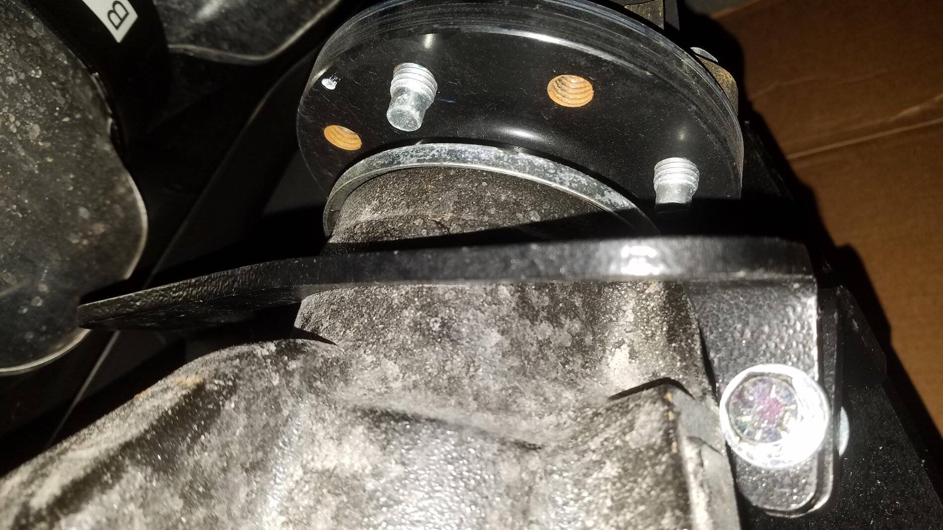

In trying to install this as well, I'm seeing some concerning behavior from the front top bracket.
The instructions say to torque front two bolts (that hold the top bracket in place) to 130 ft-lb. This is a large torque.
I'm only at 50 ft-lb, and the top entire bracket assembly is distorted. It's been a constant 50 ft-lb now for quite a few turns, but the assembly just continues to distort; no increase in torque. This doesn't seem right, given how far from the 130 ft-lb I'm at.
Is this an error in the documentation? Design error? Working as expected? If the latter, why is the bracket distorting so significantly?
I'm concerned that this will harm the diff somehow (especially the bearing, eg crack the iron), or the plate.
The top bracket used to be straight, now it's bent in the middle
The bottom mating surface (of the top bracket half), used to be straight. Now it's bent quite a bit. Similarly, the bottom mating surface used to be flat, and is also starting to bend a bit.
Again, I'm only at 50 ft-lb, and the target is 130...
Also important to note this was not designed for the Ranger, so you have to take instructions with a grain of salt. The bracket is distorting because it isn't made for our axle, and the JL most likely has a slightly different height (shorter) than our housing. I found with spacers or a stack of washers, the bracket fits really well.
I pulled up the instructions and torque spec for that 3/8 bolt is 30 ft lbs not 130. Using a 9/16 socket is not a 9/16 bolt... The did write it in a confusing way.

Ah :( That is indeed written a bit confusingly.
I will have to order another top bracket from rough country -- this one is surely ruined, and the torque specs no longer apply.
