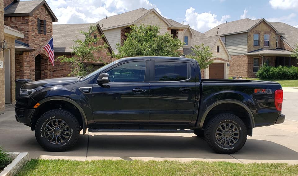

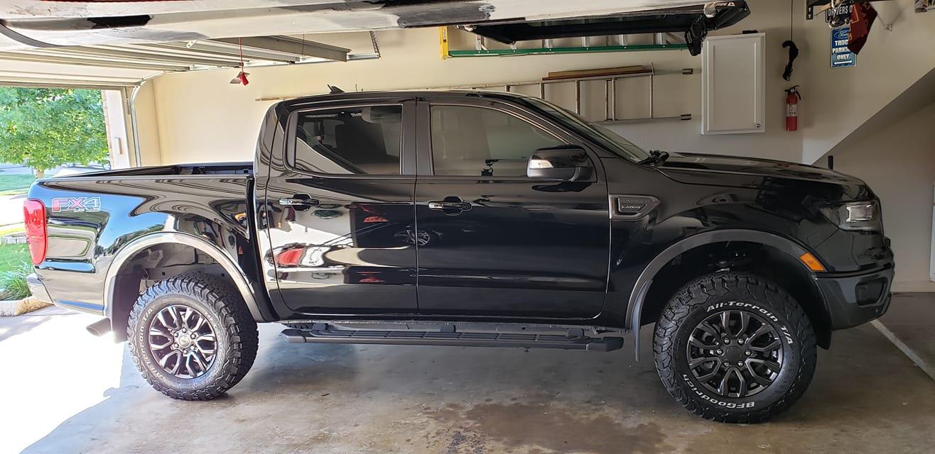

My 2019 XLT 4x2 with the RC 2.5” Leveling kit. Looks way better.
Looks really good! I think you'll like the ride better too,it's a little stiffer in the front now. I can't remember but are you going to get new tires?

Thanks. I think it looks way better. I understand why they build some rake in to the system but boy do they overdo it.
Not planning on tires right away but when I do I'll go a little bigger and probably stay with the stock wheels. That plan is subject to change though. I have mud guards ordered and that will do it for the mods for a while. I may even get the FPP Tune. We'll see.......
137,150
They sure over-do the rake! I went 1 size larger on tires 265/70/17 on the stock sport wheels so there's no rubbing issues and you don't need to modify the crash bars. They also don't kill you mpg's going 1 size up,maybe 1-2 miles city and a little more on the highway. I'm still averaging right around 21 mpg.

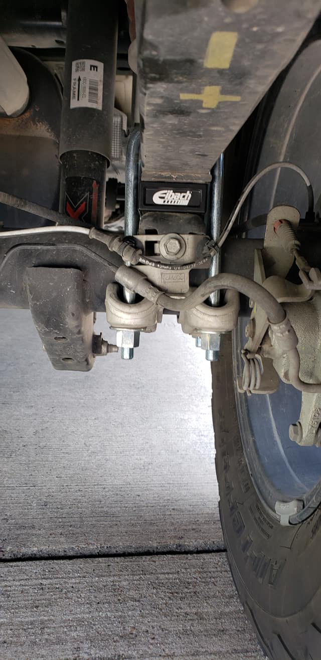

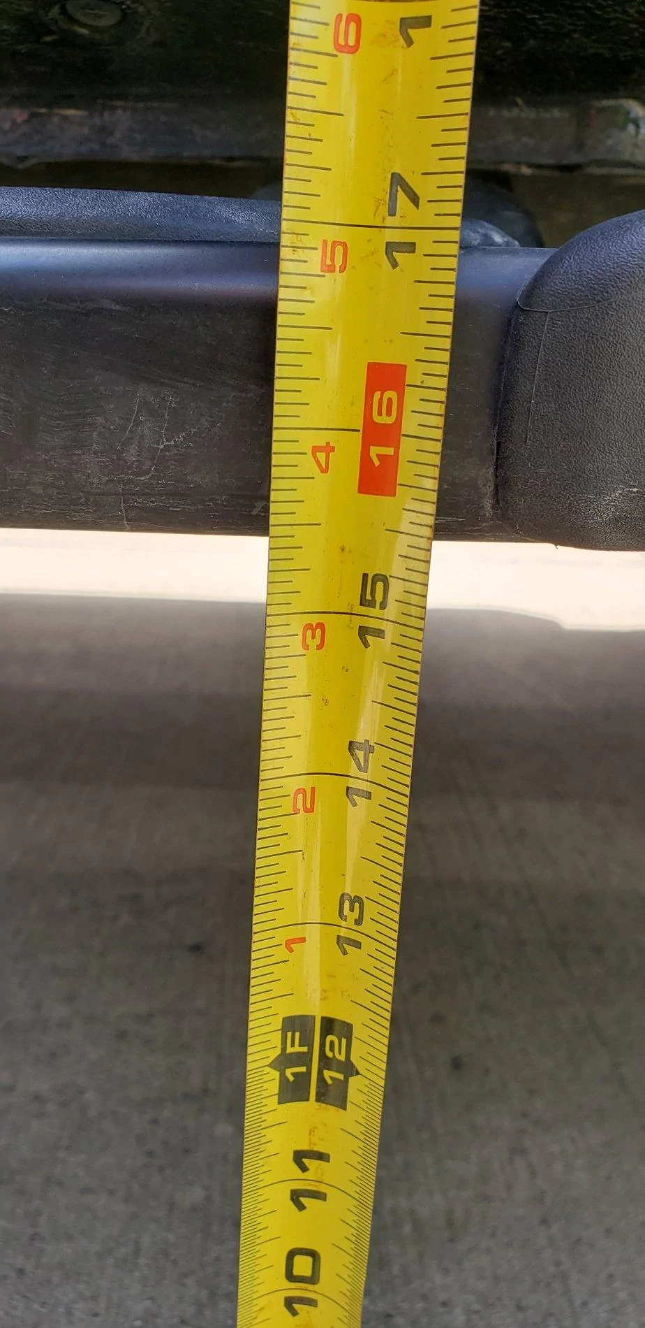

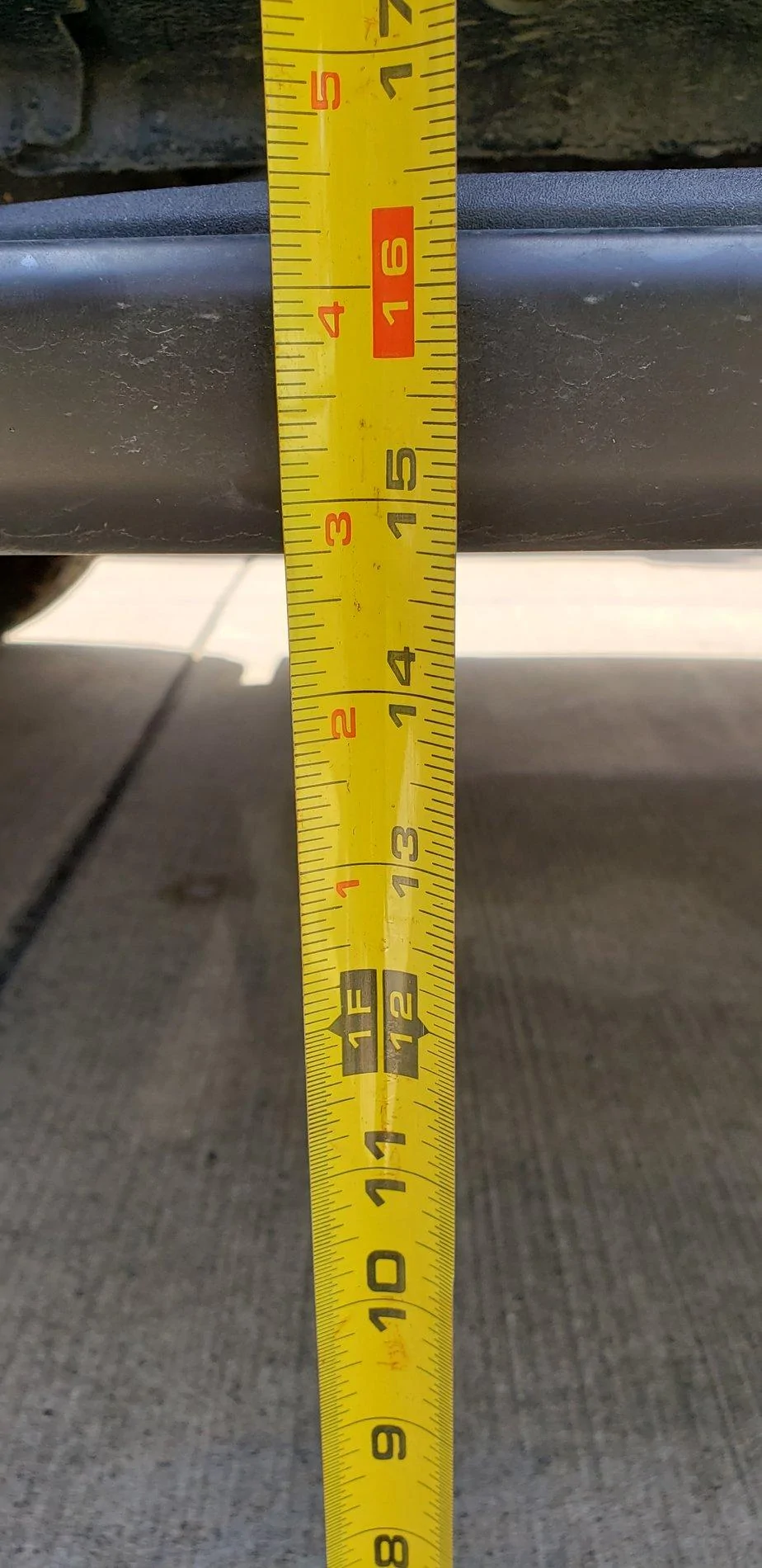

I posted this in another thread, but here is my 2.5" Rough Country Lift Kit with 1" Eibach rear lift blocks.

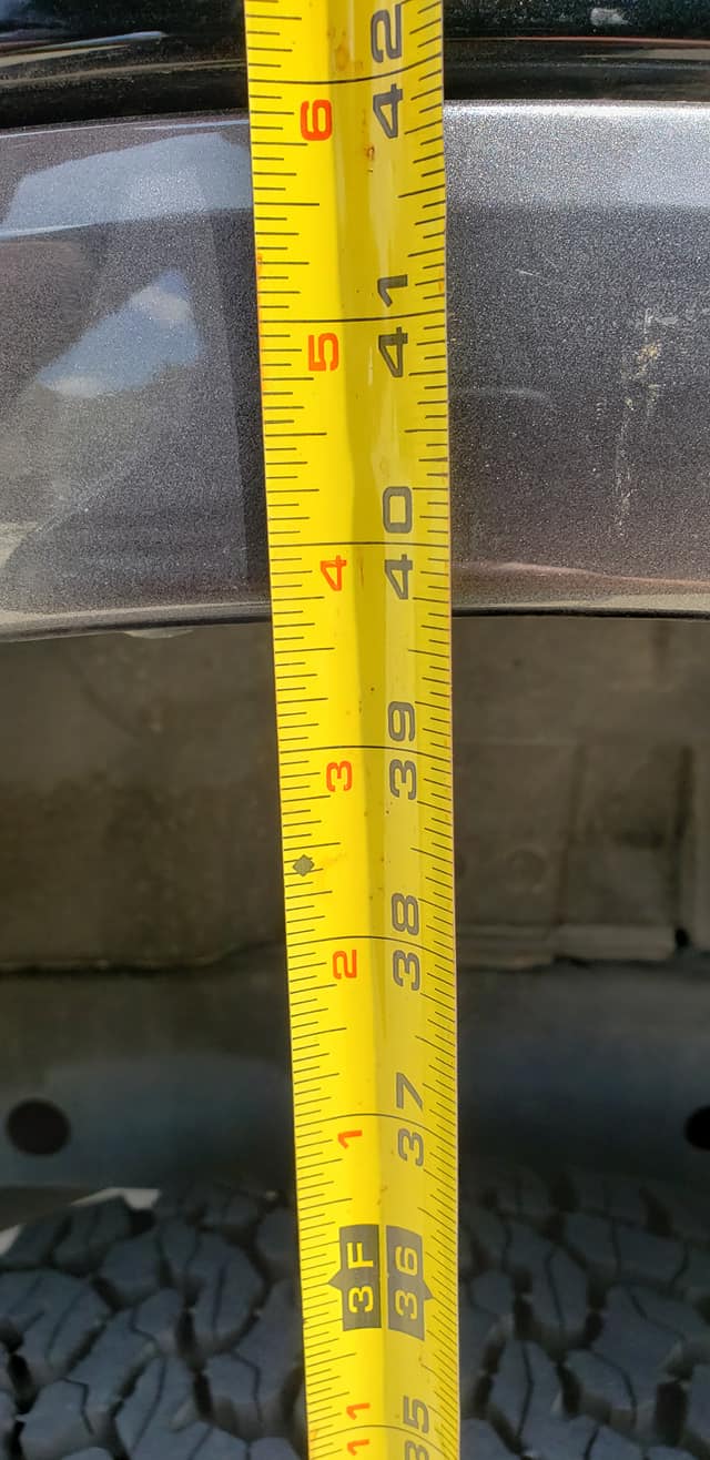

Also... In case some of you were wondering here is the measurements from the bottom of the side steps.
