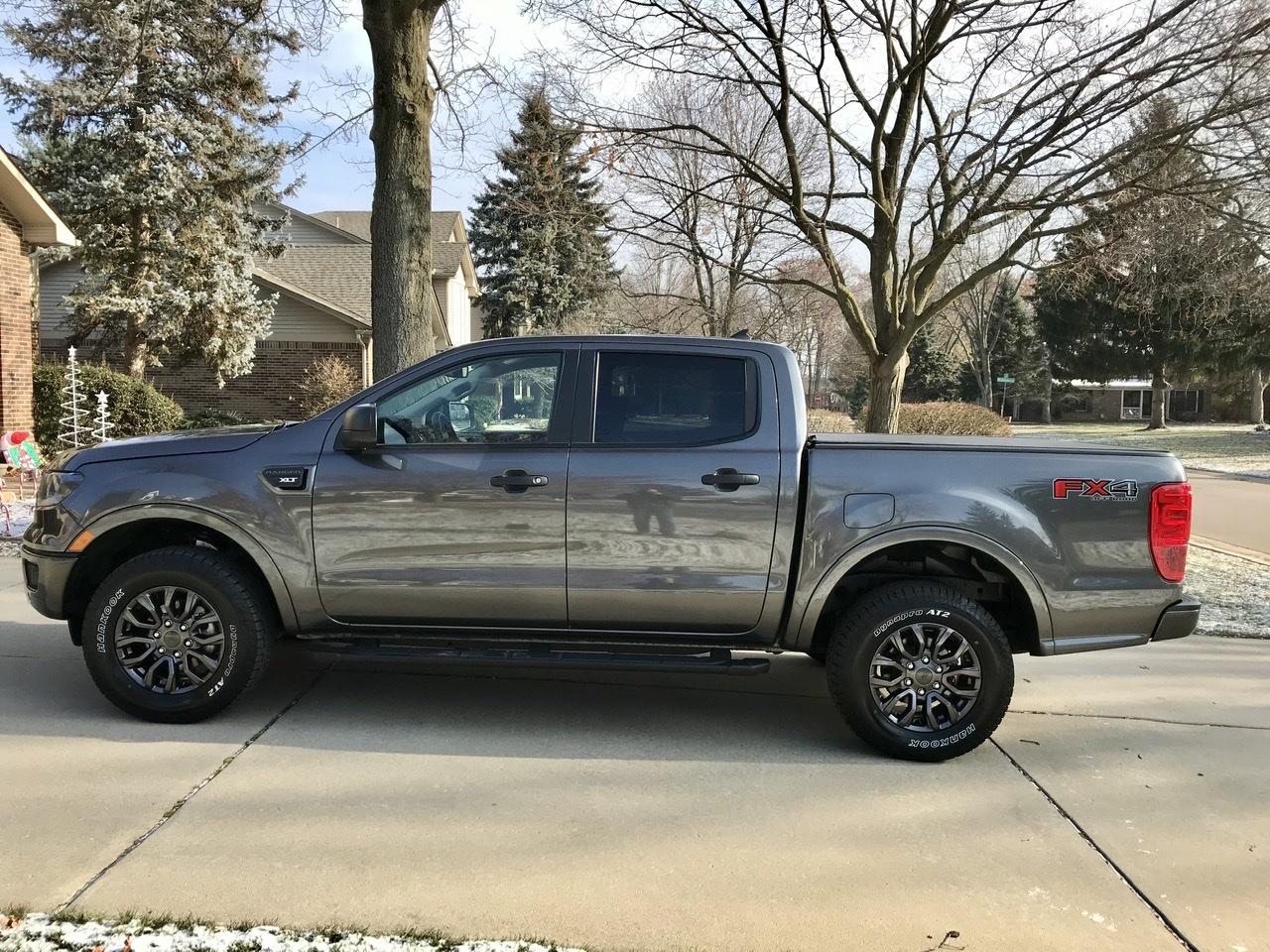

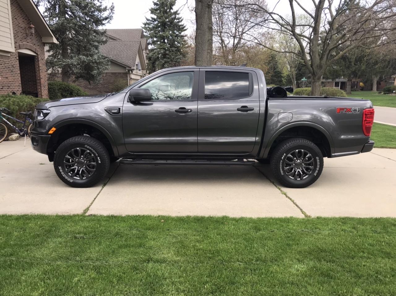

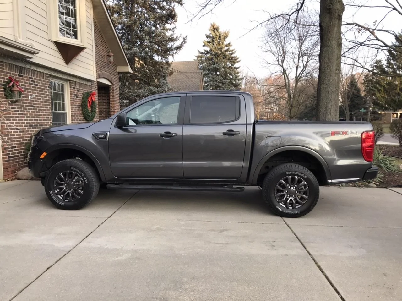

Here is stock, ReadyLift 2 inch, and Rough Country 2.5 inch pictures.
I was initially happy with the ReadyLift and as I’ve said before it gave me no more than 1.5 inches, leaving a full 1 inch rake. Everytime I’d look at it on flat ground I wished for another .5 inch minimum.
Pictures are sometimes deceiving as the angle plays a big role in the look.
The Rough Country gave me a full 2.5 inches and I am now within a 1/4 inch of level - I have to believe a 3 inch kit would make the front higher than the rear - at least on mine it would.
Ugh - couldnt get the pics in the right order - top=RC, middle=stock, bottom=ReadyLift

Great! Thanks for these pics. I agree that angle of the pics makes a difference but I think I now prefer the 2.5 inch kit. Has been hard to see different trucks with different kits but thanks to you I can now look at the same truck and compare. Definitely helpful. :thumbsup:

I think the 2.5" is the perfect one. It leaves you just enough rake so if you do haul a heavy load it should still be level and won't leave the front end to high.

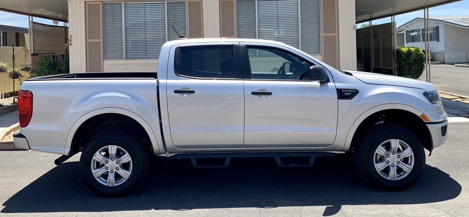

My 2019 XLT 4x2 with the RC 2.5” Leveling kit. Looks way better.
