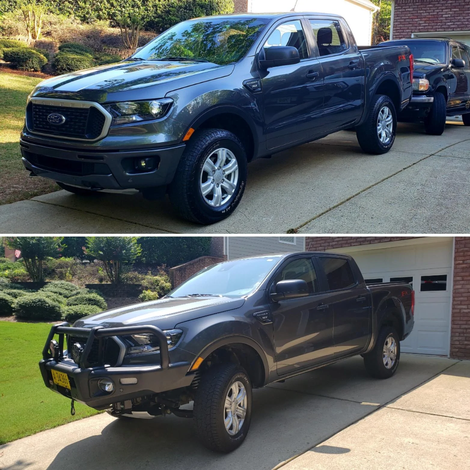

You can set it to 3" and have it straight level across. I'd set it just one under.
Here's mine set at 3.75" but with a bumper and winch.
