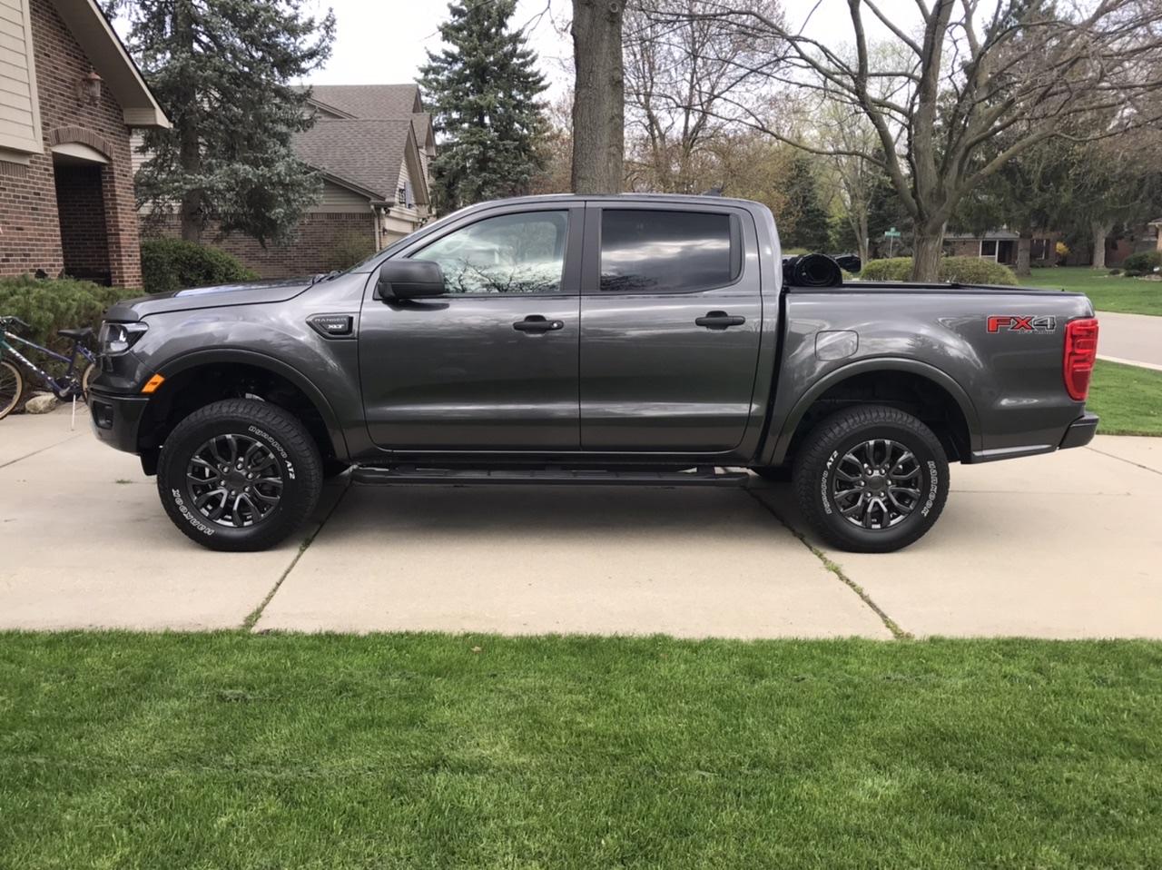

Ok. Success. RC 2.5 is installed....not without a bit of CV drama though. Even with removing the axle nut and freeing up the axle it still came out on the drivers side for both removal and reinstall......both times took 15-20 minutes to finally pop it back in....I was actually a bit worried during the reinstall.
This is a tough job for one person and I would recommend having a buddy help out if you are doing it.
I changed from a ReadyLift 2 inch kit - which I did by removing the LCA’s - that only gave me 1.5 inches. This RC gave me a true 2.5 inches and I am within 1/4 of level. Much happier with it. Still gotta get and alignment in the next week or so.
