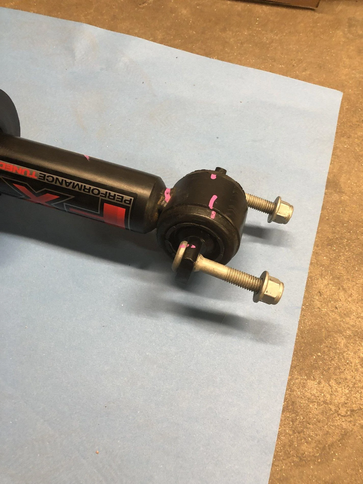

The Australian rangers have a single through bolt on the bottom of the strut, ours has 2 splined studs; see pic. I don’t think we can do it without removing everything. Correct me if I’m wrong but there won’t be enough clearance to remove the strut with just the tie rod disconnected.
The idea here is to NOT remove the tie rod, but to actually remove the two bolts that hold the lower control arm to the sub frame. The one through bolt vs two splined studs shouldn't make a difference in getting the shock out, but I guess we won't know till someone tries.

2019 Lightning Blue XLT FX4/ 2023 Subaru Forester
When I was doing mine I considered removing the lower control arm, I decided I didnt want to go that route, it actually seemed like it might have been more of a hassle.

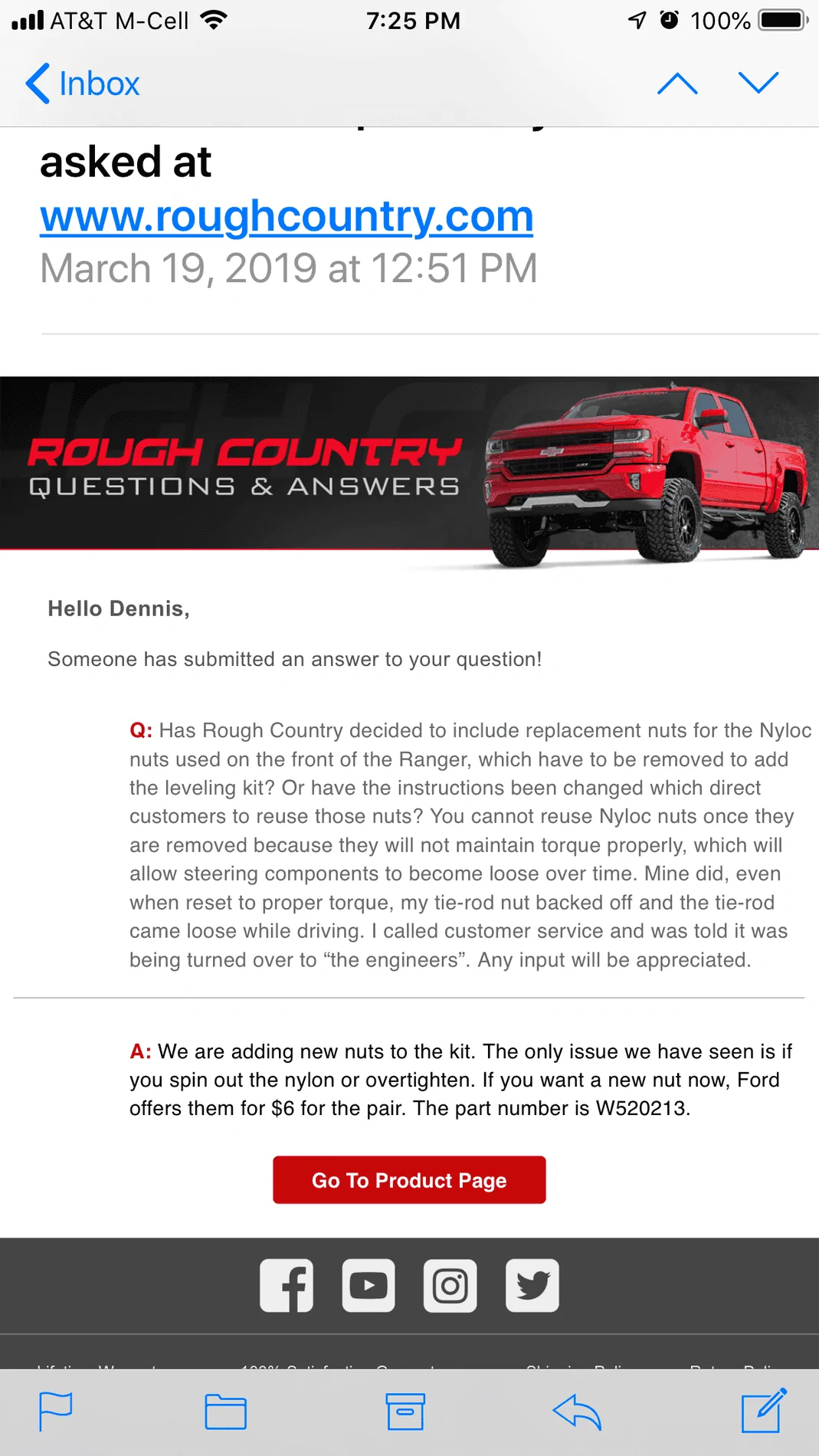

Wanted to update folks since I opened this can of worms.
I never heard back from Rough Country about whether they were addressing the issue so I called back and the guy on the phone again said it was turned over to the engineers and they weren’t aware I wanted a call back. I told them I did, because this seemed like a big issue.
So I waited another few days and never heard back so I posted a question on their website, and received this somewhat curt reply
