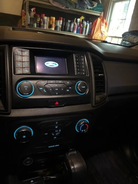

2019 Ranger Radio and Buttons not working
