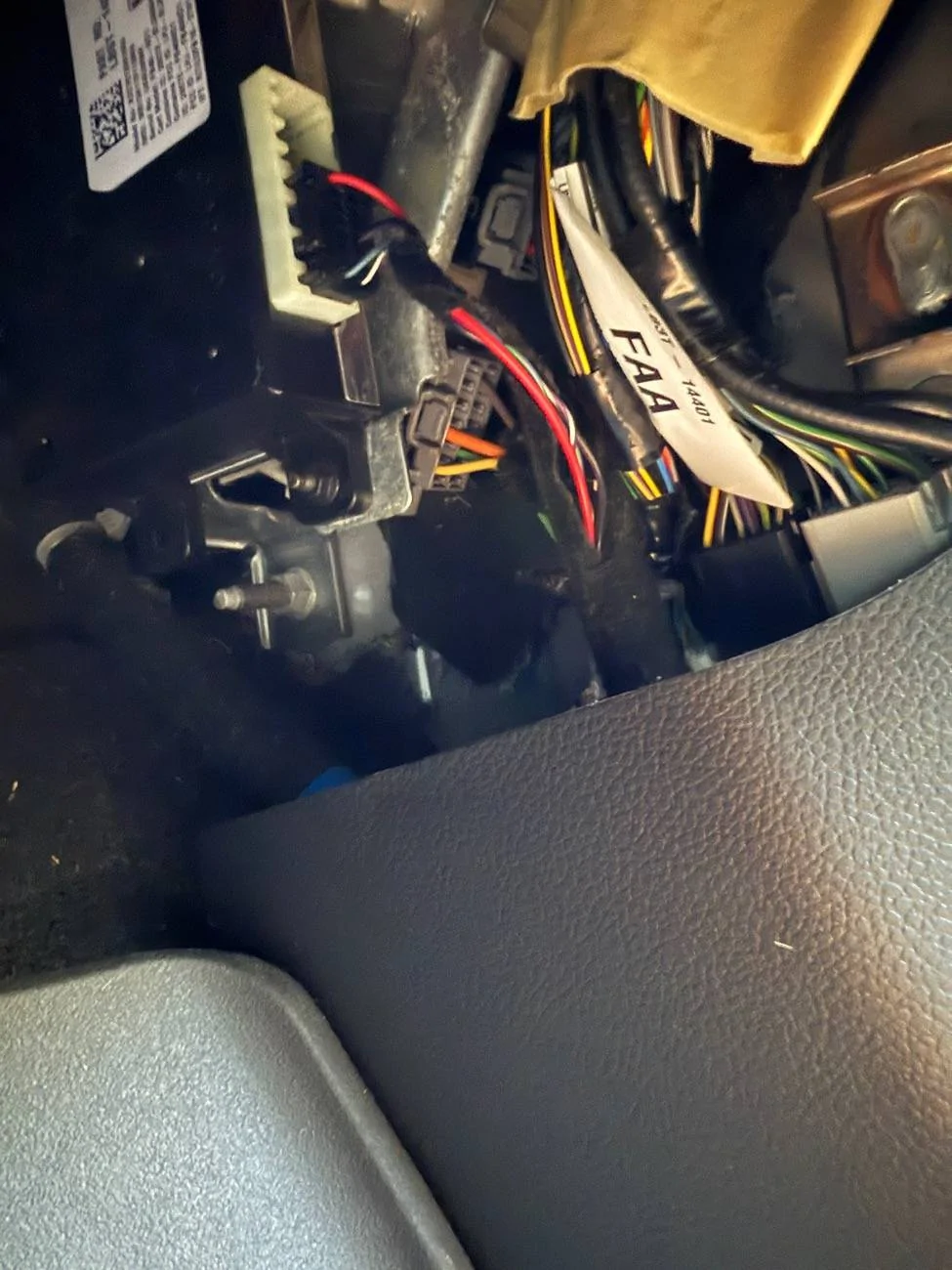

The first picture is of the DC-DC Converter Control Module. It is used for voltage stabilization to some electronic modules. It is used for the Auto Start/Stop system. It feeds voltage to the Image Processing module (for the front camera), cruise control module, 4x4 switch module, Auto Start/Stop, and rear parking aid camera.
Edit: It also feeds the FCIM and Audio Front Control Module (AFCM) so if this connector was loose, it would account for all of your symtoms.

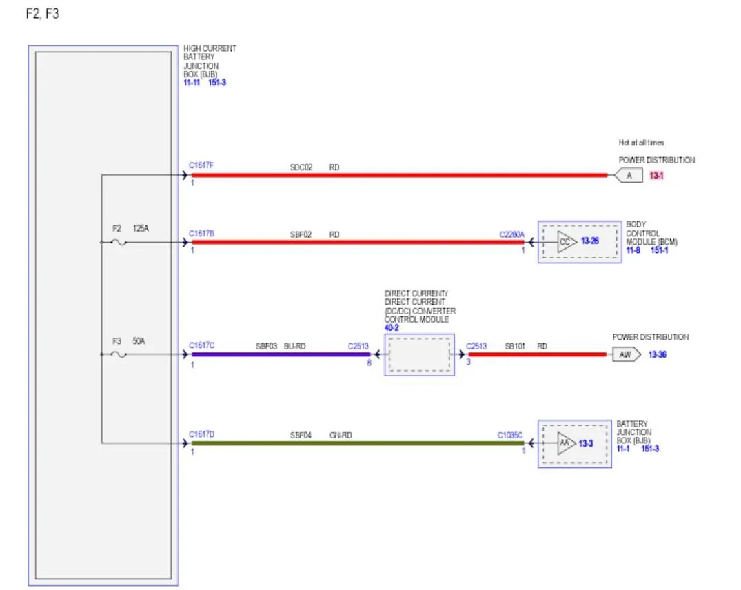

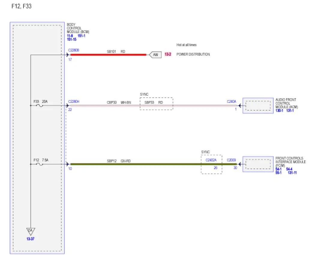

Here is the wiring diagrams for the DC/DC Converter. Notice that the DC/DC converter output (red wire SB101) (first image) feeds F33 and F12 (second image).

Good Find - In addition to the DC/DC Convertor
Mounted on the Left - In that area - BECMB - Batt Energy Cont Module (Feeds the Airbags)
Mounted on the Right - In the 2nd Pic - Is the TCU (Black Box) and under it is the TRM(Silver Box)
If the pic is the area I think it is (RH Kick Panel)
The DC/DC Convertor feeds Fuse#12 in the BCM, if it was fully disconnected you would have lost more.
I focused on the seat movement - not where their feet would be, so this brings a (NOTE) for tall passengers with long legs that can reach it - HEY DON'T DO THAT :crackup:

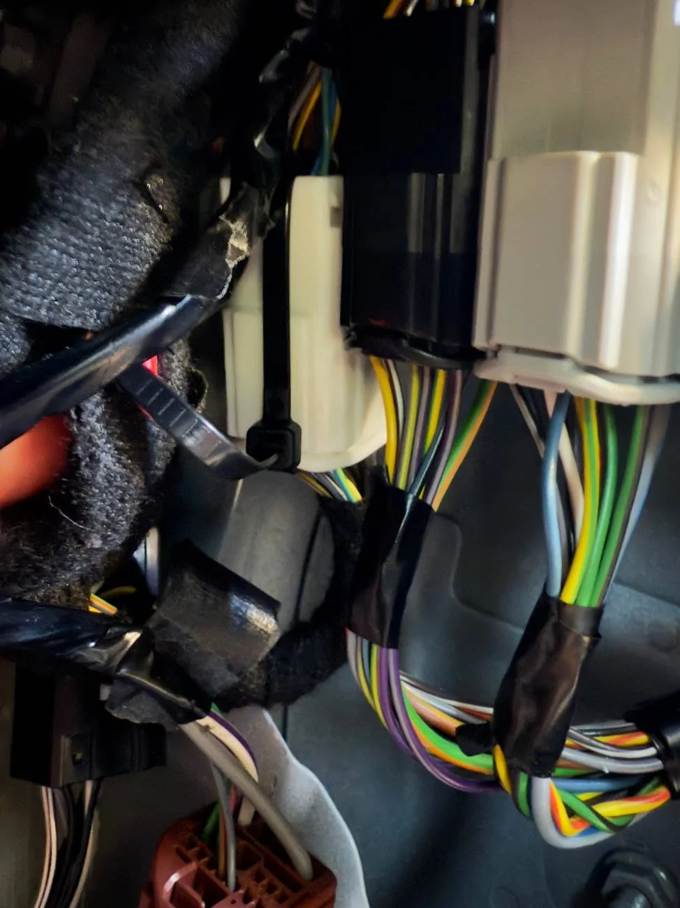

I wanted to post a final (hopefully) update to this to make sure this doesn't happen to anyone in the future. While I originally thought my previous post was the solution to the issue, my problem did come back. After looking around some more I was able to find a white wiring harness on the passenger side behind the panel on the right ride near the floorboard. I have not the slightest idea when or how this would've happened unless it was a manufacturing issue. But it appears the clip on this harness was missing/broken and the plug was barely hanging on/falling off. I disconnected, reconnected and put a zip tie around and haven't had the issue for about a week now. Hopefully this doesn't happen to anyone but if it does I hope this helps.

Damn , good find ?,! so when the passenger reclined, he must have disturbed it?
If that happened at the factory , then there is more than one out there I'm afraid...

Best that I can tell that is Connector (C211) it has some wiring for the FCIM & BECMB both of these tie into the Restraints (Airbags) as well as the FCIM panel going dead.
That panel covers the connector, so it's a mystery how it got damaged, unless someone has had it disconnected (History)
Or
Since that panel is a tight fit, the inside edge of the panel caught the connector, when someone had it off and reinstalled it.
