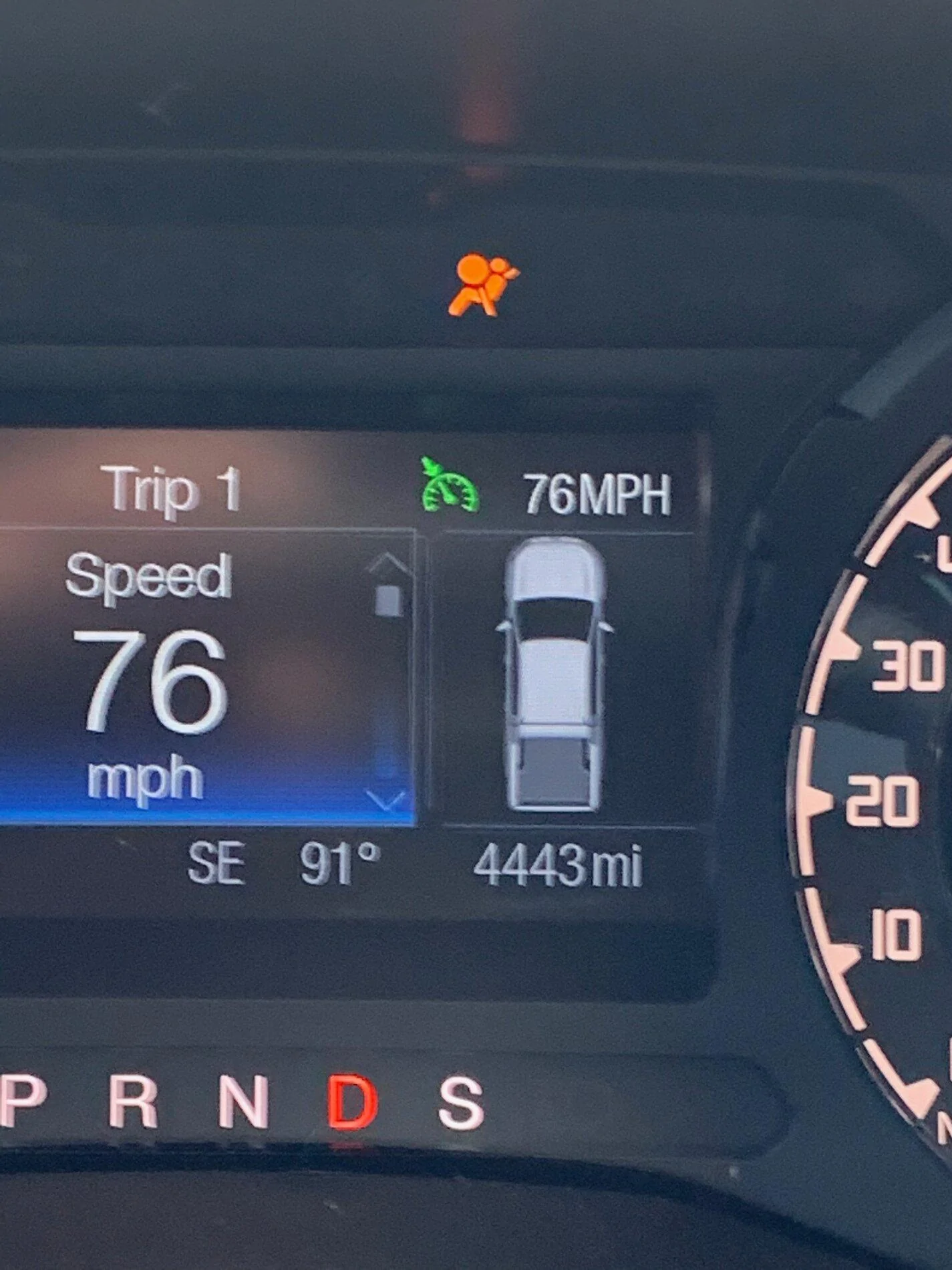

Hello,

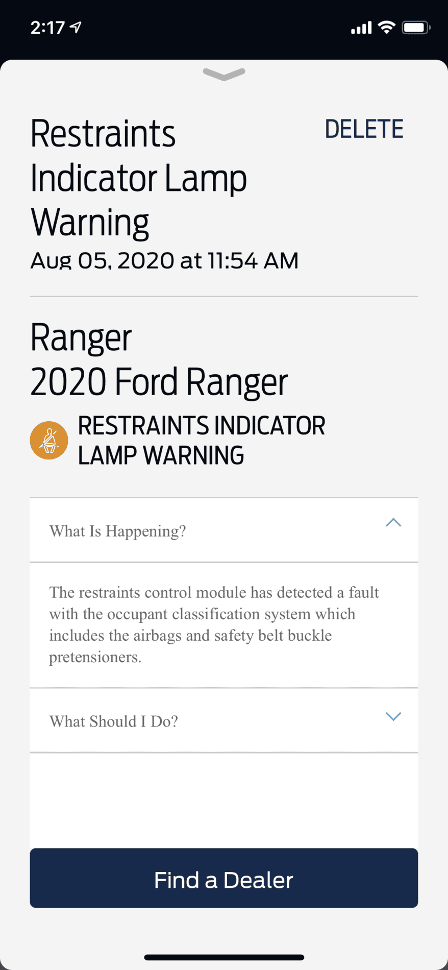

I searched the forums and didn't find anything related to the Restraints Indicator Lamp Warning. I have been getting this light on and off over the last week and notification on the ford pass App. I've had a book bag in the front seat and other items in the back seats. Never got a person not wearing a seat belt warning just straight to the light coming on.
Only code that reads is the U0422 but that seems to be from changing the tire size with my Livernois tuner.

if you take the items off the seats completely?
what happens?
Nothing changes. The items are not heavy enough to give me the seat belt warnings or anything. I was just reaching for what ifs as to the cause of the system.

Hi Shawn,
There is a wiring issue or a seat sensor defect....take it to the dealer and have it fixed. If it was your book bag and you put it on the floor it would have changes....The sensor is likely the problem in my opinion..
At the beginning of Air Bags there were so many complaints of having to belt in a sack of groceries that things have progressed to not have this kind of problem. Something is wrong....get the dealer to fix.

Closing the loop on this. Today the light was on and I stopped by Ford. It turned out to be a broken wire in the passenger seat system.

Since I had already let them check it out and couldn't find anything the first time in. I pulled up and never turned it off. They had a tech come up with the laptop and he was able to narrow it down to the passenger seat. Sorry I don't know where at he found the break, but I did notice the harness was poking out on the forward side of the seat. Without the laptop to watch real time errors your problem could be anywhere in the system.
