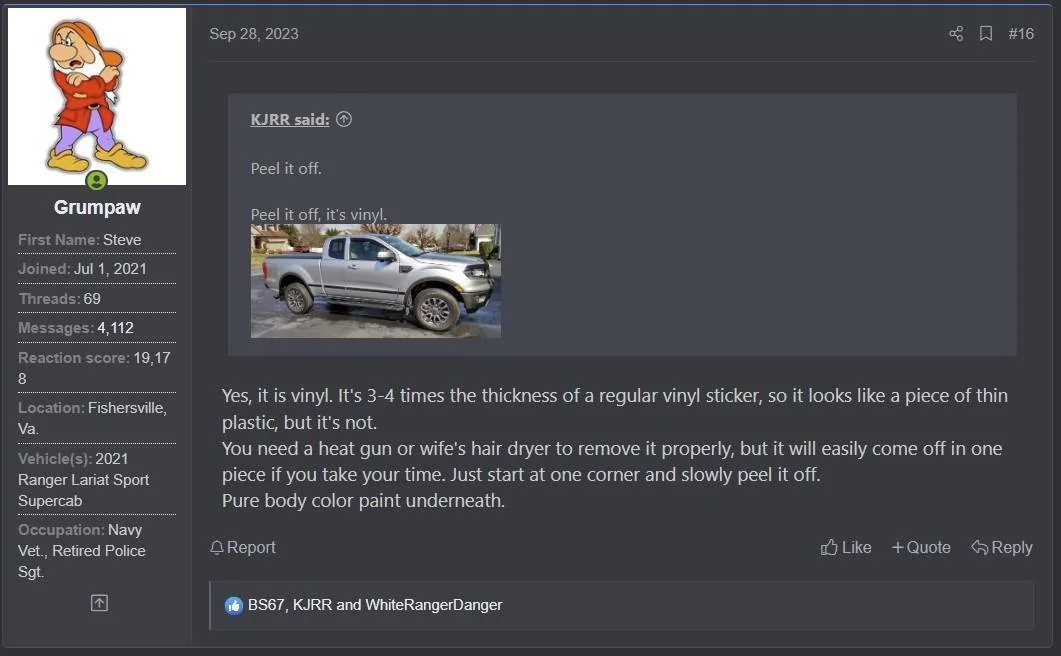

Yes, very easy to remove using a heat gun or wife's hair dryer. Low heat, start to peel it from a corner. It is a piece of vinyl, but thicker than the typical vinyl graphic material. It will stretch as you peel it off, and any residue can easily be removed with isoprel alcohol.
Fully painted, body color underneath.

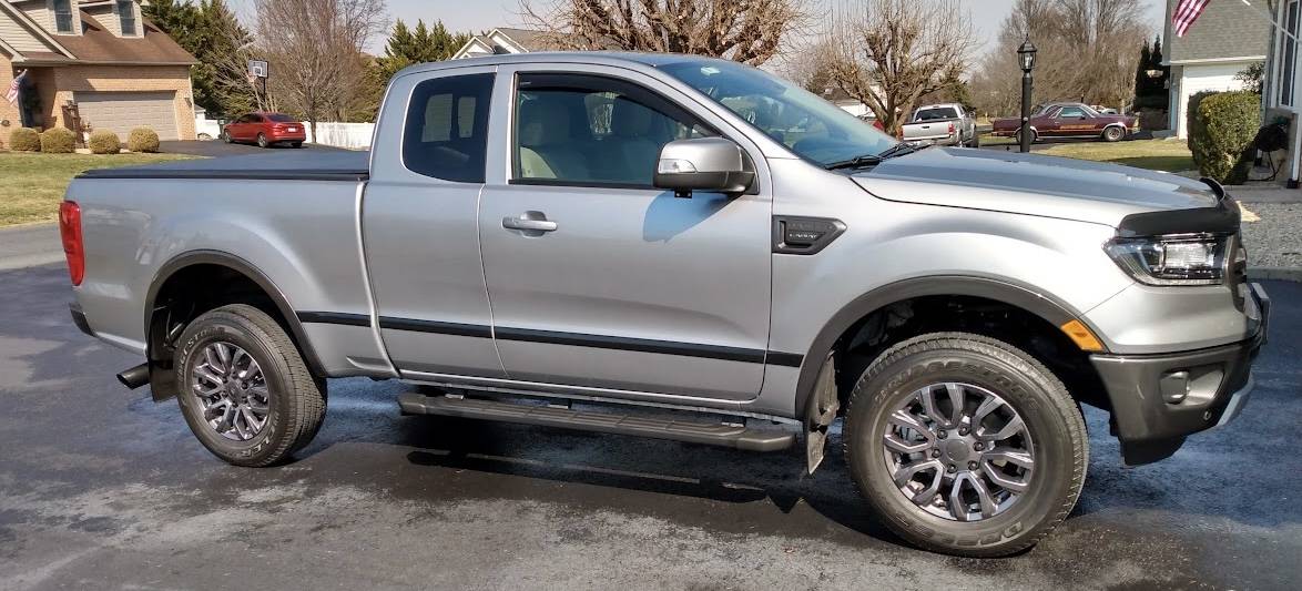

No difference in paint....remember, the entire truck is painted first and any trim/vinyl is added after paint had dried/cured. Door pillar gets the same paint as rest of the truck. Pillar is part of the entire door, and gets painted at the same time. Vinyl is added after paint.
If you go to it, just use low heat and start at a corner and slowly peel it off....use high heat and you could actually melt the vinyl. Just hold the gun around 6-8 inches away and slowly wave it back and forth as you peel it off. After a minute you'll get a "feel" for the procedure as it starts to peel.

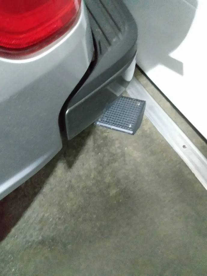

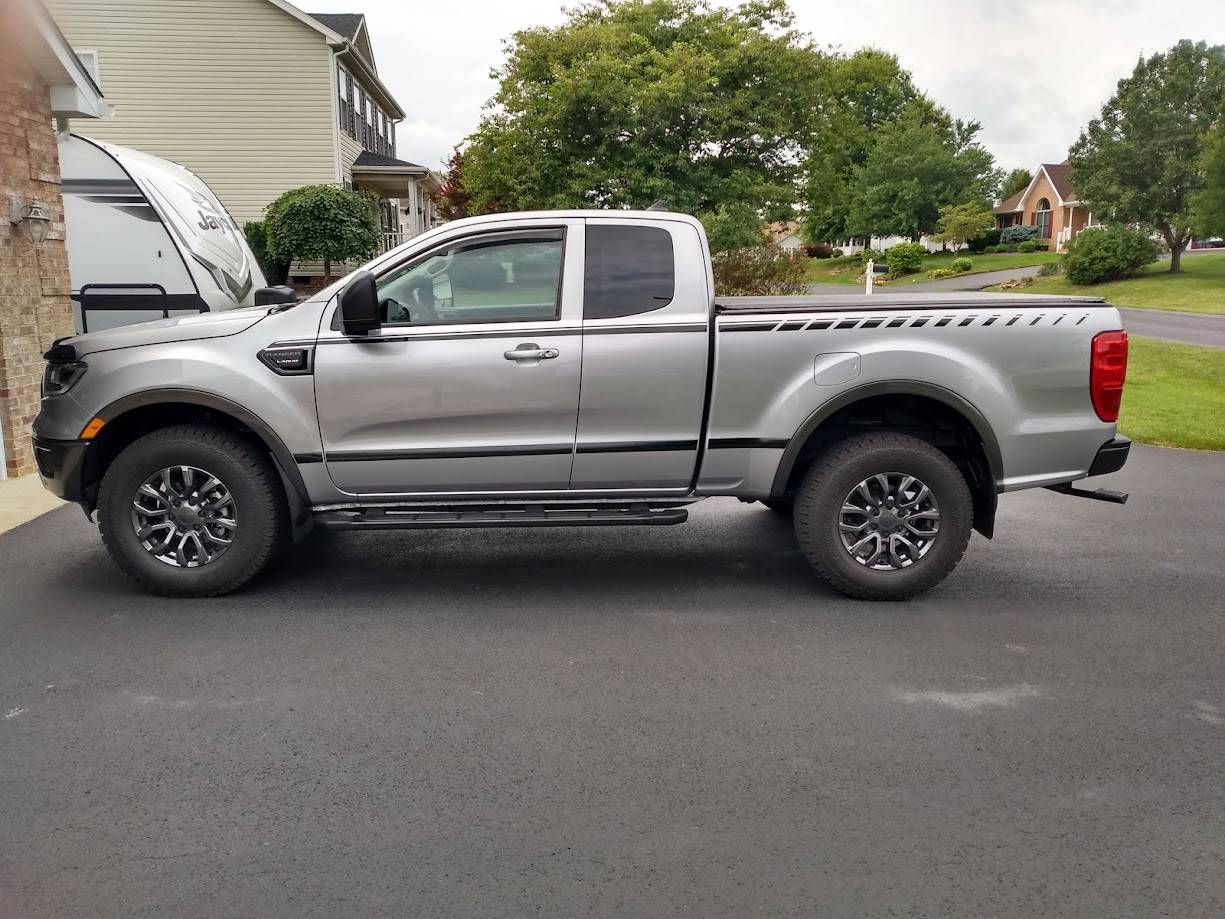

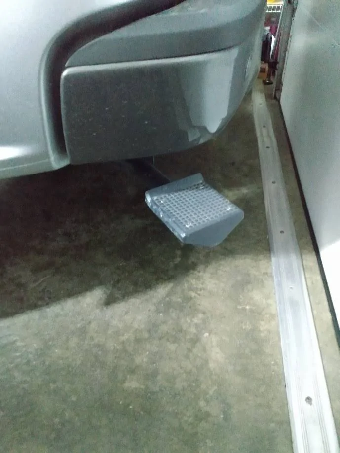

Hey Grumpaw, is that a step on the rear of your truck? Can you take a picture from the back? Been thinking about getting one.
70
4,387
20,560
Yes, Dee Zee Bumper Step, DZ6206S. Simple bolt on step, fixed position, non-folding. Runs around $80 ish depending on where you get it. Very handy to get into bed.
Looks like it protrudes to become a kneeknocker, but it doesn't, .just the photo angle. Barely sticks out from bumper when looking straight down.
