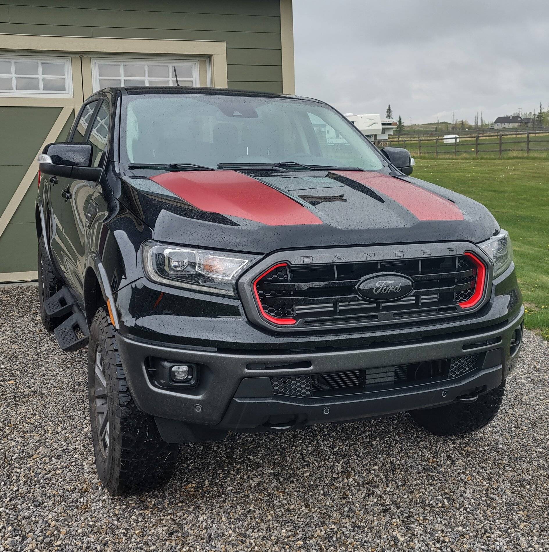

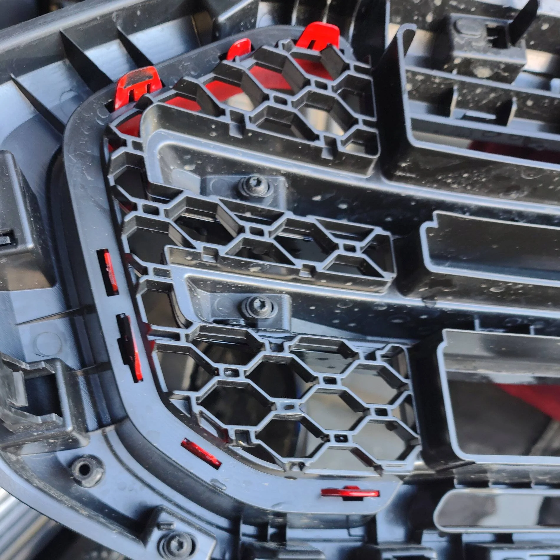

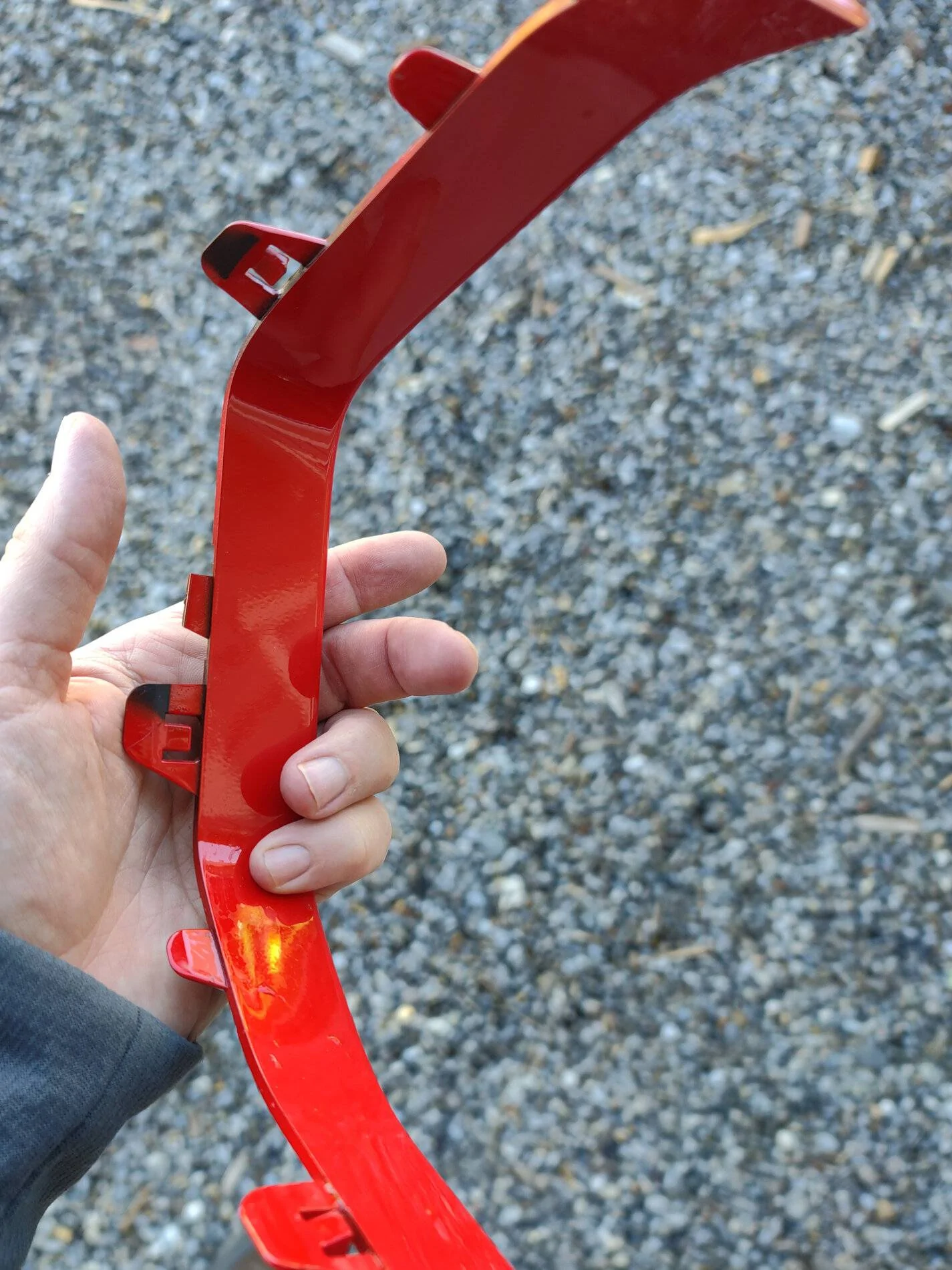

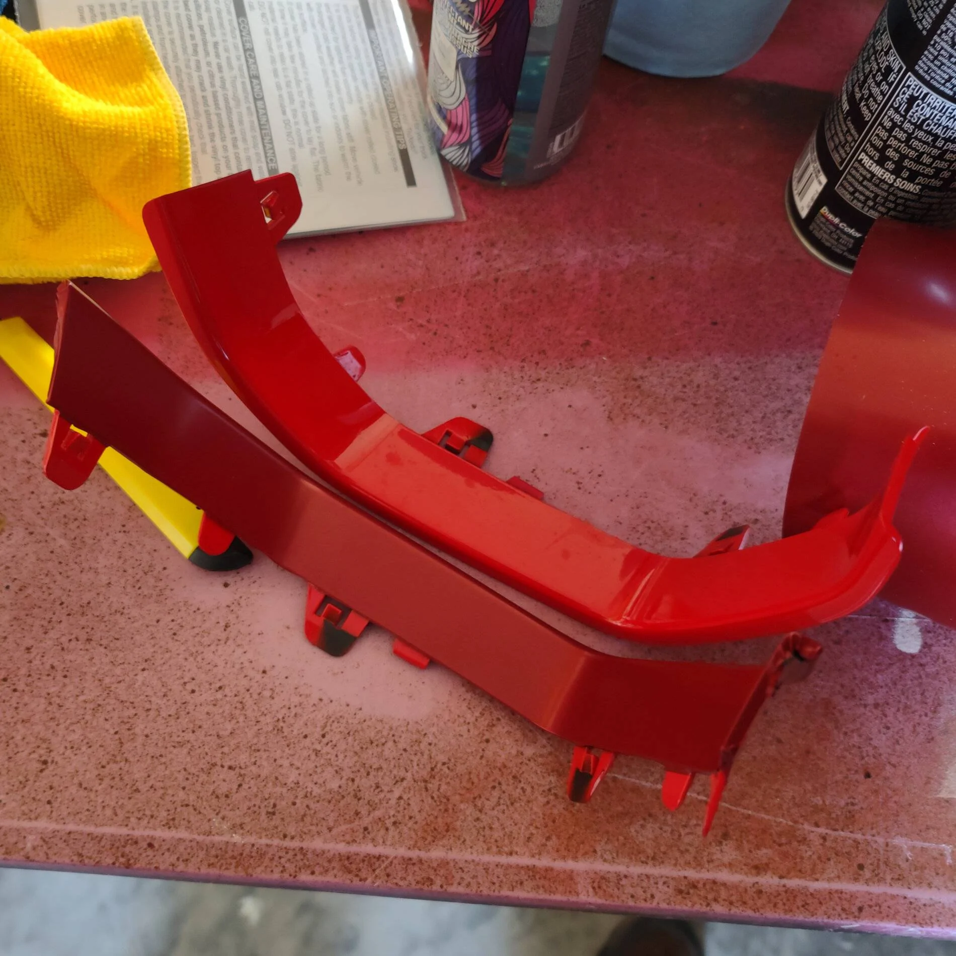

Got impatient and pulled the grille off tonight after work. Not hard but had to take my time. I won't win any awards for the crummy wrap job I did but at least the colour matches. Might pull them off again when I go back for the sides and have them do a proper job.
Can't upload the pix from my phone but will update a bit later with some shots of the backside and the trim pieces. Pix of back side of insert, removed insert and before/after of wrap below.

looking at the pictures it looks like you could pop those off without pulling or loosening the whole grill. what do you think Seeing it firsthand?

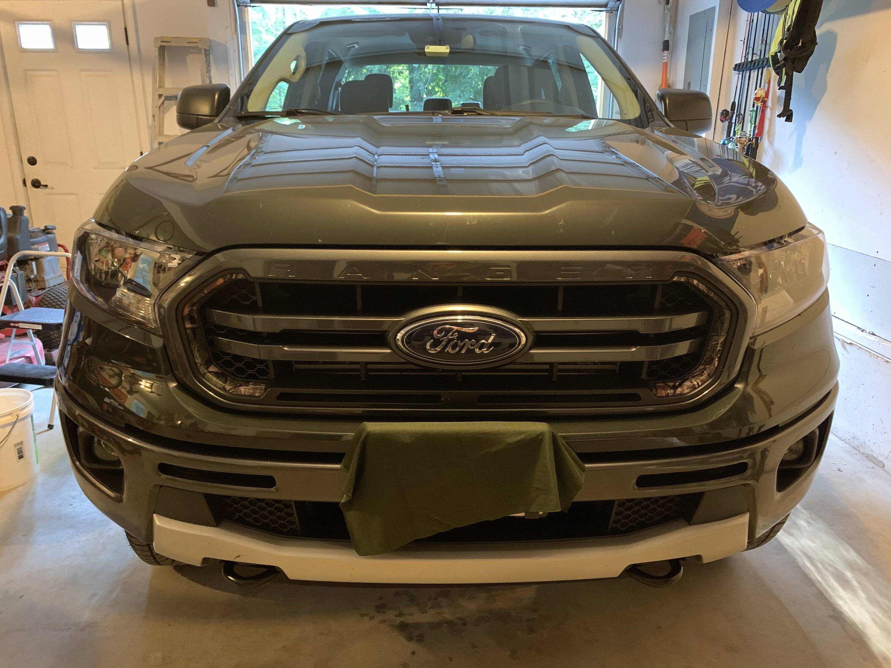

How did it turn out installed? Any pictures as I’m looking to do the same thing.
