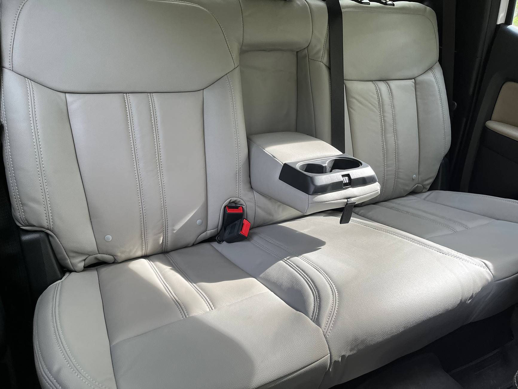

Here's a pic of my rear seat after I recovered it in leather.
All of those pleats are held in place with hog rings.

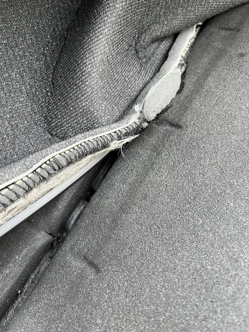

Here's a pic of how they attach.
Each one of those grooves in the foam is where a hog ring goes.
