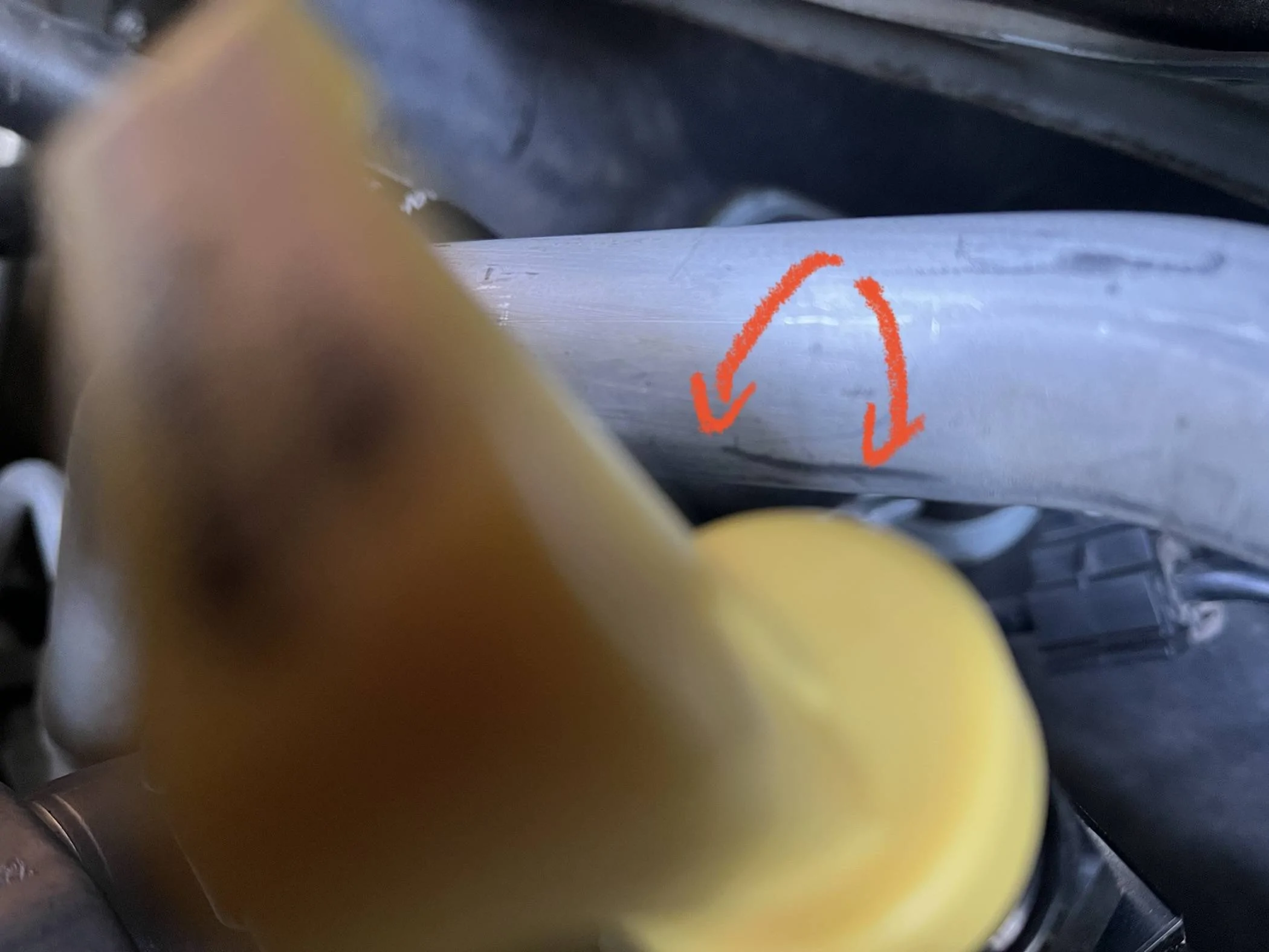

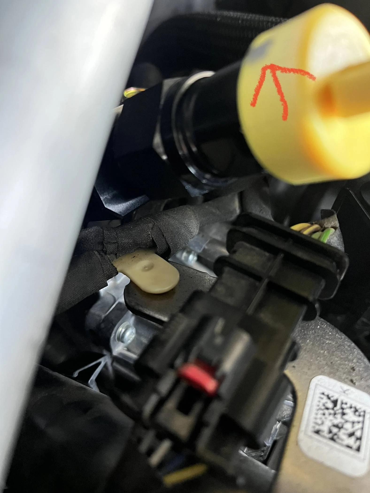

1. Adjusted a/c by loosening bolt initially to get approximately 1/4-3/8 clearance at the closest point ( pic#1). Pic 2 & 3 shows where stick cap and a/c tube have made contact. Loosened bolt again and verified it was still as fas back as it could go then nudged the tube back as far as I could and now have 5/8” clearance at the closest point (pic #4) . Wiped contact mark on stick as clean as I could get it and will monitor to see if it contacts again. Note: I have pulled our 6000lb trailer several times since installing dipstick.
2. No issues with stick going in
3. Loom was loose but nudged bracket down a tad to be sure

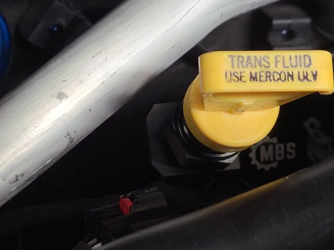

So I re-verified the stick to A/C line clearance, I just hammered the throttle in drive then reverse, my stick is 3/4" away and it really looks like it did not get closer than 3/8"-1/2" of an inch under load.
So I guess that 3/4" is acceptable clearance, originally I stated 1" to give it a extra measure of clearance.

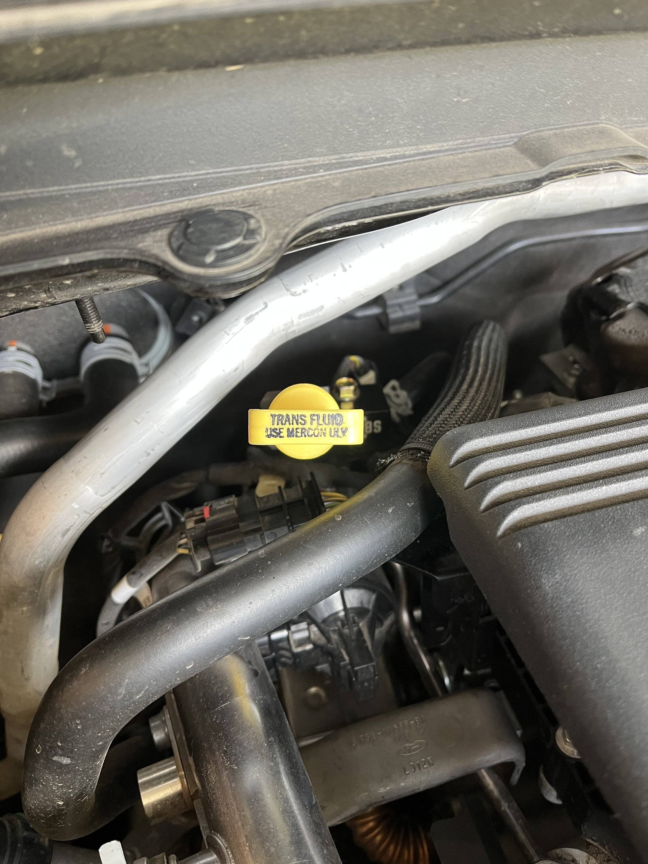

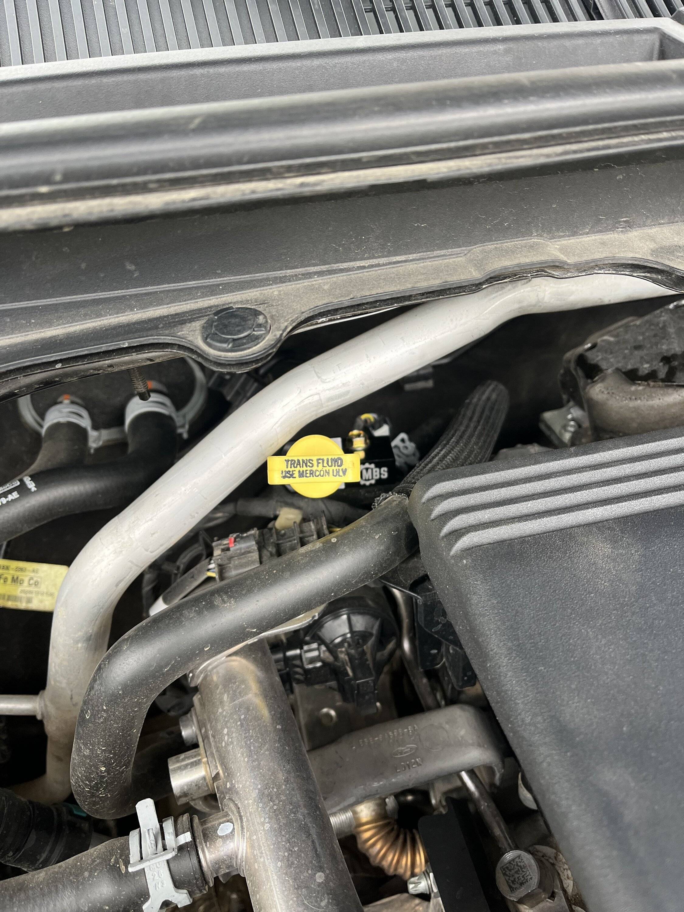

The serial number on my dipstick is #19.
I have 3/8th of an inch gap between the A/C line and the stick tube. (Do I need to adjust the A/C line?)

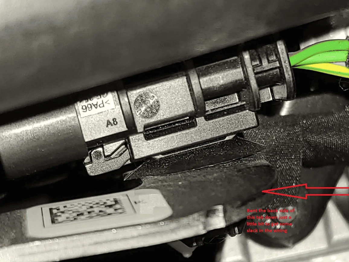

I did bend the aluminum tab down just a bit to give the wiring harness that passes under the dipstick tube some slack.
The dipstick itself catches just a tiny bit but nothing to be concerned with, but the lettering does have to be right-side up or it won't go at all.
