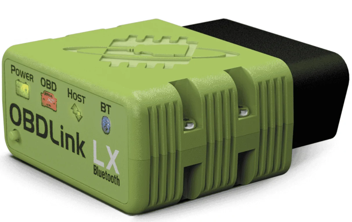

I pulled an old Android tablet of a box over the weekend just so I could load Torque. The iPhone requires a Bluetooth 4.0 OBD reader but what I have is an OBDlink LX device from several years ago. I got all that working but curious to know what software/app you're using. Torque (free version) doesn't have a transmissions temp guage.
I use OBD Fusion for IOS so I'm not sure how this would relate to your Android question...in my particular app, there's options for purchasing Ford specific PIDs which I did and this extension has more Ford Ranger sensor access like cylinder head temp, oil pressure, transmission gear position (for when I'm in S mode) and transmission temperature....

You actually answered my question, thanks! My issue is the adapter that plugs into the OBD2 port. This is what I'm using:
This device doesn't support Bluetooth v4 which my iPhone insists on and it can't connect. My old Android tablet connect just fine.
I downloaded OBD Fusion and will research the PIDs.
