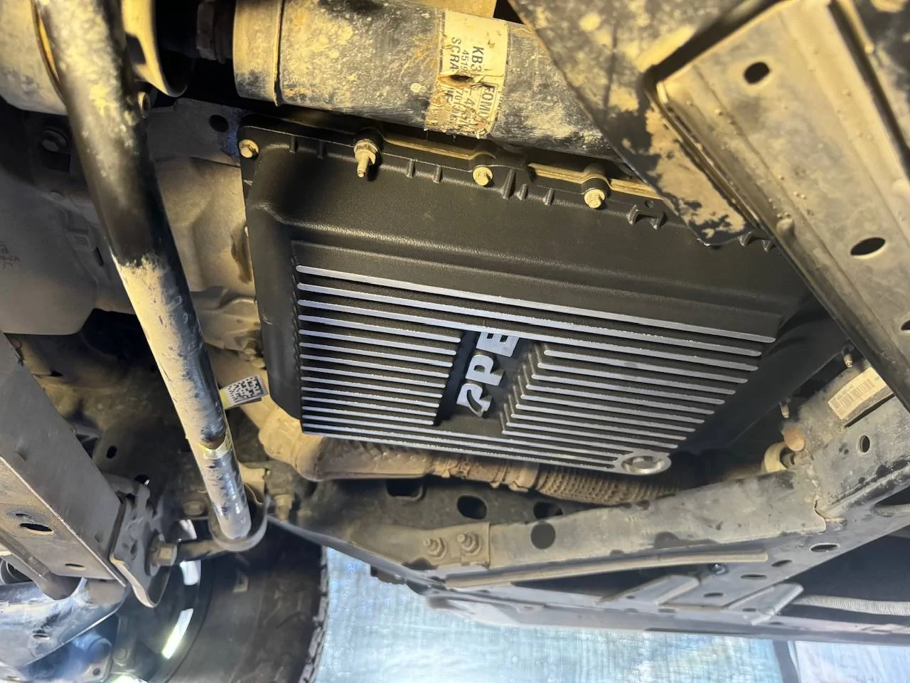

Installed mine months ago but finally got around to installing PPE aluminum pan yesterday. Removing the fluid through the dipstick with a hand transfer pump from Harbor Freight was A little bit of a pain Next time I’ll use a 12 V pump, but still easier than taking a shower of ATF.. When I pulled the pan, there was barely any fluid left in it and checking the fluid after filling was also easy thanks to the Fitzstick. Thanks again, Mike for all your hard work on this project made this job that much easier.

Next time you'll have a drain plug.?
Nice job. Did you reinstall your heat shields? A very high quality pan.
