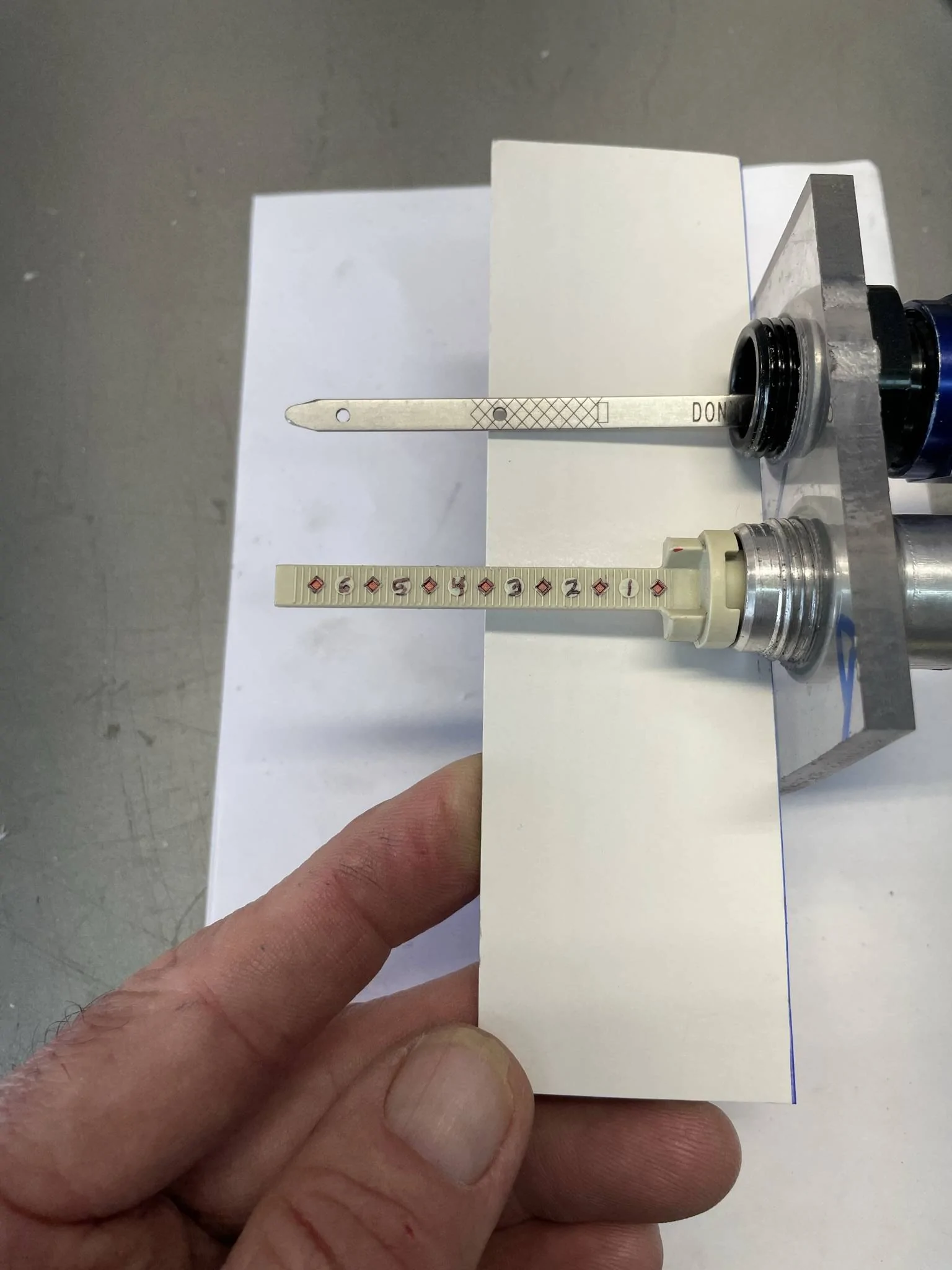

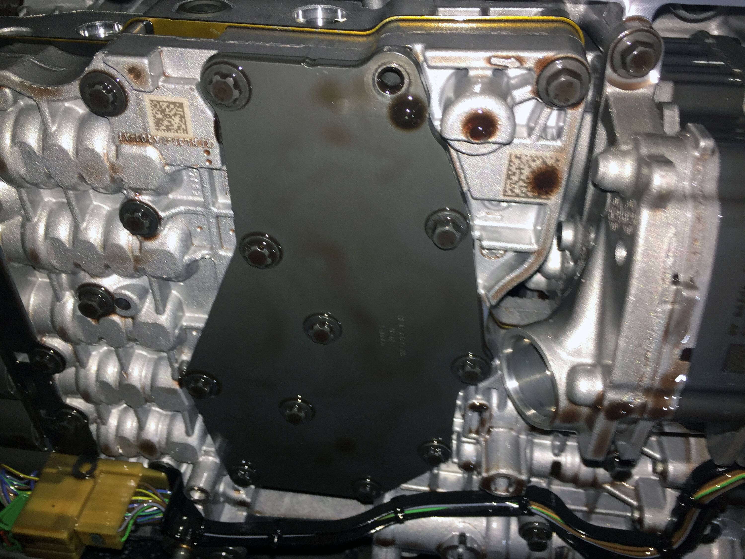

I would like to see where this mounts in relationship to transmission internals. Only way you’re going to know is dropping the pan.
9,205
28,406
NWO Robot Polisher
As he has it setup, the relationship is identical ...the plexi plate represents the entry into the pan...
Trigganometry
Dec 4, 2020
153
5,833
25,359
Engineering
I see that but factory is a hard plastic piece that plugs into a counterbore in the transmission casing and the rest of the plastic gets buried in the aluminum threaded cap. That keeps the tail of the stick from wandering around the internals of the transmission. Just a piece of sheet metal unsupported could be potentially problematic.
9,205
28,406
NWO Robot Polisher
I've dropped my pan...it's full of Bud Lite...

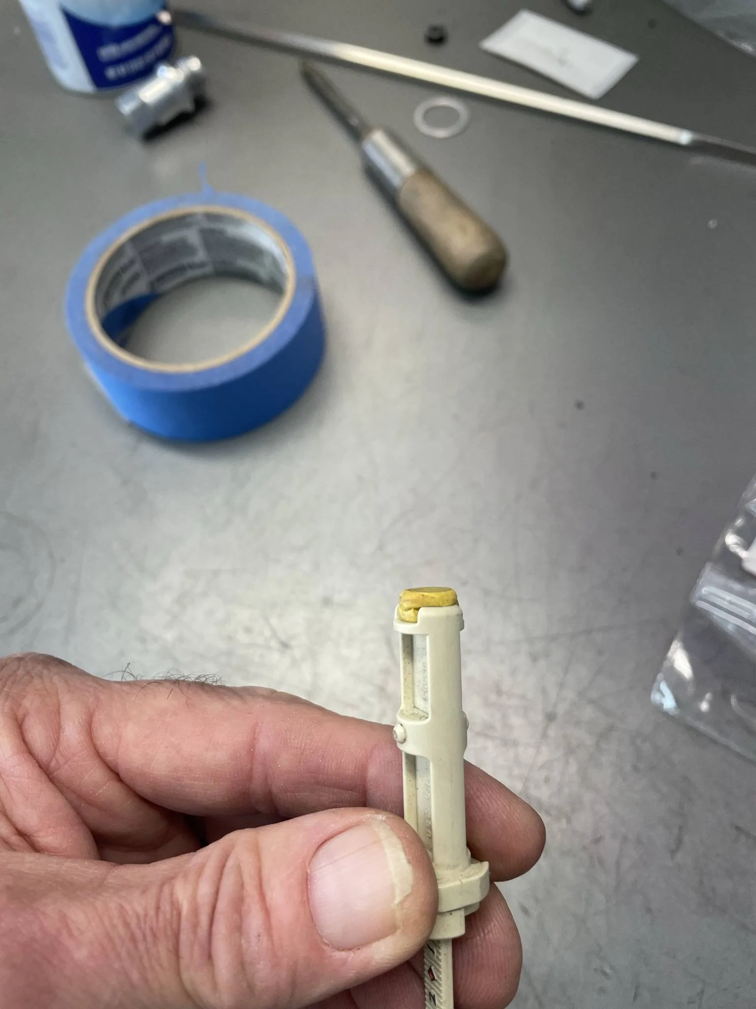

These two comments are surprising, up until Ford deleted them they were in every trans, age old proven design, I just copied it.
Also, in doing the final fitment check, this picture is not correct.
The dipstick does not go all the way in the cap, I was suspicious of this and needed to verify exactly the transfer marks, so I did a fit with clay, it's .080 deeper in the trans when seated like you would have while checking fluid level, this how you would do a side by side marking check with the stick pulled out .080

All moving parts are way above and to the left of the dipstick. Nothing can touch it except fluid.
9,205
28,406
NWO Robot Polisher
Correct...
