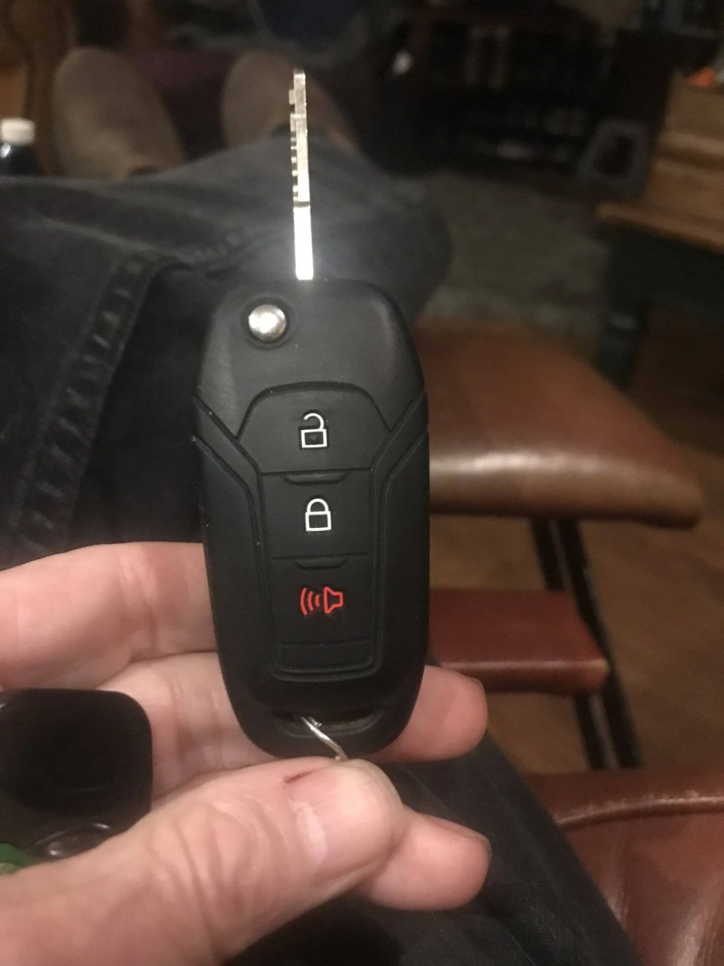

I ordered my ranger mid June, than later decided that It would be real nice to have the remote start on the key fob. (yes I know about the phone app) (yes I know about the aftermarket remote start systems)
I have been told that they can not change my order without affecting the delivery date SO.
I read around here about the Ford Perimeter Plus alarm system and that it comes with remote start " When activated by your Ford Dealer".
So can anybody answer the following questions:
does the XLT with 301A package, (without the factory keyfob remote start) come with a 4 button remote like shown below?
If the truck comes with a different remote, does the Ford perimeter plus alarm come with a new 4 button remote as shown above?

2020 XLT w/3 button fob. I wanted an upgrade with start on fob. Dealer said it only comes from factory like that. The kit you spoke of they offered but had a separate single button fob. I went with the aftermarket unit lock/unlock/lock start. Has worked flawlessly since adding it a week after I got truck.

I have the 302A package on my XLT and it comes with that 4 button remote.

thanks everyone. I have 4 choices
get the perimeter alarm add-on which also adds remote start using my original fob $276.11 installed
by the ford extended remote and carry 2 remote controls :( $110 installed
Go aftermarket, starts around $100 bucks.
Use the phone.
