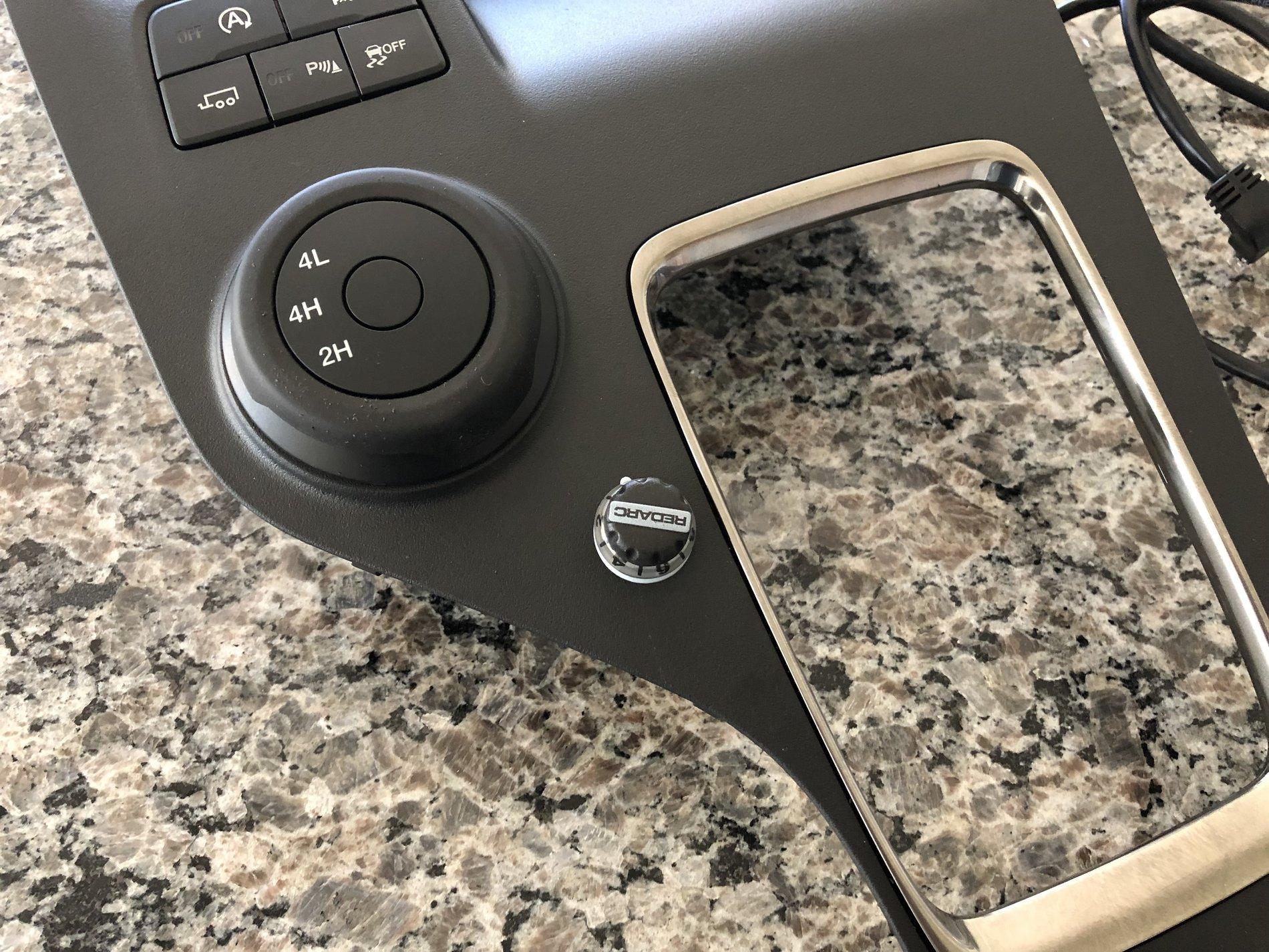

I thought I would share my installation of the Redarc brake controller. I decided to install it on the center console behind the 4x4 selector knob. It seemed like the cleanest location to install in my opinion.

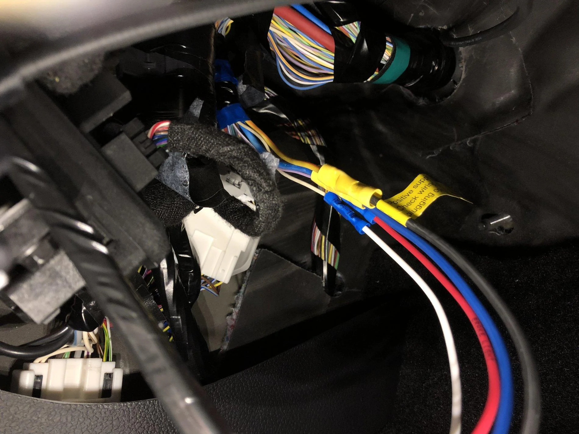

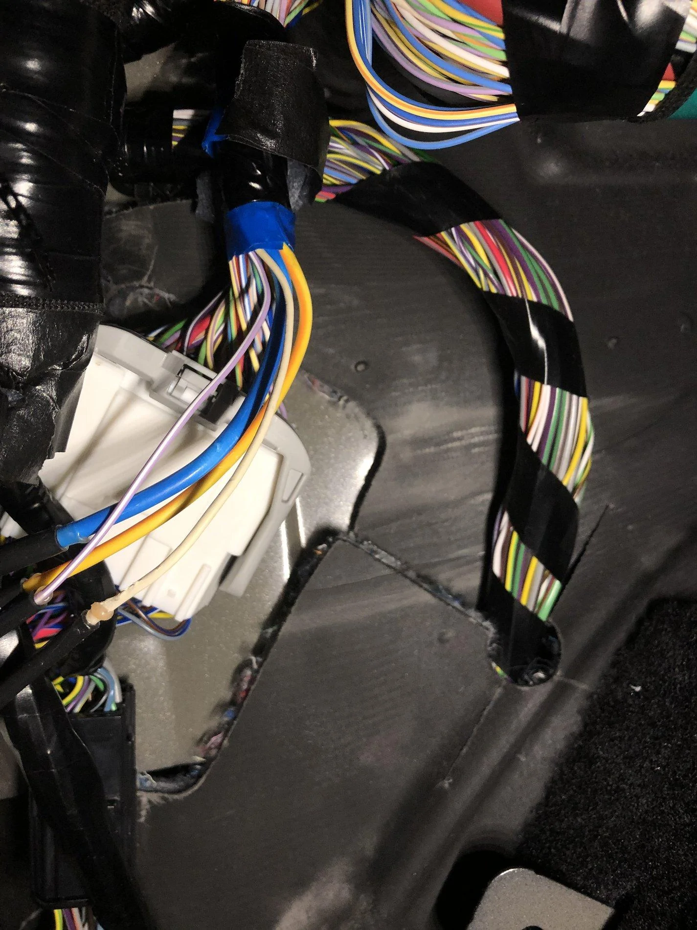

I found the four wires under the dash on the left side behind the fuse panel.
I attached the wire harness from the stock Redarc brake controller.
This is the pic after connecting the Redarc wire harness.

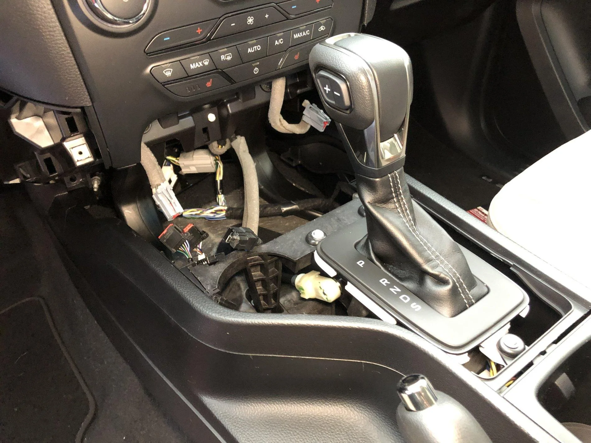

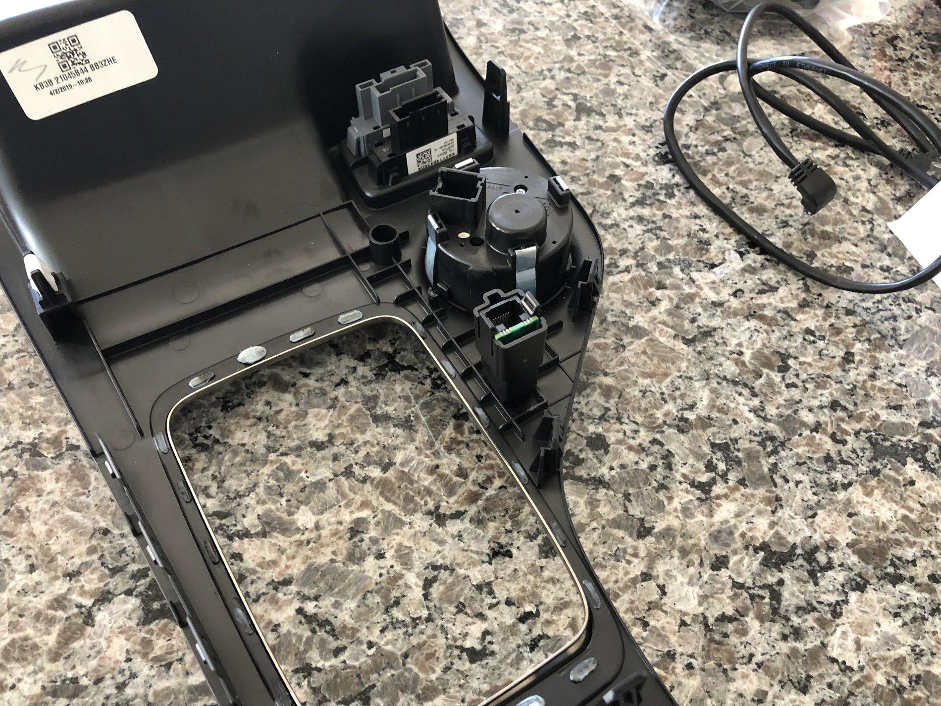

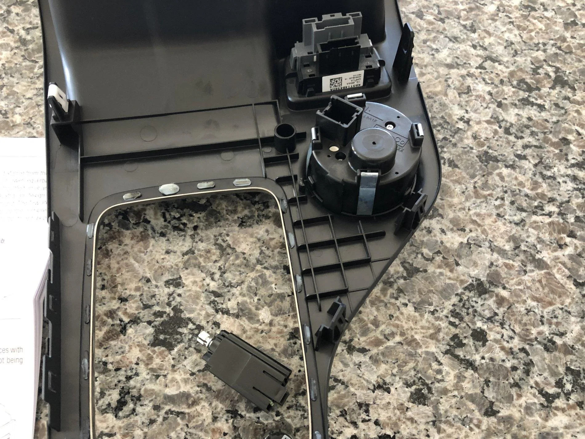

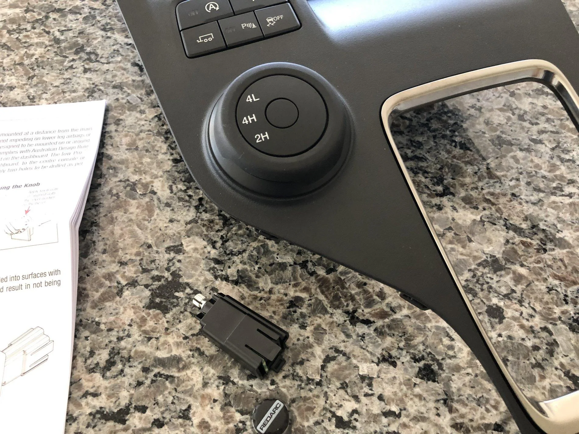

I then removed the top of the center console and installed the control knob

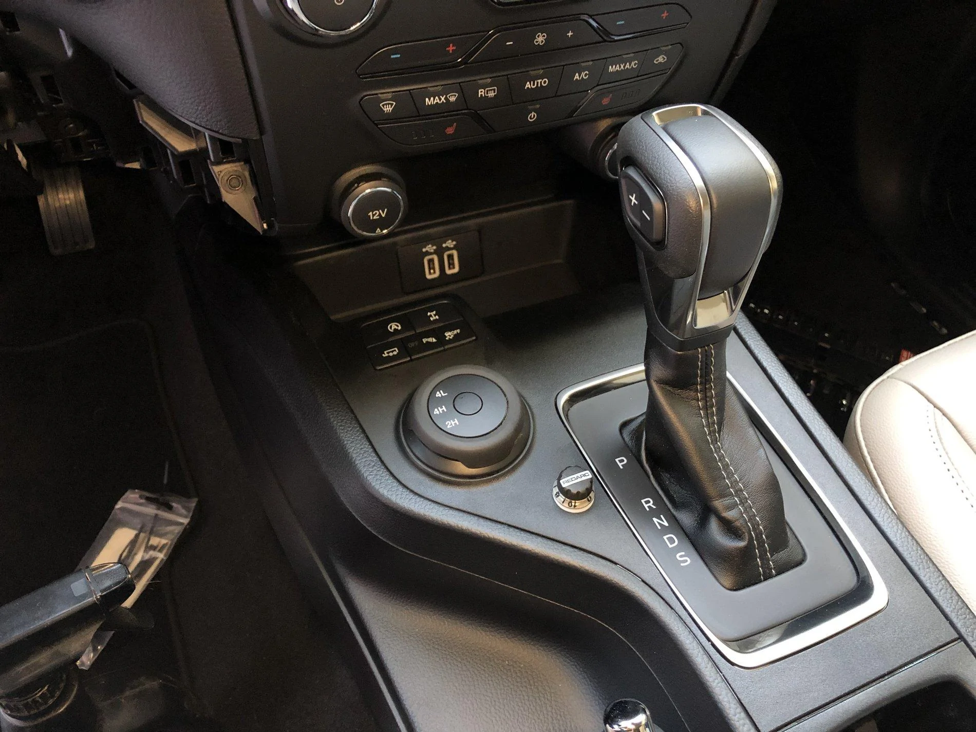

This is the final install. In my opinion it is in the best location. Clean and factory looking. Thank you to all the previous posters to this thread. Without it I wouldn’t have had the courage to do this install.

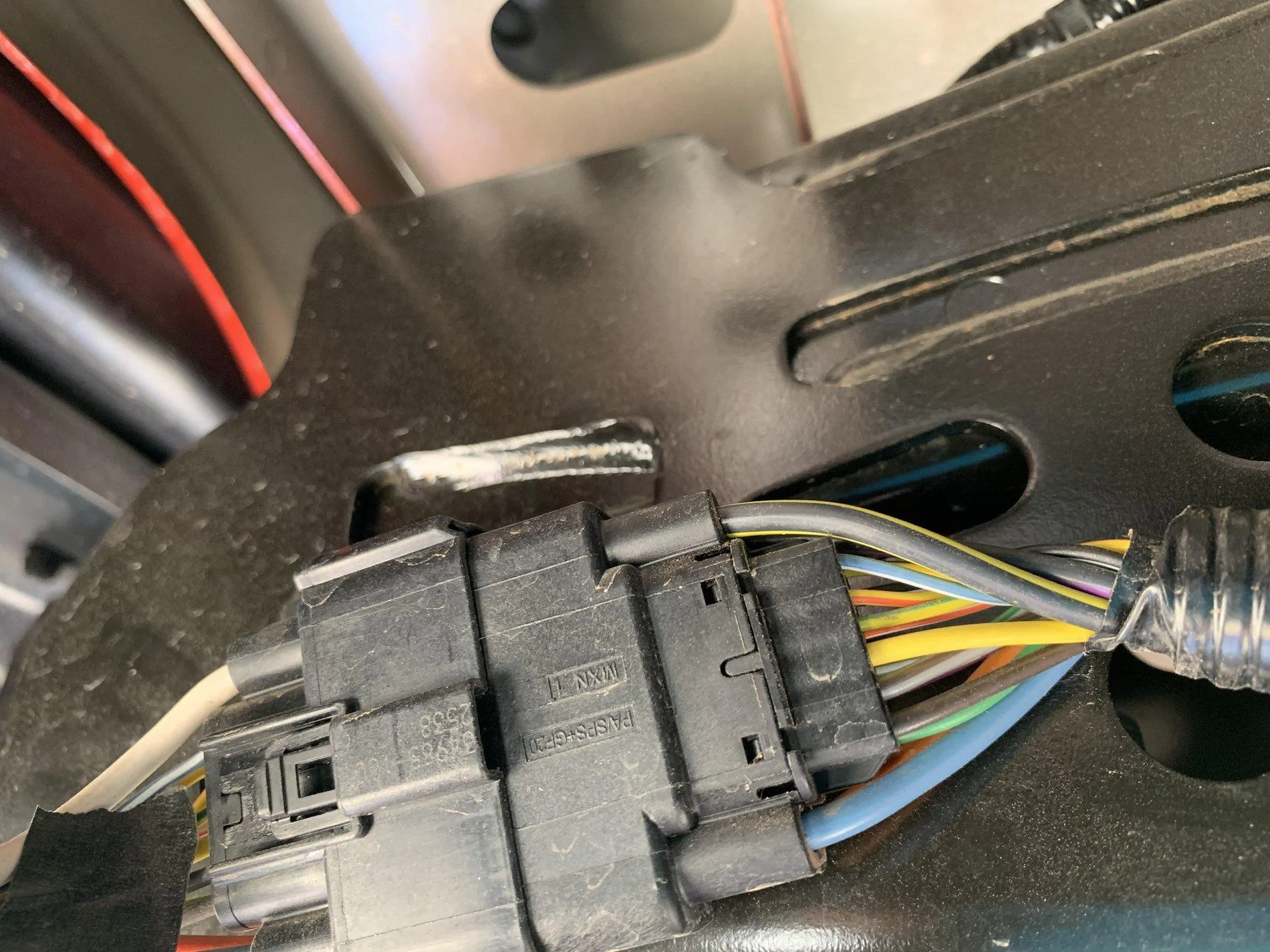

Does anyone know if you could run a wire from blue wire coming from redarc to this connection right before 7 way plug? Right now I am connected to black/ green wire and have no brake power at 7 way pin for trailer brake but when you push in redarc button I have power on both sides of splice connection. Had ford dealership check and they didn’t know either, said they were waiting for Ford corporate to get back with them.
