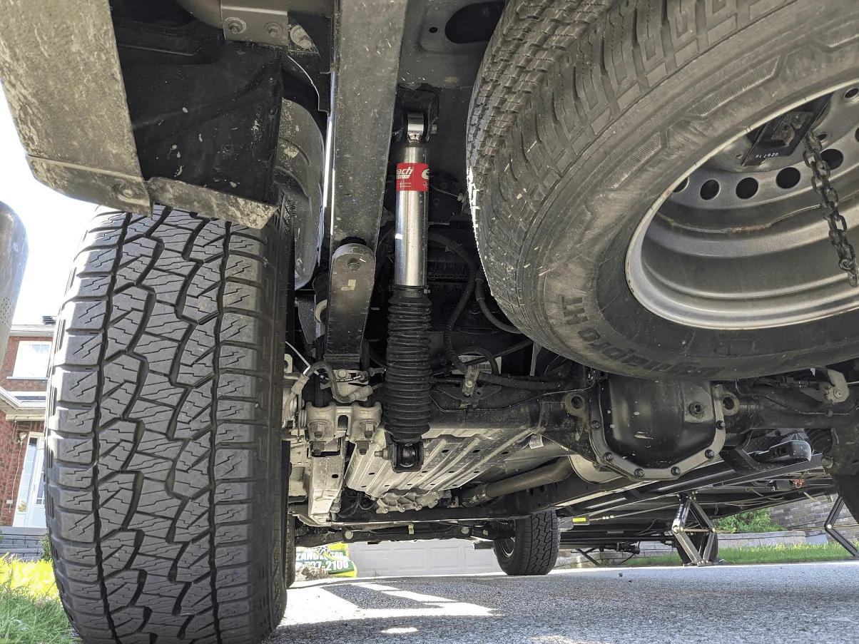

I installed the Eibach's yesterday and then picked up running boards about an hour away.
At first I was thinking they felt a little too firm as I drove around the block near my house, but on the 2 hour trip afterwards I found myself feeling very happy with them. Feels almost perfect to me now. I really like the stock front + Eibach rear combo.
I'll be towing my travel trailer tomorrow and Saturday so I'll report back as to how they change the towing experience for me.
As far as installation it was pretty simple. Only difficult part was compressing the Eibachs in order to get the lower bolt in place. I had the truck jacked up far enough that the wheel was off the ground but there was still 2 or 3 inches of compression needed. I used a small pry bar wrapped in automotive felt tape (as to not scratch the nicely anodized metal of the shock) to get it done.

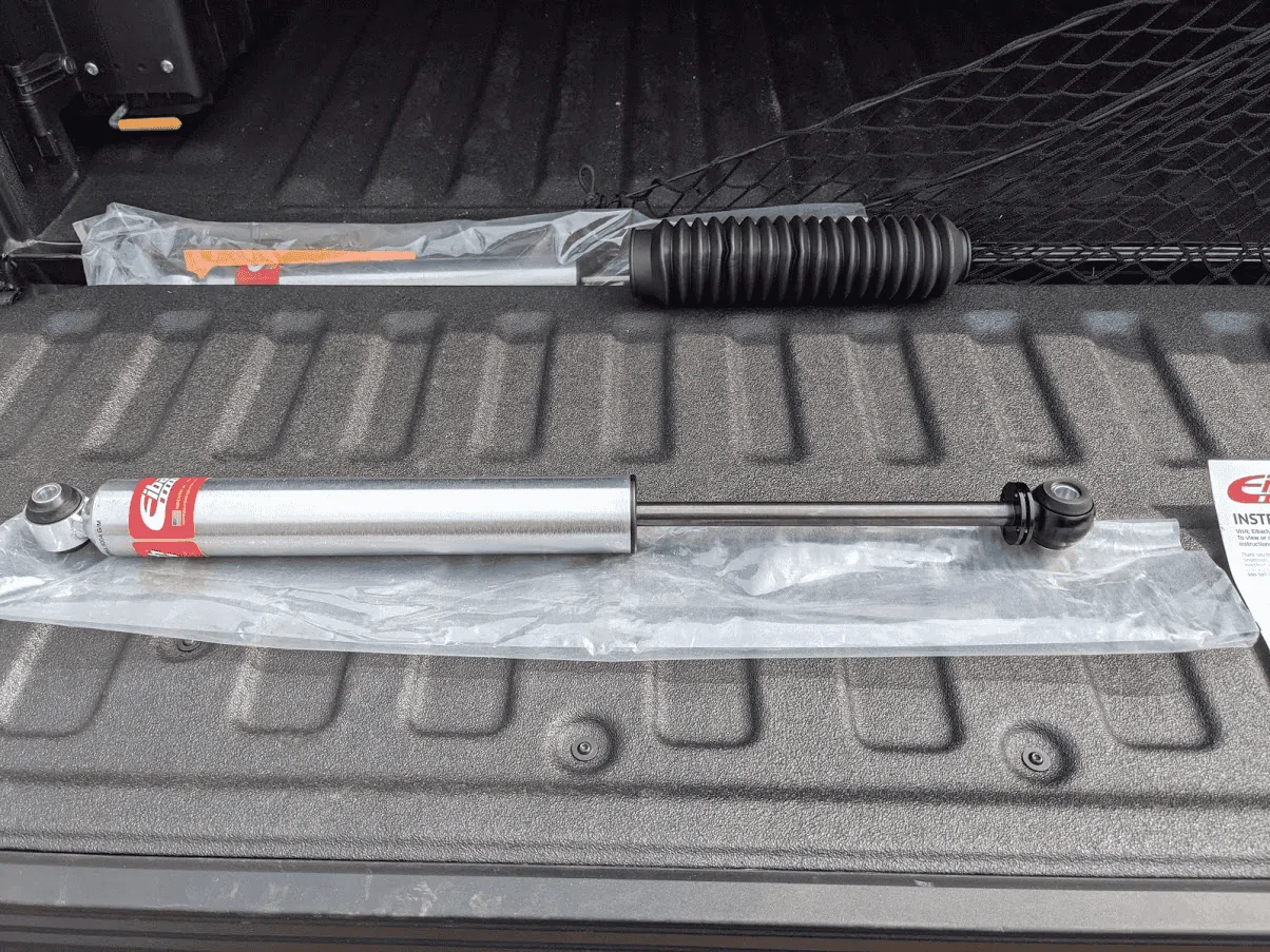

I'm getting my Eibach rear shocks installed this morning. I'm a wallet mechanic these days. Like the other person, I also have the Hellwig rear anti-sway bar.
I got my Eibachs at Stage 3 motorsports. They are the same price as Tirerack. https://www.stage3motorsports.com/E...r-4WD-Eibach-Pro-Truck-Sport-Rear-Shocks.html
Back in 1993, I installed some 20 dollar Pep Boys Gabriel gas shocks on the rear of my Nissan pickup. Much like these Eibach shocks, they were super hard to compress. One thing that made it easier is that they came in the box already compressed, they had a plastic strap keeping them compressed until installed. It's a shame that these Eibach's don't have the same thing!

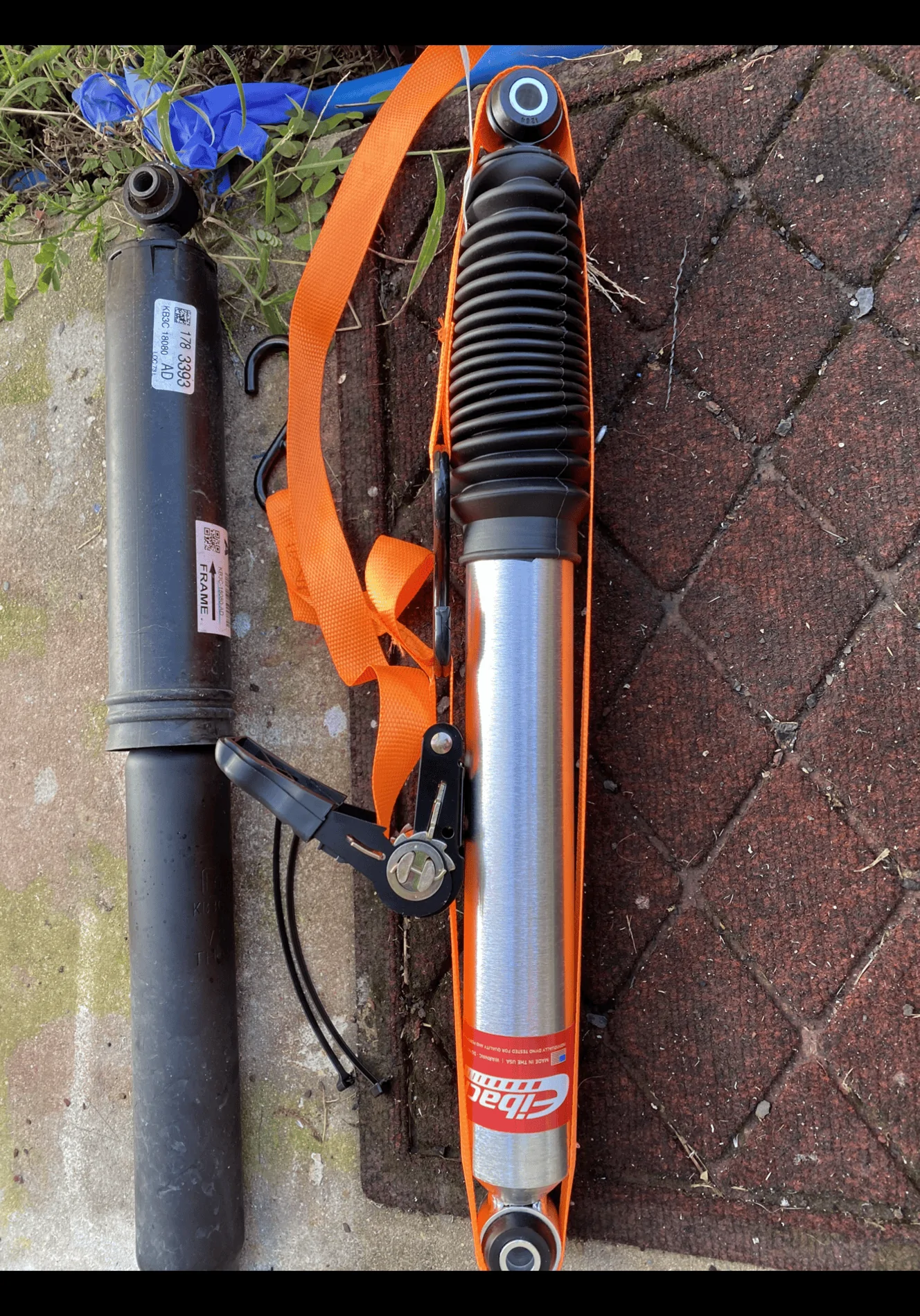

I installed the Eibach shocks on the rear. No Jack’s, just a wrench. They were easy to compress with a tie down strap. I measured hole to hole distance with a tape measure then used the strap to get that. Very easy to bolt in after that.

Another update as I towed our travel trailer 2hrs away and back on the weekend and then drove 1.5hrs into Toronto and back today without the trailer.
Our first trip took us on the highway, driving between 110-120 km/h for most of the time. Our destination was the same area that I previously found very annoying with the stock rear shocks. We also towed through a short off-road section to where we setup our trailer, way out back on a friend's property. On the way back home we took a more scenic route through winding roads up and down hills and through some small towns, going between 80-100 km/h for most of it.
Verdict: the Eibachs are awesome and I am so happy with them. The rear is not too firm or too stiff, instead having just the right amount of controlled movement. There's more bounce in the front end than the rear now but it's not actually a bad thing, in fact I like the balance between the stock front shocks and the Eibach rear shocks. The rear feels properly planted and there's added confidence now. This is how the truck should have arrived from the factory, if you ask me.
Today when I drove into Toronto and back it was a dream. Much of that trip was around 120-130 km/h and driving in the city was great as well. Great gas mileage to boot. I usually hate driving into Toronto.. but this was a nice trip. Adaptive cruise helped a lot as traffic picked up.
Anyone on the fence.. I say go for the Eibachs!
