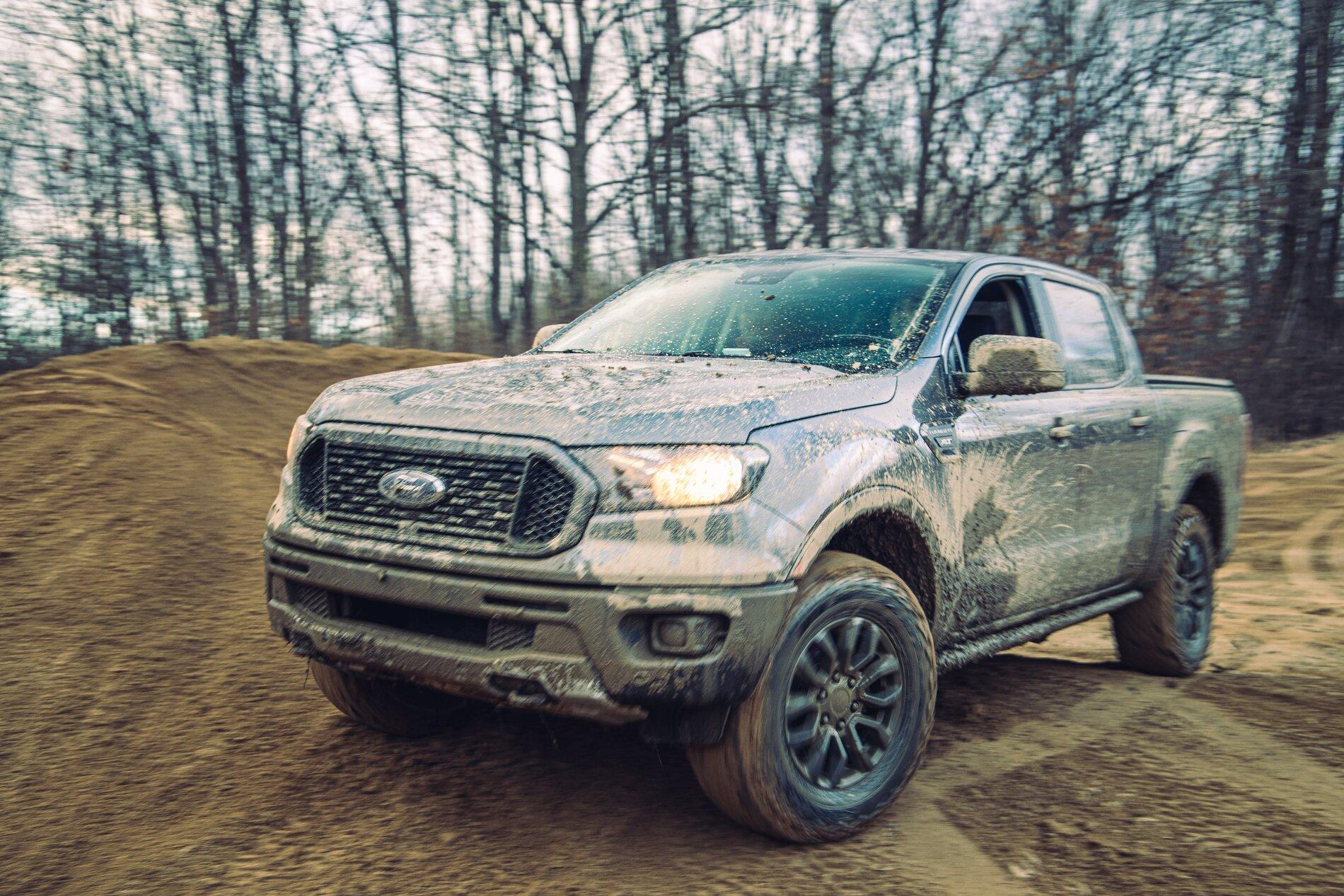

My Ranger is stock but I've upgraded to the max tire size that fits without a lift: 265/70R17. I'm definitely not gentle with my Ranger but it takes it like a champ.
I agree with Frency that the Old Man Emu kit is really the only proper lift kit for the Ranger since no other kit lifts the rear end. That being said, the Fox kit is probably one of the best value kits and it gets the job done. You get proper coilovers up front and new shocks in the back. As long as you don't get the spacer kind of leveling kit, you can't really go wrong.
