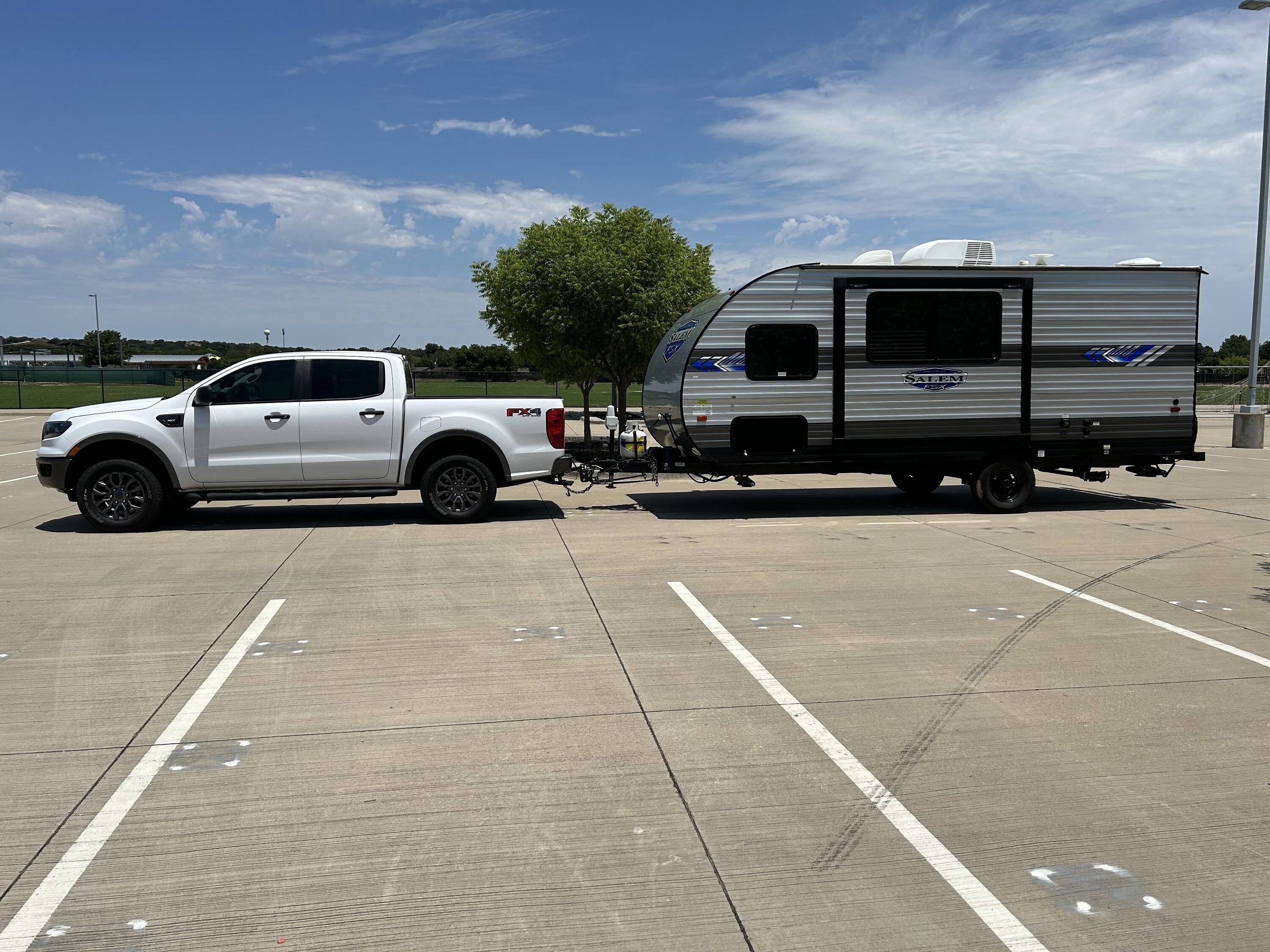

Your truck looks like it's been leveled. Am I wrong? If I'm correct I would recommend bringing the front down a little bit so you don't have as much squat in the rear. When loaded with that trailer you're better to have the rear end higher than the front
It is stock and has not been leveled. With the camper hitched and WDH installed, it sits 36" in front and 37" in the rear. Unladen, it sits 36-1/2" and 38-1/2"

So I bought a new toy, and with that came towing in my ranger for the first time. Needless to say, the Icon leaf springs are not up to the task even at level 3 im riding the bump stops, though they have been awesome offroading. Anyone here had experience with the roadactive leaf helpers? Are they good/worth it? I'd rather not replace the whole leaf packs.

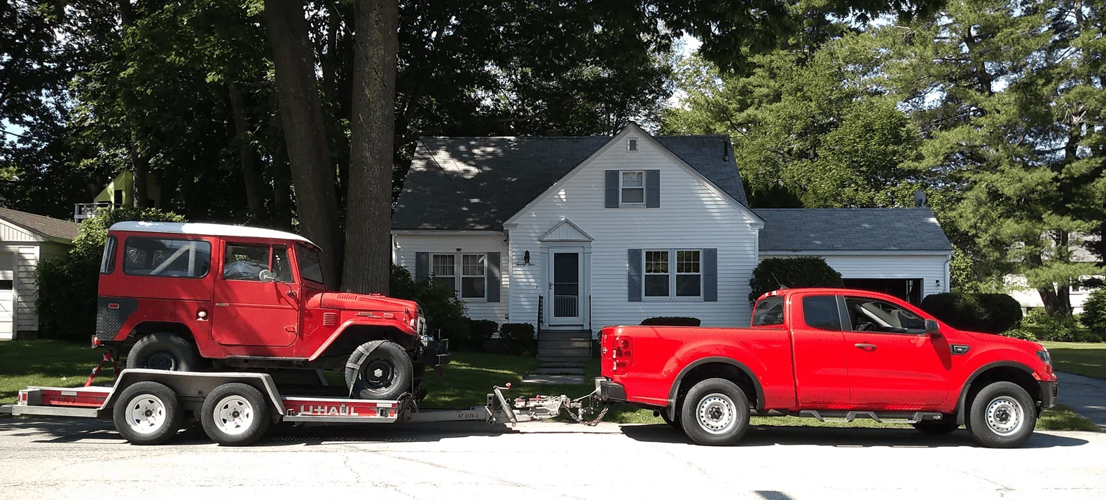

I have no idea about aftermarket springs but I'm curious, from members in this forum, why GreyWhale's truck would ride so low? (bonus though, now that engineering design flaw of the bed rake is fixed) =D
I'm fully stock on my 2WD and think I had quite a bit of weight in the pic below (about 6,600 pounds) and far too much tongue weight (beats me, but close to 1,000 pounds?!?) with my drop hitch set too low. So much tongue weight that the Ranger's front wheels lost traction and slid a bit backing down a steep driveway with a little gravel sprinkled over the asphalt.
Are aftermarket springs not as "tolerant" to weight? Those single leaf Ranger springs don't inspire much confidence in me but I'm also old school and think a Deuce and a Half is sprung just enough!
I believe many aftermarket springs are meant for a smoother ride but I never realized they would have diminished payload? Or am I thinking about this wrong?

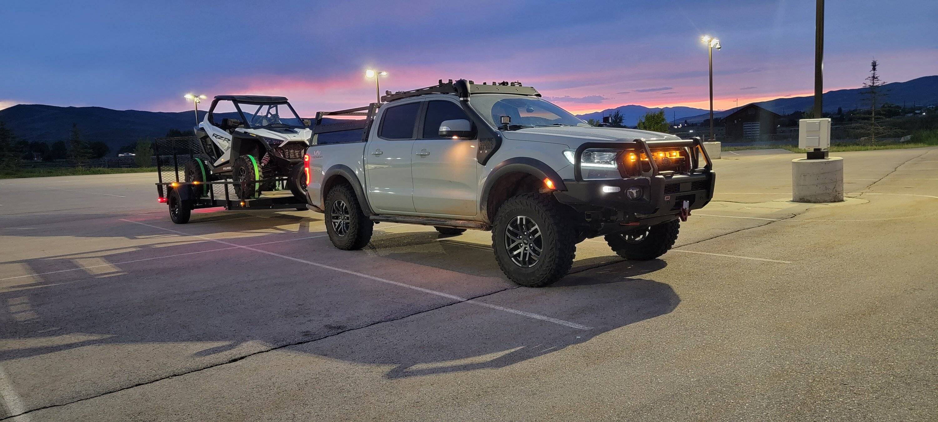

I am going to do air bags and tow a bit of the same (RZR's and race car). I mainly am doing bags on this as any squat gets me flashed at night due to blinding people.
