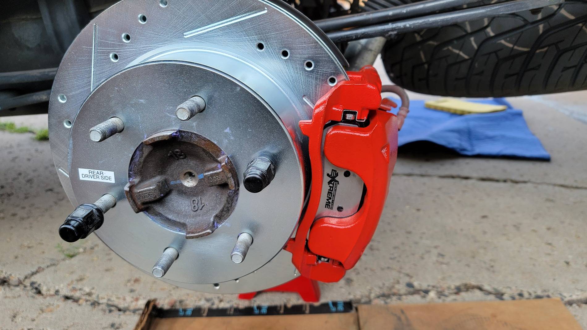

As was noted in a previous post a year or so ago, my rear brakes lasted 7K miles!! They were shot, rotors rusty (mostly on the back side), looked like the parking brake stuck some...
Obviously I replaced pads and rotors with PowerStop rotors and pads. After two full winters, not a mark on them from the elements. Far superior quality in materials vs OEM.
(FYI: Evolution Drilled, Slotted & Zinc Plated Rotors )

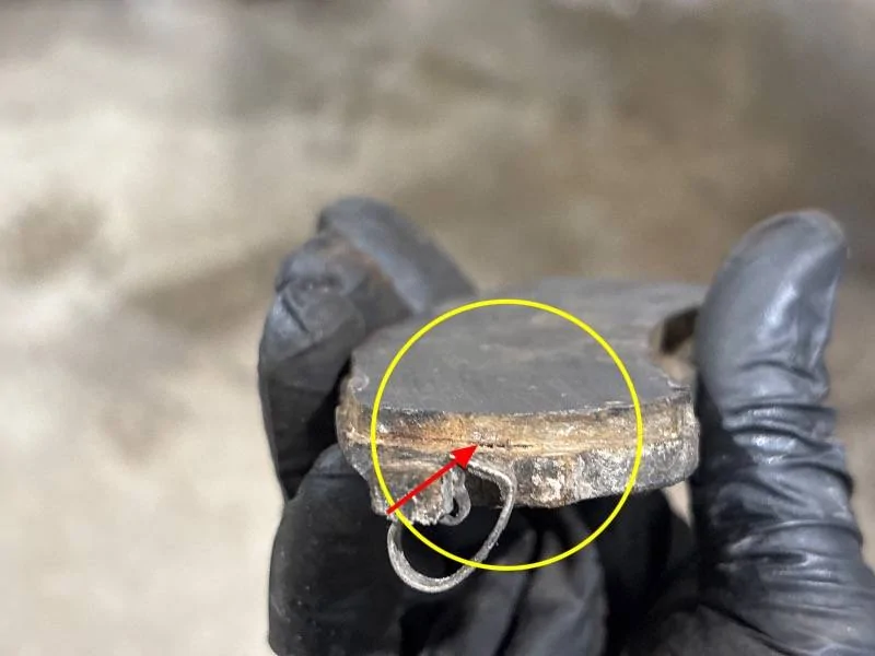

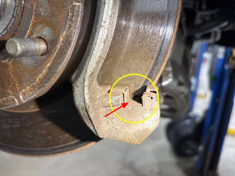

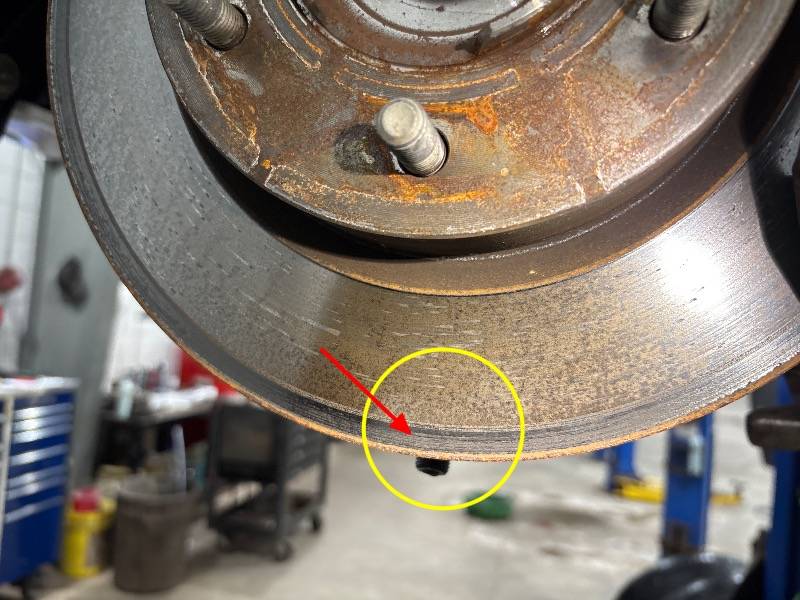

After coming across this thread I wanted to hear any thoughts on this quote I received...are they fishing for business or is this in line with what other owners have experienced with their brakes?
"- Rear brake pads beginning to separate, replacement required It’s recommended to replace brake rotors when pads are replaced, however this is not a requirement for the safety inspection. A front brake caliper service and match machine are recommended for the front brakes due to a lack of lubrication on the pad shims and rust ridging on the brake rotors. This is not required for safety."
