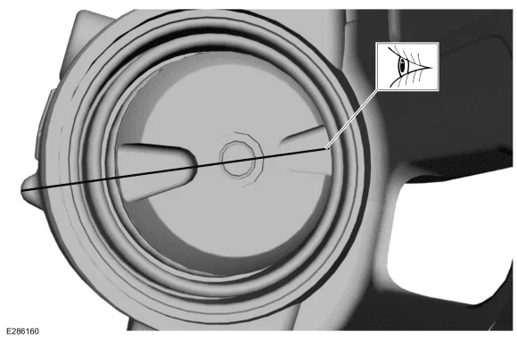

To Clarify, final resting fully seated caliper piston - should be in this position, an important detail left out of this description.
Ref: Turning Rotors - Oreily's Autoparts - Stil Turn Rotors
Interesting! Did not know that... I just went as far as it would go, which cleared the new pads. Thanks!
