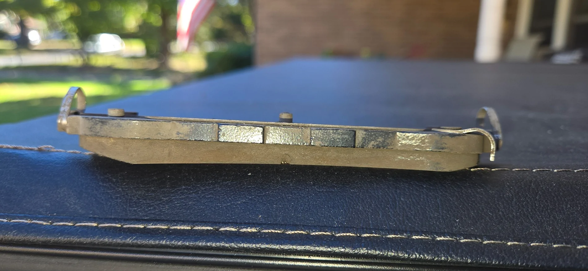

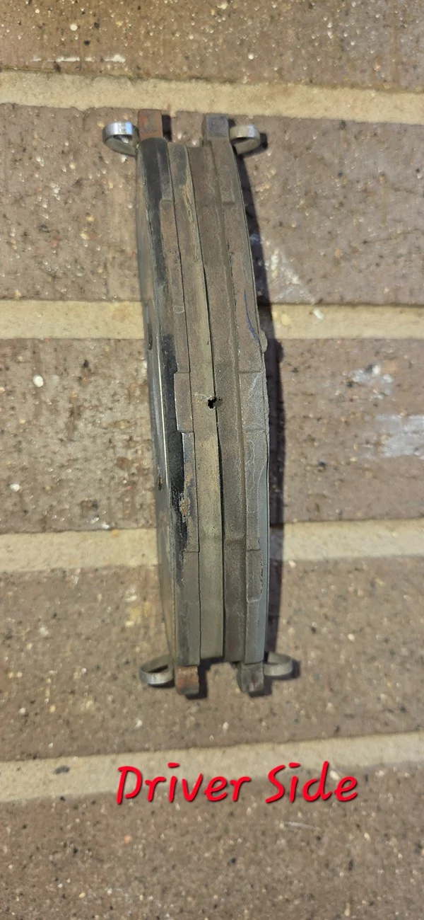

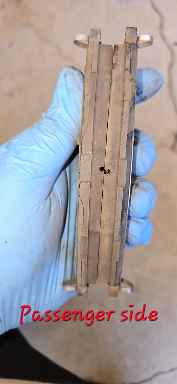

I inspected the rear brakes today and found tapering, but not in the side to side fashion, but end to end. Its more pronounced on the passenger side, but even the drivers side has a difference of 1mm. The drivers side also has more wear overall compared to the passenger.

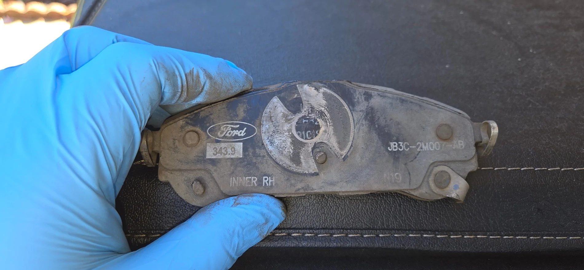

If I saw tapering on one side, that pretty well proves I have a sticky caliper on that side. But now Im questioning that possibility since its on both sides. I did notice that the piston mark on the inner pads seems to be off center, since the little cup on the piston for the pin is off center as well. Not sure if this could have something to do with it.

Have you ever replaced the front pads and have you ever bled all 4 wheels and lubricated the slide pins ? To me the wear in the pics doesn't seem worrisome, especially for the rears which provide less braking. Can you reinstall the pads on the opposite side that you removed them , also sometimes good to check the pistons under the seals and they can be lubed using brake fluid.

I would honesty just replace the pads and rotors. My rears are over half worn at 36k miles and the rotors are warped. The fronts pads are barely worn at all. Ford for sure screwed up on the rear brakes. I’m hoping to replace my rotors soon as I can feel it pulsing when I brake.

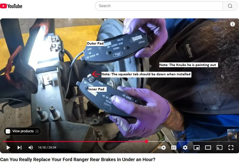

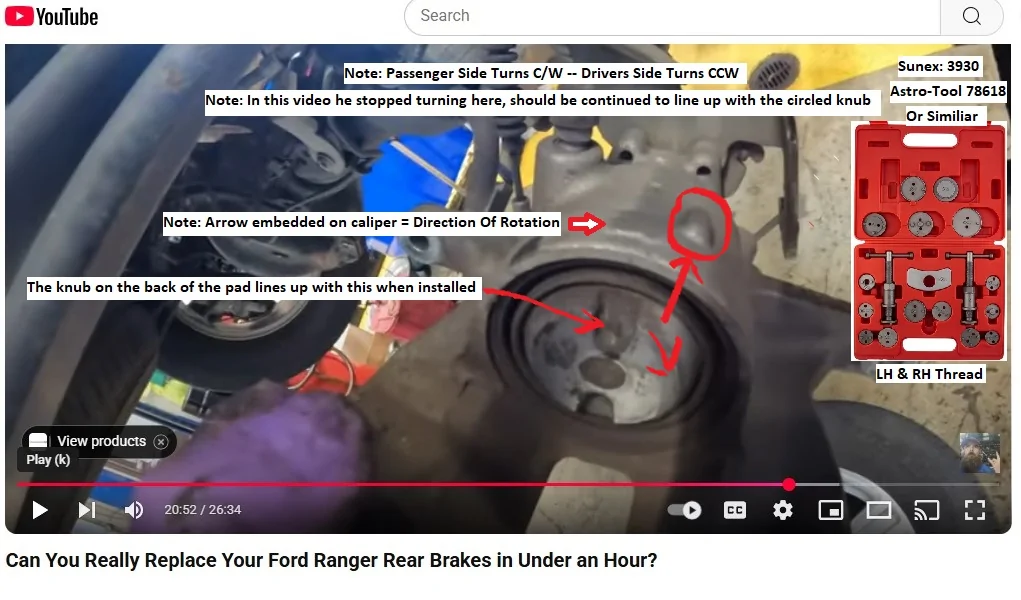

Replace the pads and rotors BUT MAKE SURE YOU HAVE THE BRAKE PISTON LINED UP CORRECTLY AND PADS ON THE CORRECT SIDES. They are a bit of a pain and the one side turns in clockwise and the other side counterclockwise. The piston has to be in a specific position or they will not wear correctly.

Why do I have the feeling this is the ultimate issue here? Again, I haven't done any brake work on this vehicle having bought it back in February, but I did notice the piston off center on the pad.
Would I be correct in assuming the dimples on the piston should be centered at 12 & 6?
If so, sounds like whoever did the brakes before I got it messed up. But other than the pads being FoMoCo, little way of showing its their mistake.

Just some reference for install of rear pads:
Since you mentioned (possible off center) wear marks on the inner pads.

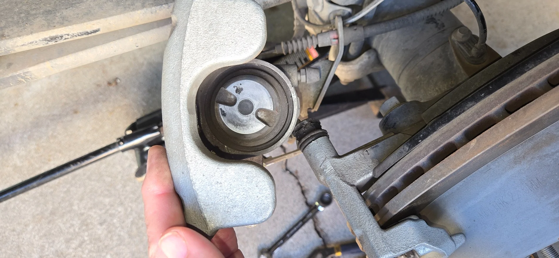

So, armed with this I took the passenger side off again just now to share what I found.
You can see the off-set of the piston on the pad really well. And on the 2nd image you can see the tapering better than yesterday's picture. FWIW, the piston is off center to the thicker side of the pad. The image below shows the piston rotation within the caliper:
So.... The question becomes was this an installation issue by whatever Ford tech that did the brake job? Or is the piston rotation due to some other factor? If its a workmanship issue by the service folks, I know I would have a difficult time proving this, since it would have been done prior to me purchasing the vehicle.

I spoke to a Ford tech freelance, and showed him these same images. He told me that the rotation of the piston is generally okay, as it'd be at 12 & 6 when the pads are new, and it then will roate some as the pads wear down naturally.
He stressed checking the slide pins to ensure they hadn't frozen up, but definitely said there was some sort of uneven pressure on the pads to cause tapering like that.. My slide pins, however, did move freely when I checked them. He did advise having the Ford dealership do a "courtesey brake inspection," so they wouldn't charge me a diag fee, but should be able to determine the problem. If they cop to it being calipers, then I could proceed under warranty. Otherwise, if they want to just do a pad slap or pads and rotors and charge me beaucoup dinero, I can refuse and do it myself.
