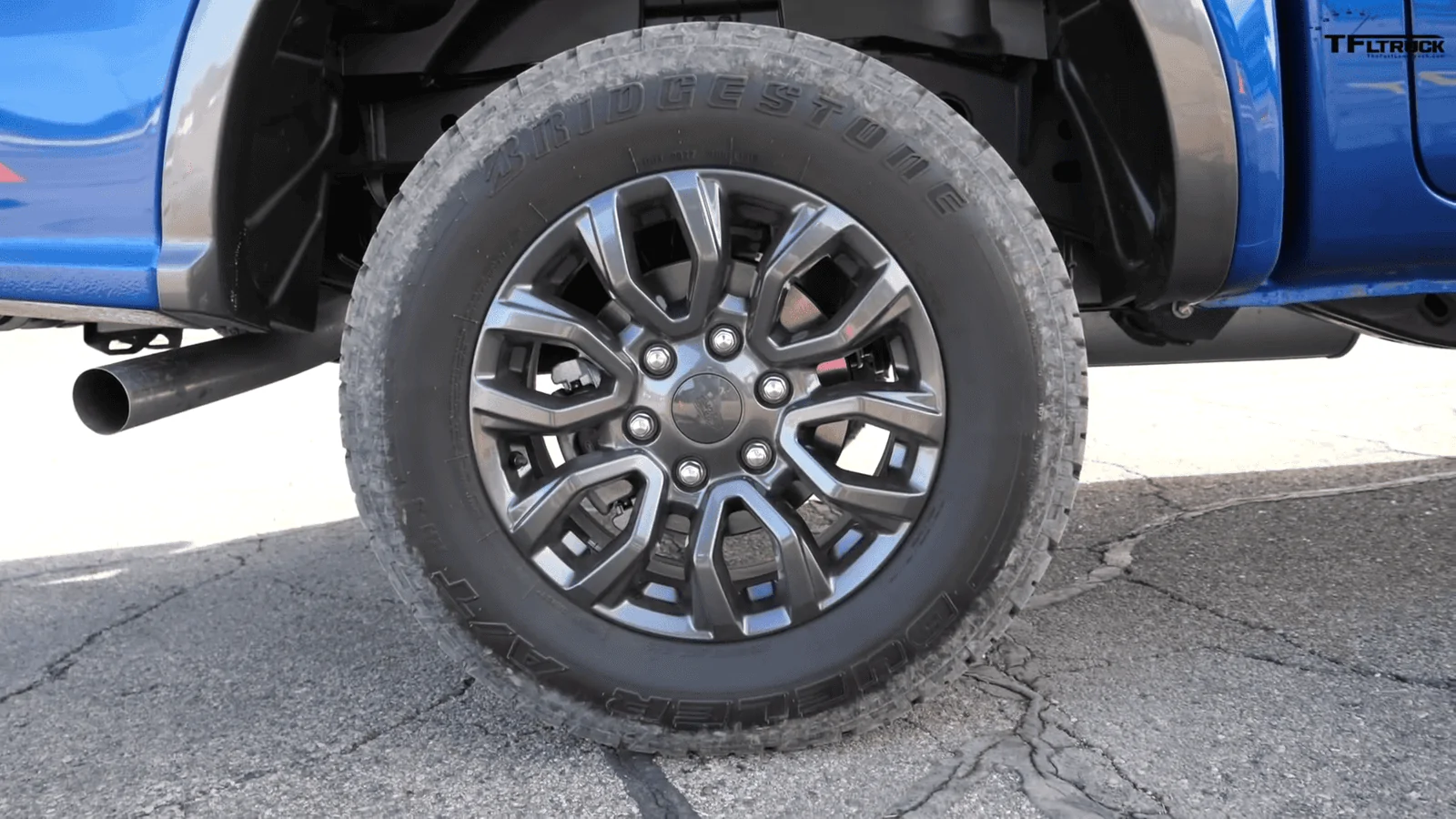

Possibly Bridgestone Dueler A/T on 4x4 Rangers according to 11:10 mark from Here is Why the new 2019 Ford Ranger Could Outsell the Chevy Colorado & Toyota Tacoma
Here is Why the new 2019 Ford Ranger Could Outsell the Chevy Colorado & Toyota Tacoma 11-17.png
