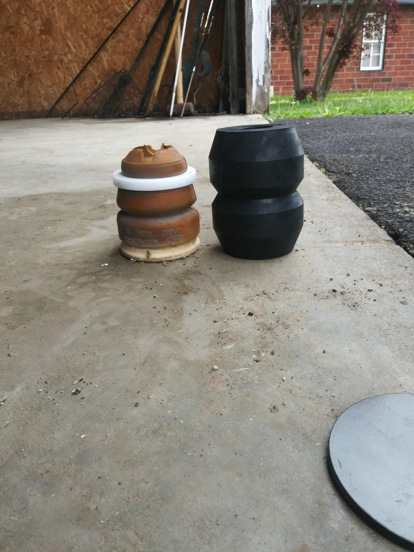

Great thread about truck campers. I just bought an SS500 from palomino that's being delivered today. I can't see going over 1400lbs fully geared up and the truck is rated to haul 1840#'s.
I did add Timbrens in lieu of the factory leaf spring stops. From what I saw, that should reduce or eliminate any sway and sagging. I was going to go with airbags, but as a truck driver, I know that eventually they will fail (and not when mt).
I will say this about the factory stops. They are NOT bolted to the frame. The bracket is, but the rubber spring is pressed into it and can be pulled out by hand (found that out when removing them, frankly am glad they're gone). The Timbren is bolted to the frame through the spring, it can't go anywhere. Plus they're rated for 5000#'s and are bigger so they'll engage the spring sooner, yet still ride above it when MT.

My question is how do you know the frame can support being actively loaded by the Timbren in the area of the bumpstop? A bumpstop is a momentary thing... not a supplemental support.
