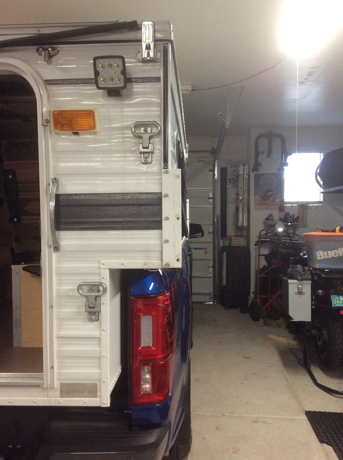

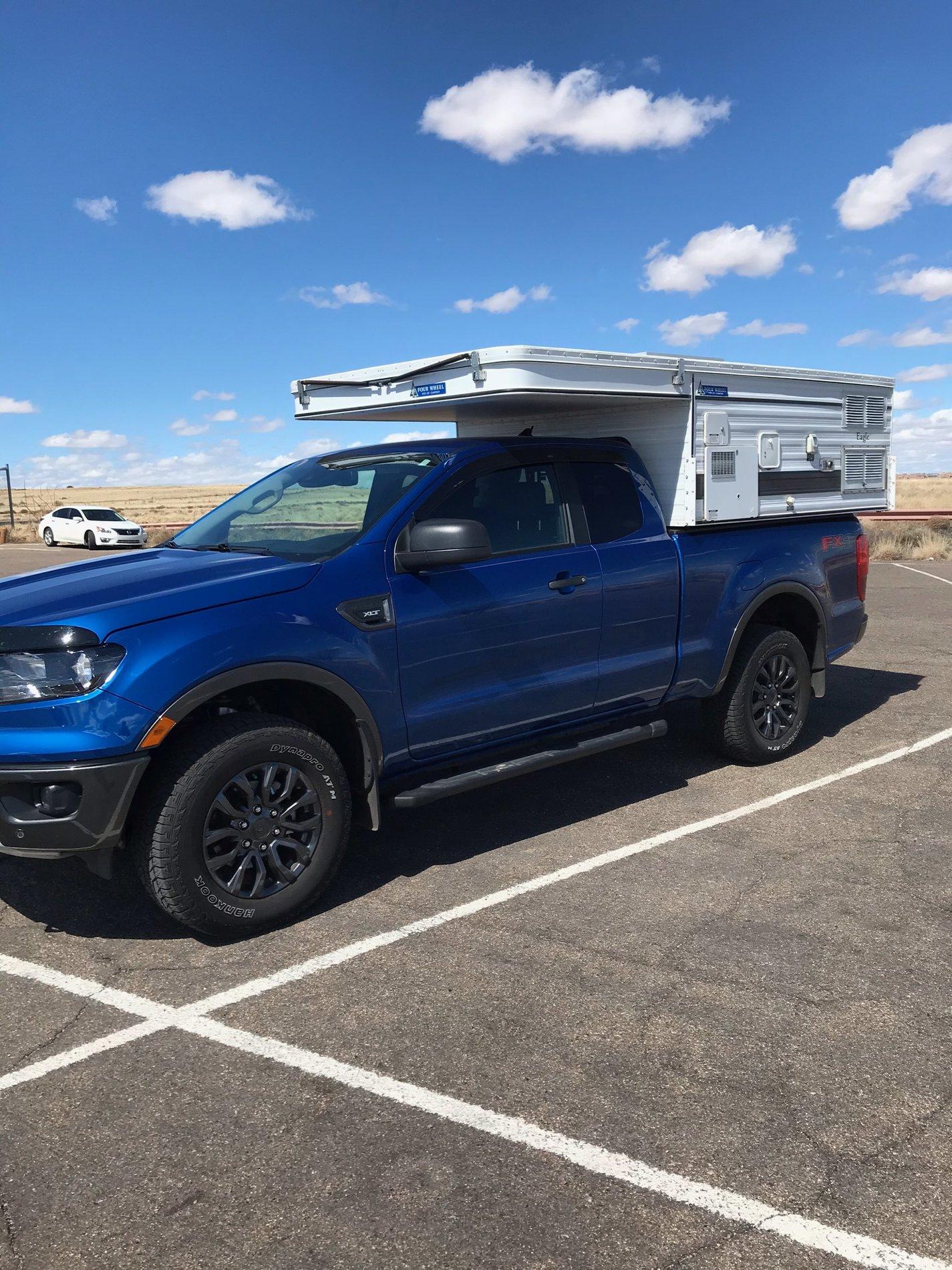

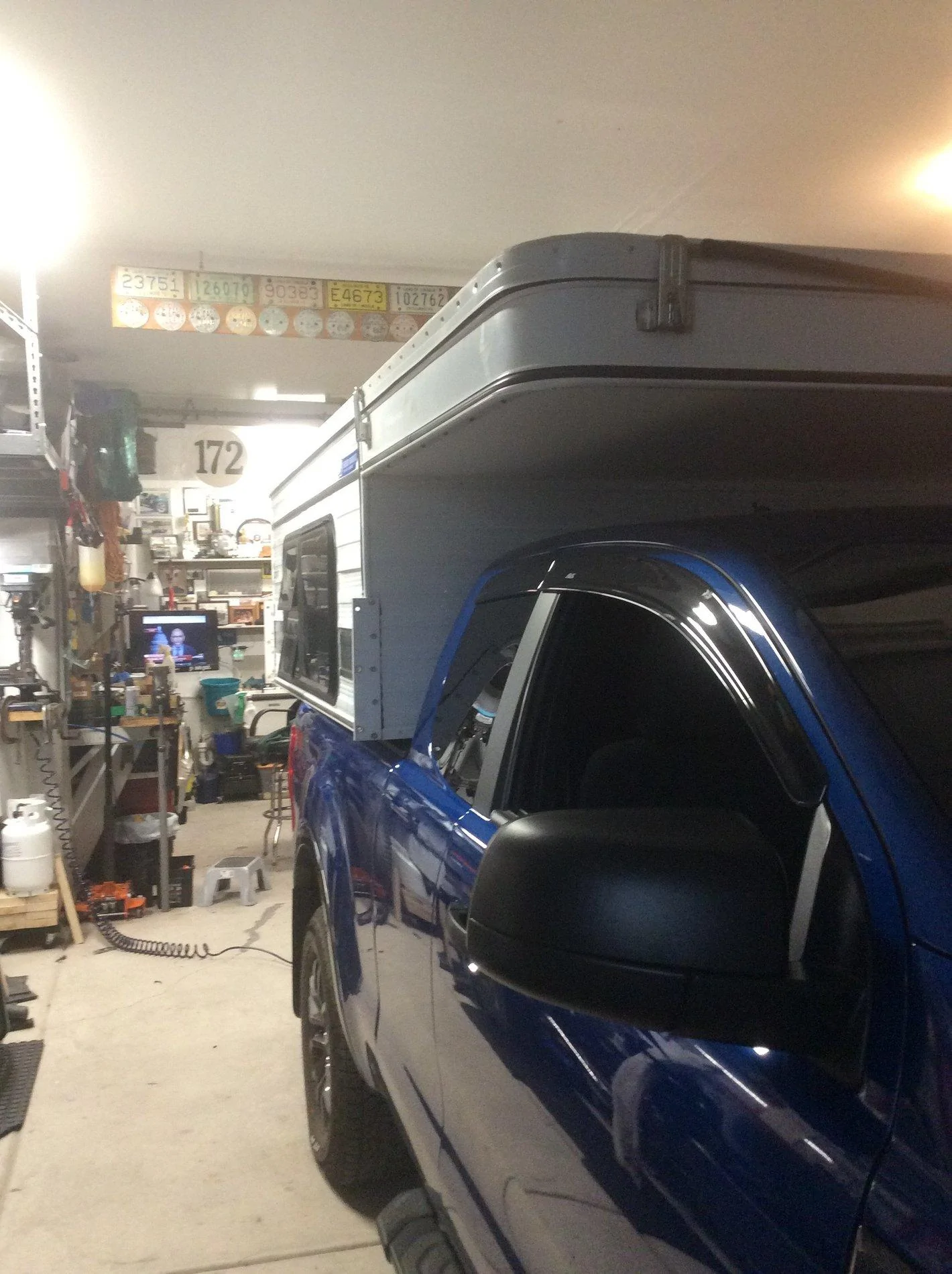

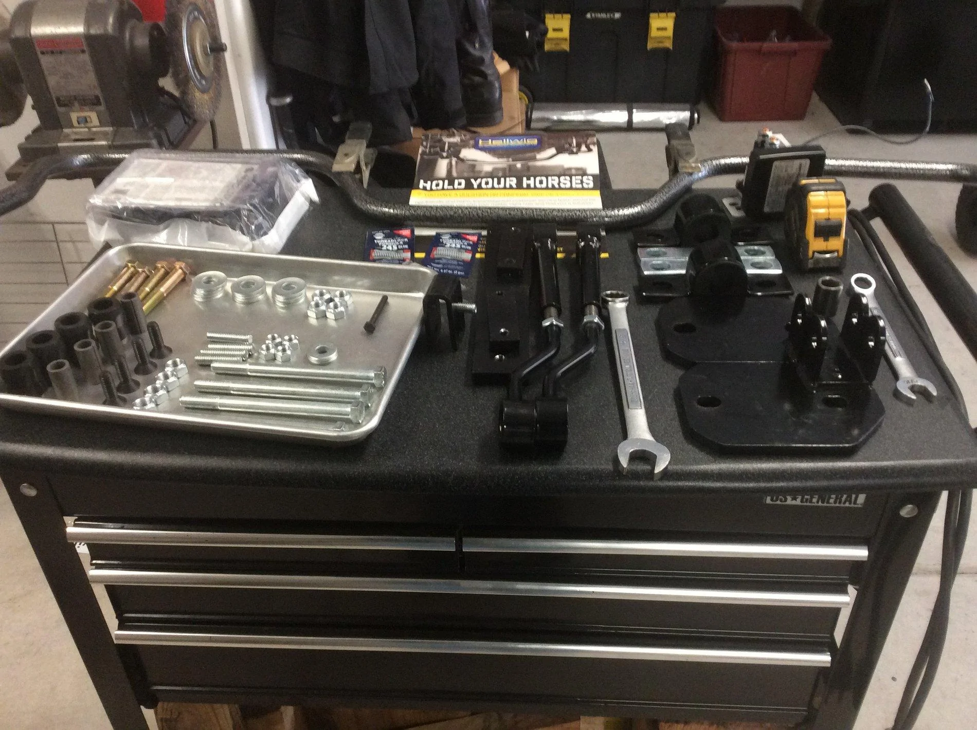

I mounted a used ‘14 Eagle FWC on my Ranger with Hellwig rear sway bar set to max and Firestone air bags set 35 drivers side and 30 on the right. Ride is much better with sway bar. Next will be 265/70/17 cooper at3 tires.
Someone mention the height of the new bed, I pick up a tri-fold ramp from HB and made some light weight stay to make up the difference .
My gross with 2 adults, 20lbs of propane, full tank of fuel and a fully kitted Eagle is 6100 lbs.

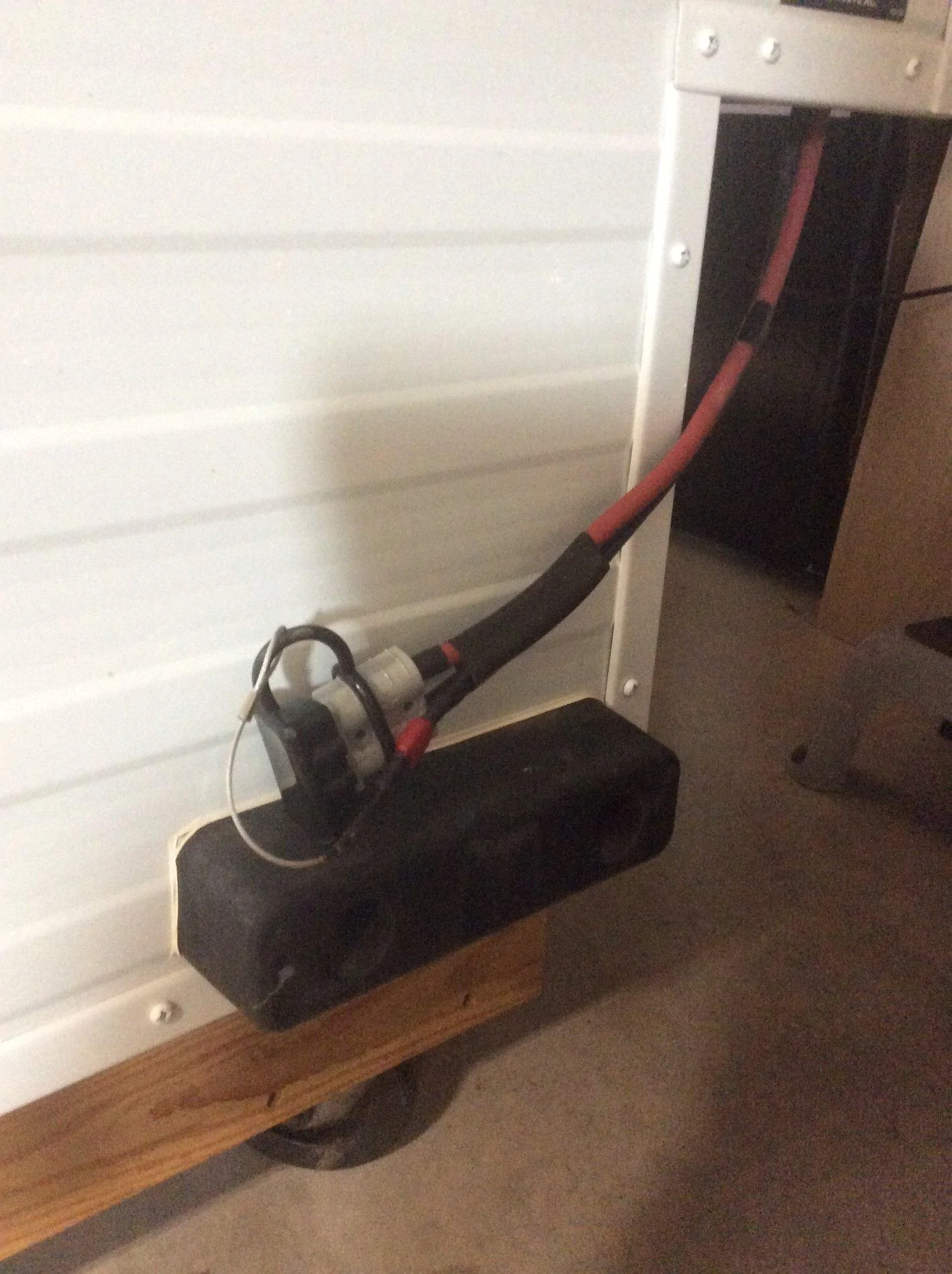

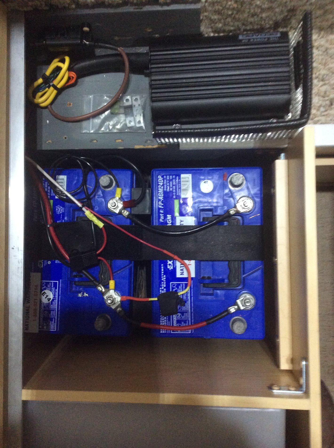

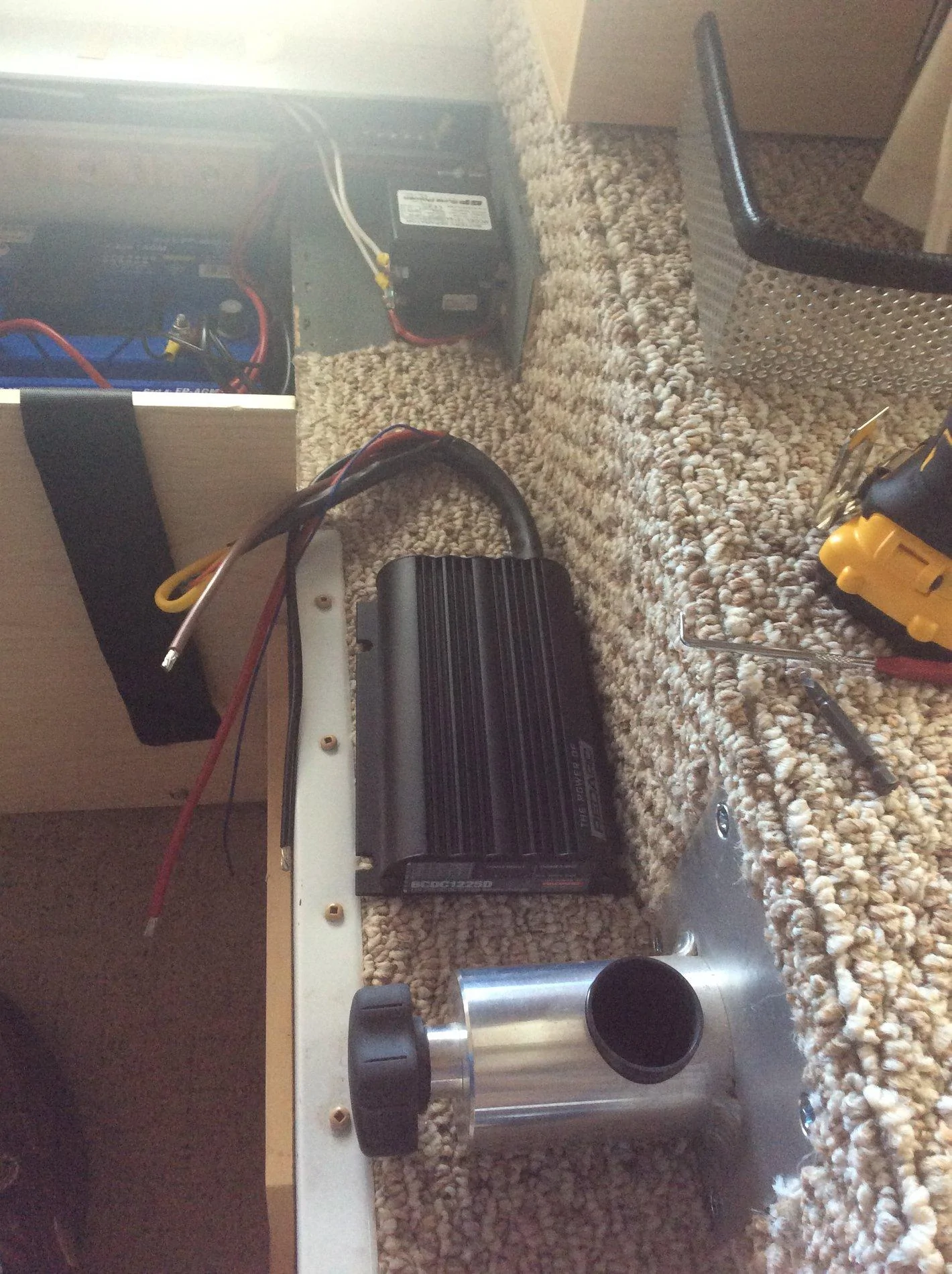

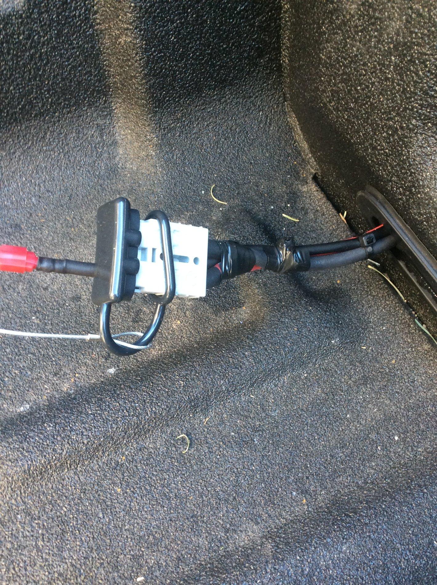

I also added a Redarc charger to work with the Ranger alt.
Over on the gross by 50lbs but under on the axles, but over is over.

I like this, but am not familiar with it. Could you please post some pictures of the inside. Also, if it let's up, could you post some pictures of it inside & out? Thanks! Might be something I would like to get. :like:
