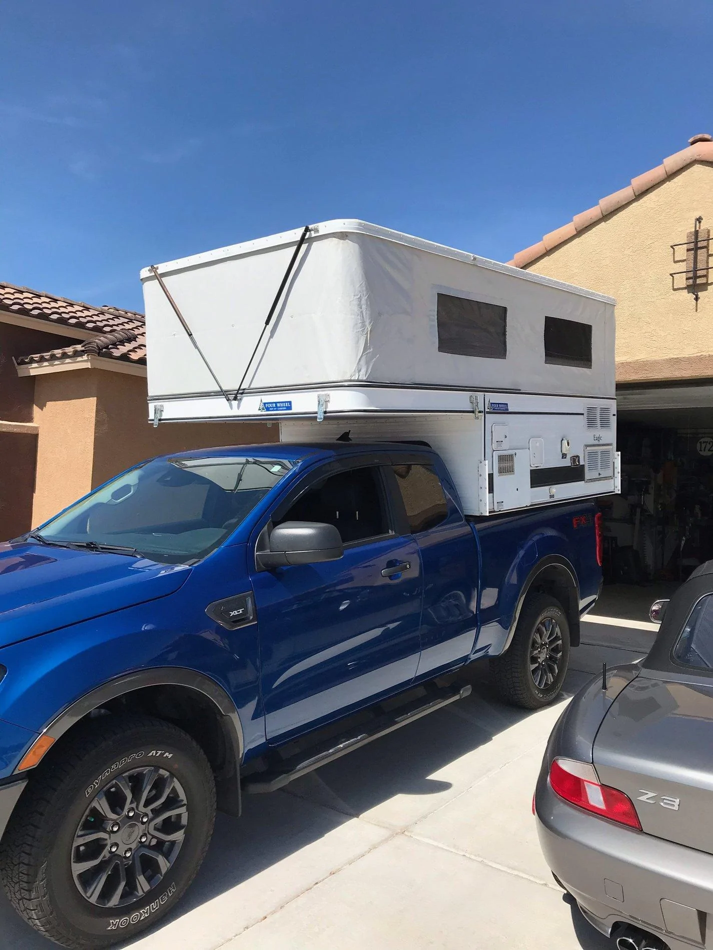

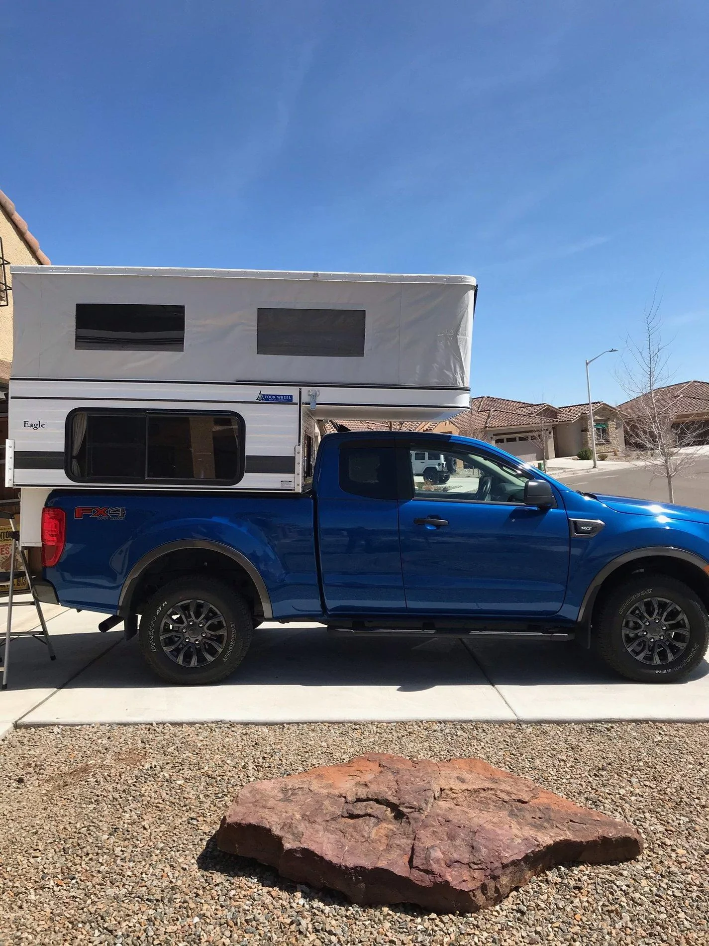

I mounted a used ‘14 Eagle FWC on my Ranger with Hellwig rear sway bar set to max and Firestone air bags set 35 drivers side and 30 on the right. Ride is much better with sway bar. Next will be 265/70/17 cooper at3 tires.

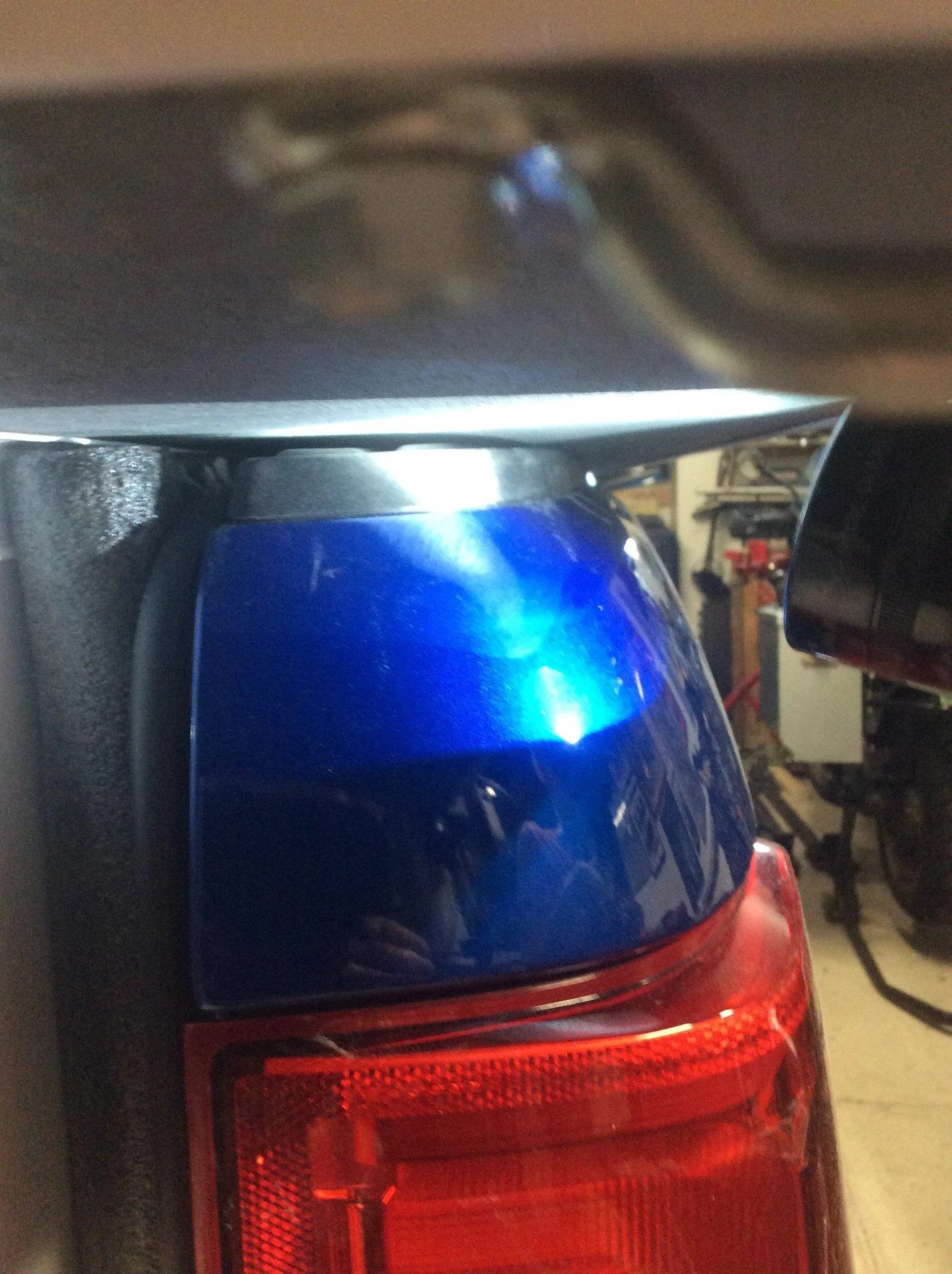

Someone mention the height of the new bed, I pick up a tri-fold ramp from HB and made some light weight stay to make up the difference .
My gross with 2 adults, 20lbs of propane, full tank of fuel and a fully kitted Eagle is 6100 lbs.

The Eagle is not in production any more but hey are around used, they are 69” wide and is perfect on the new Ranger

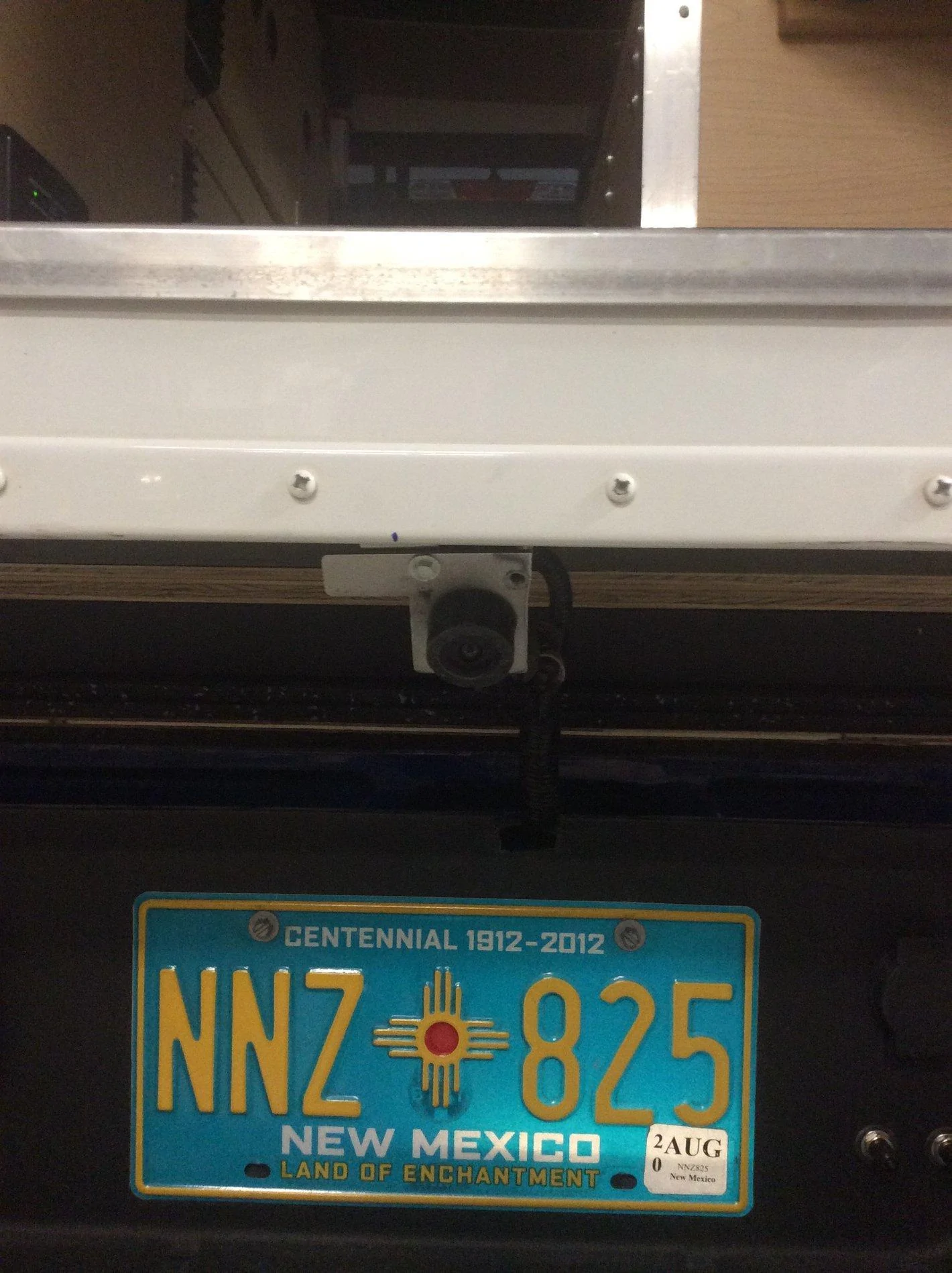

We have not yet installed a substitute camera - I'm waiting for the aftermarket to catch up and make one specifically for the Ranger. The current solution available is a more generic one-size-fits-all camera in a housing, which I'd rather not pursue.

I used the stock camera from the tailgate to save some time and money.

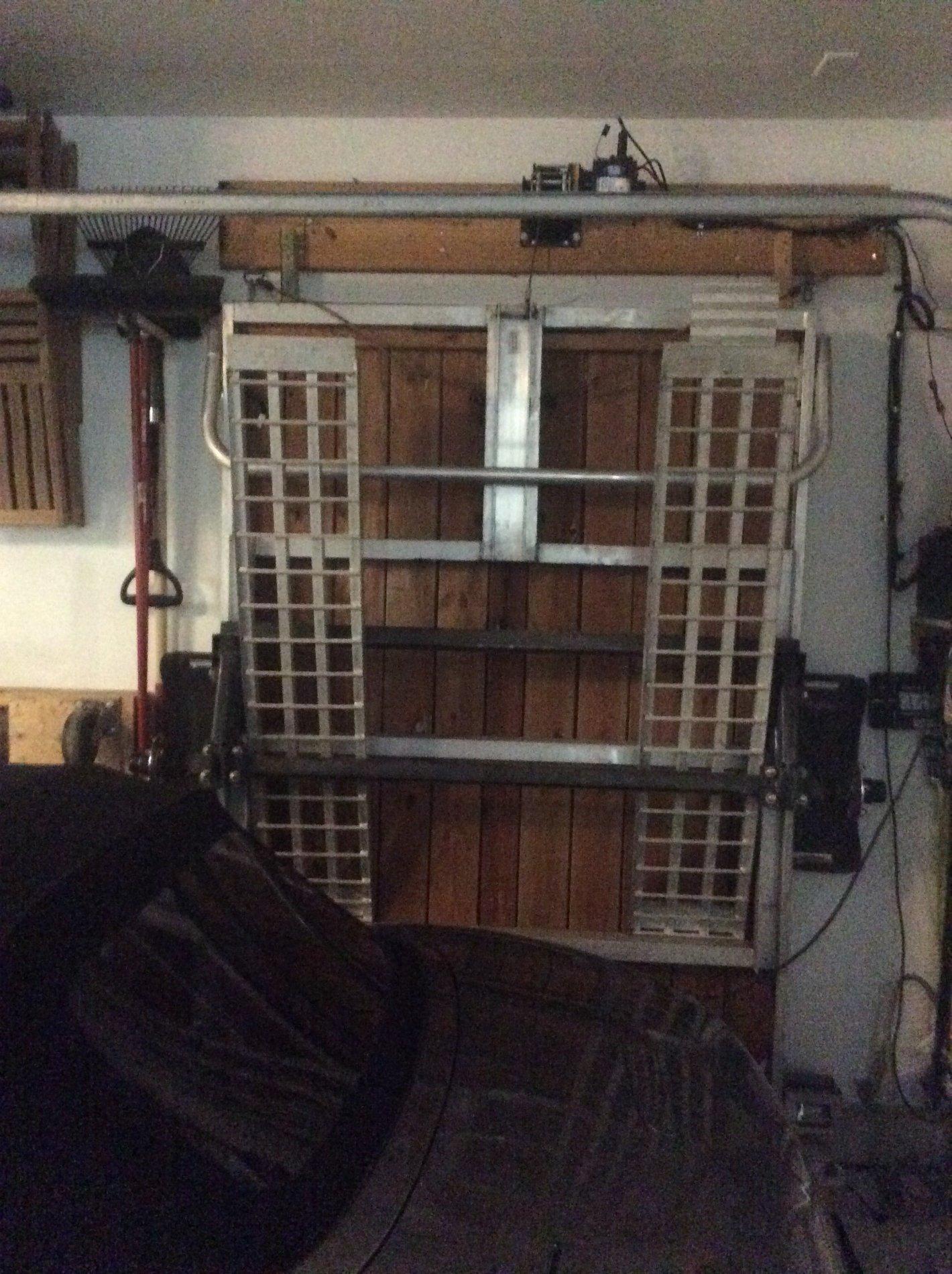

On the bottom of the camper are risers running the width (5) on each I cut up the ramps to make up 2.5 “ in the height of the bed walls so weight is even on the bed floor and a very close clearance on bed walls

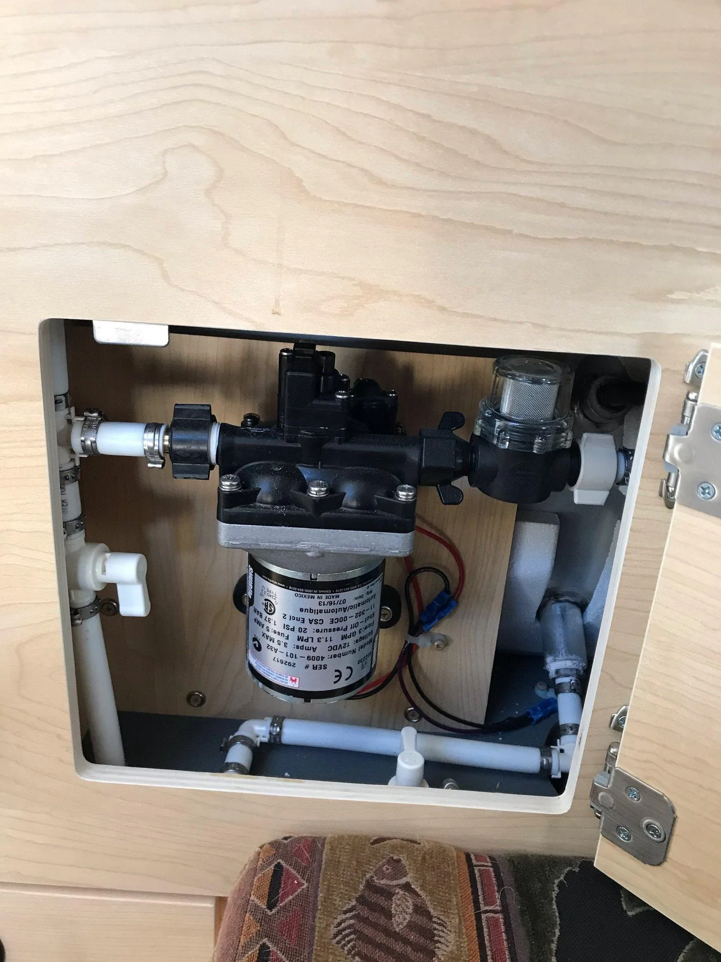

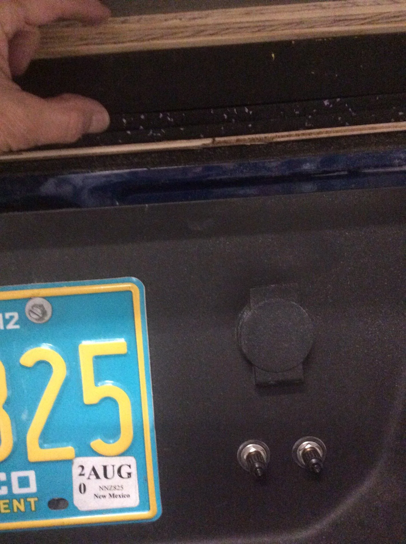

Are the (2) schrader valve fittings located near the license plate for air bags?

I can take it off with jacks ,set it on a dolly I made but I have utility trailer If needed to haul any thing, an old motorcycle and two seater for date nite.

The dolly is platform I made from an old motorcycle work table and casters from the flee market .Trailer is an 8x5 from Northern that I use for caring extra weight without adding to truck gross, also the Eagle fits on there perfect. All stores in my 2.5 garage to void any storage cost.
