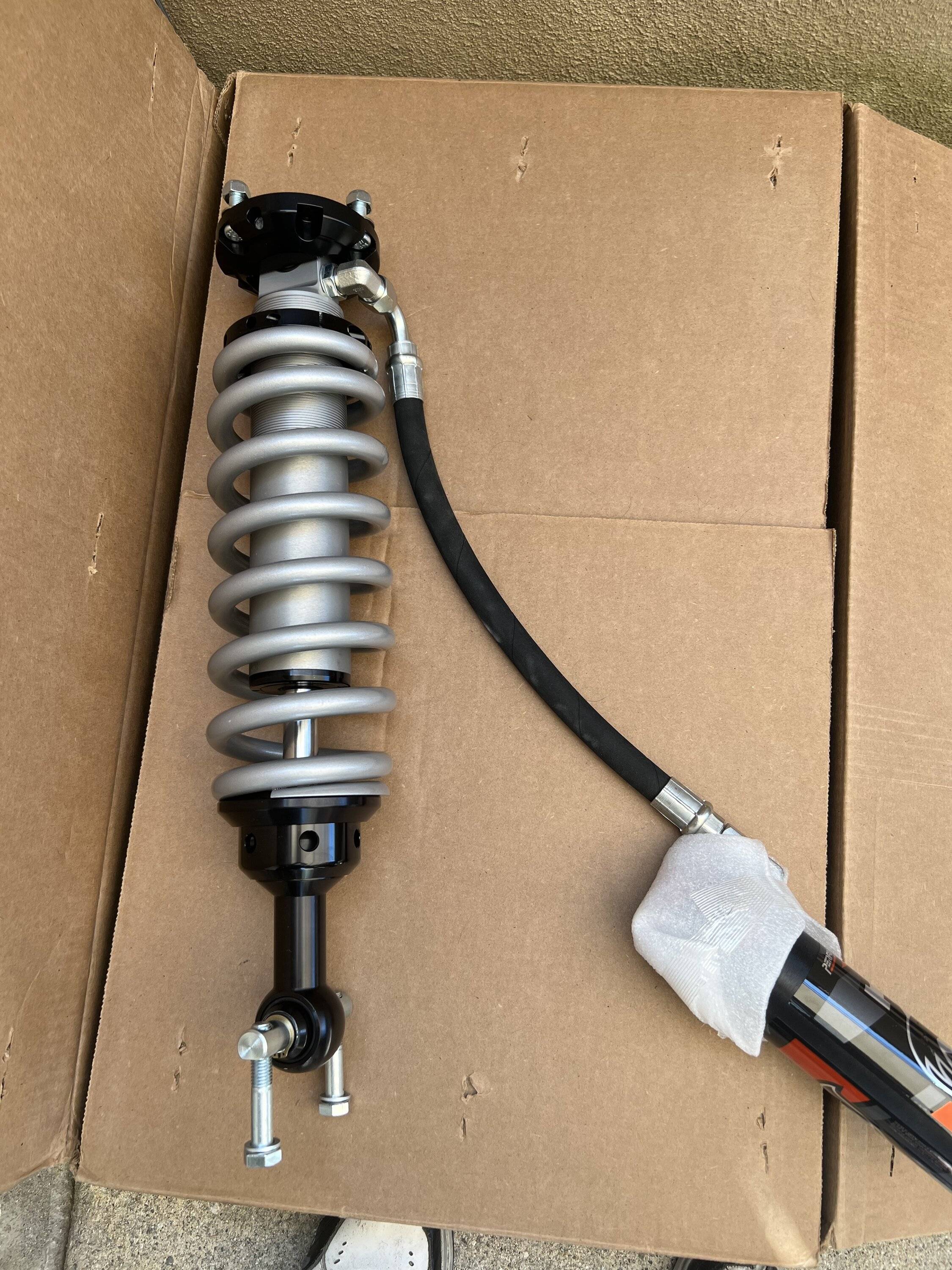

Question : if I would like to adjust the collar on the coil about one or so turns, do I need to compress the coil springs with a coil spring compression tool? Or …… just loosen that one bolt on the collar and put a spanner tool in there and adjust. Thanks!
D Fresh
Dec 10, 2020
6,272
13,570
Milkman
Things will always go easier compressing the springs just enough to turn freely. Won’t gaul threads doing it that way.
Nailed as usual.
You don't have to. But compressing the spring will make it much easier/safer.

Thank you guys! On my way to AutoZone to rent- borrow a spring compressor, thank you guys again!

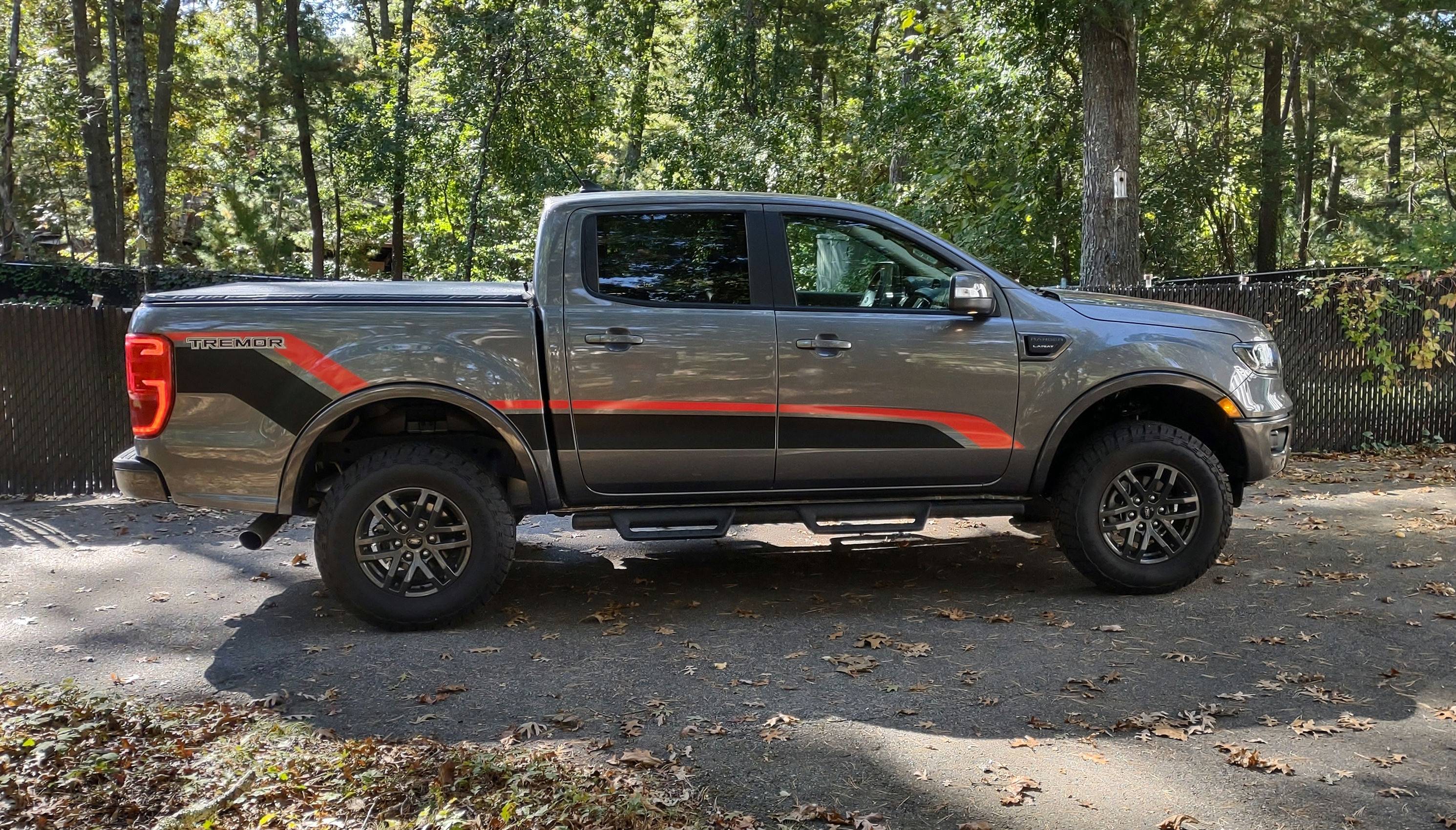

I've read the Tremor version with the Fox shocks comes leveled from the factory. Can anyone here confirm that?
Dgc333
Aug 24, 2021
1,742
4,114
21 Ranger Lariat
It is closer but not level. I used a 1" leveling spacer (1/2" thick) to get mine level.
