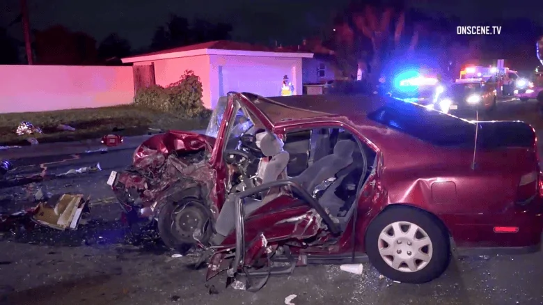

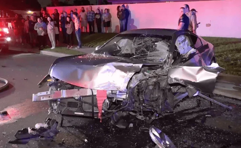

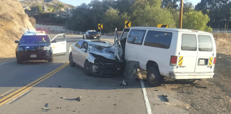

IMO the rarity of conditions that would have to come together to cause the collision which would drive the wheel into the cab, is almost only possibly in a crash lab. It could happen and undoubtedly has, but incredibly rare I think. Also an impact of that magnitude, would likely be so devastating few would survive anyway.
With that said, I know I would be 100% liable for damages that occurred as a result of any safety equipment I remove.
That's patently false. I just searched "head-on collision" on Google and these were in the top 100 results. You can see the difference between a car rated good in the IIHS small-overlap and one that wasn't designed for the test:
Did you search how many head on collisions happen?
What percentage of accidents are head on?
What percentage of head-on collisons have small-over-lap impact?
What percentage of accidents have wheel to cab intrusion?
Do you understand what IMO (In My Opinion) means?
Do you understand "rare, but it can happen"?
And lastly "Also an impact of that magnitude, would likely be so devastating few would survive anyway." How many of those crashes would not have ended in fatalities even with better small-overlap protection?
