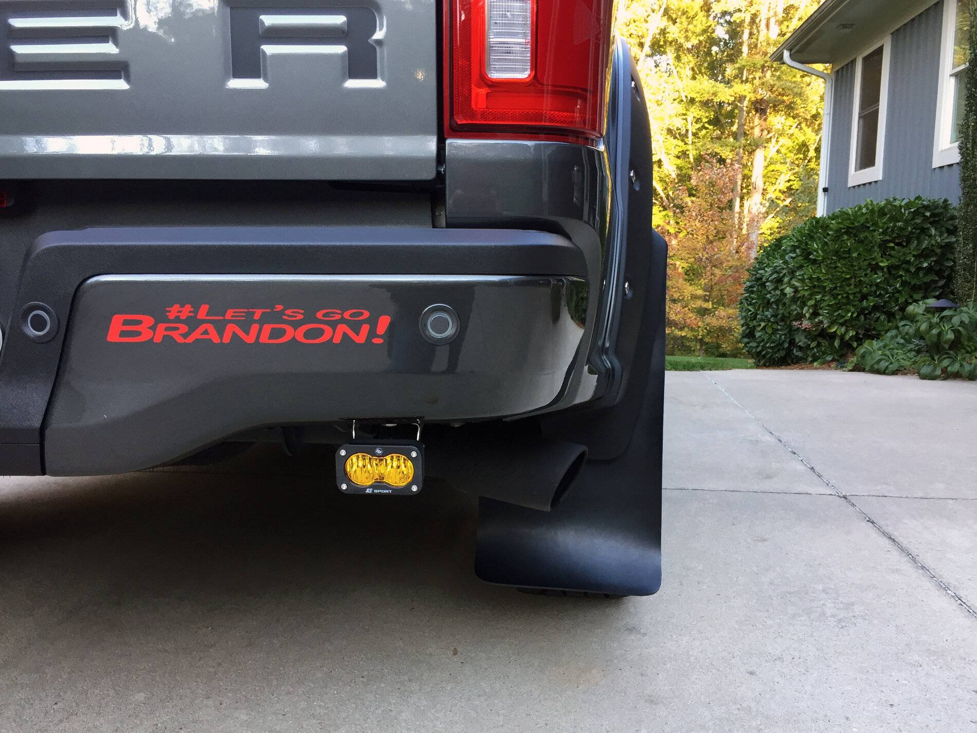

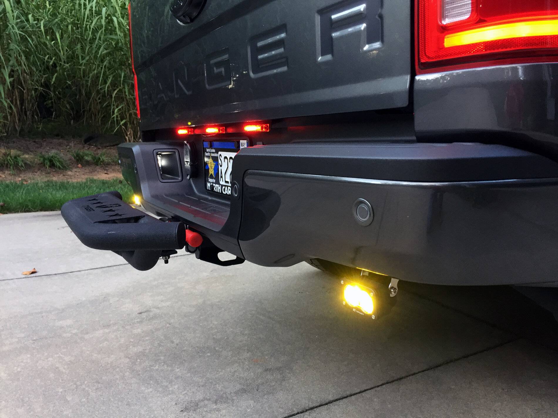

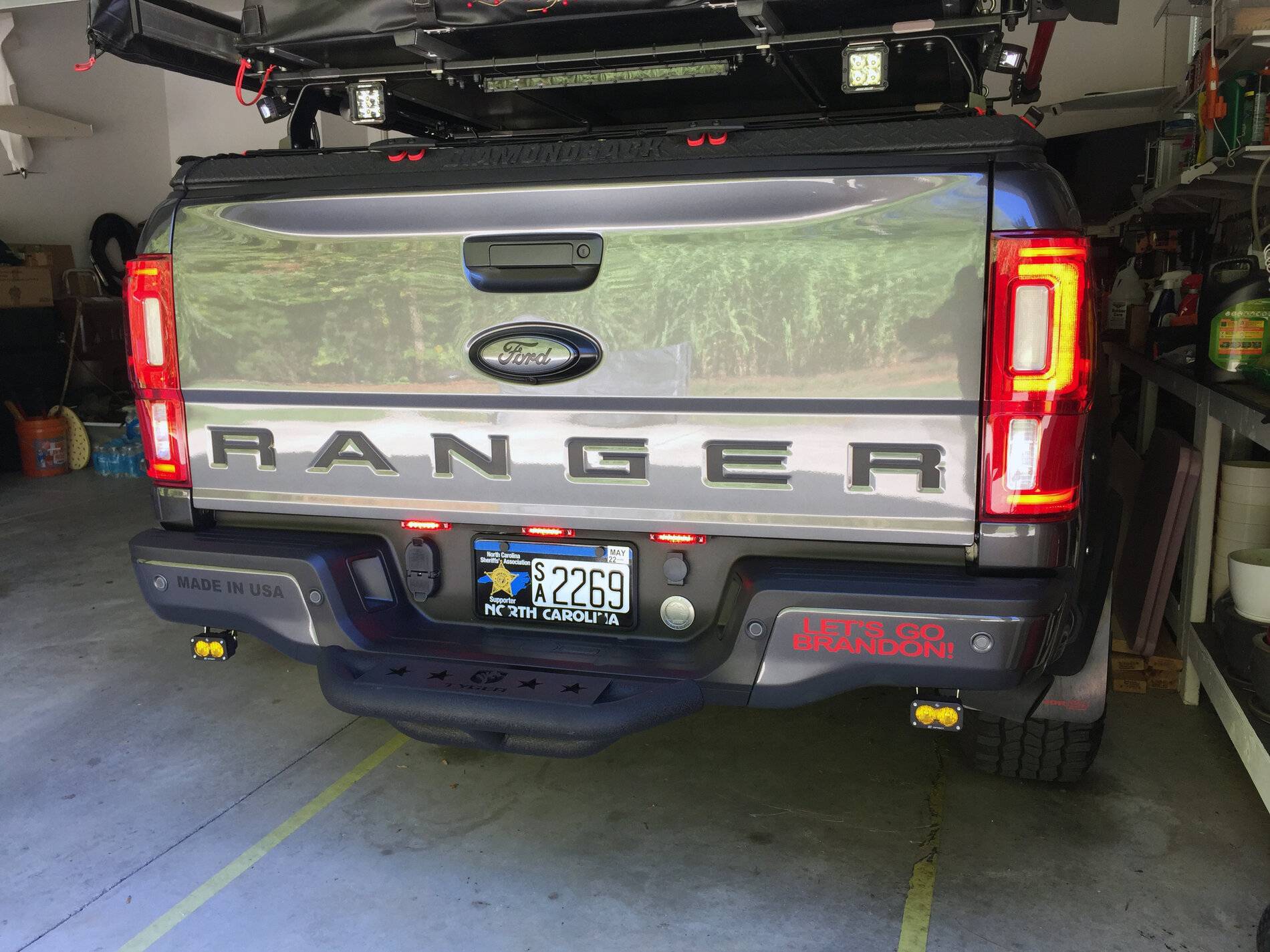

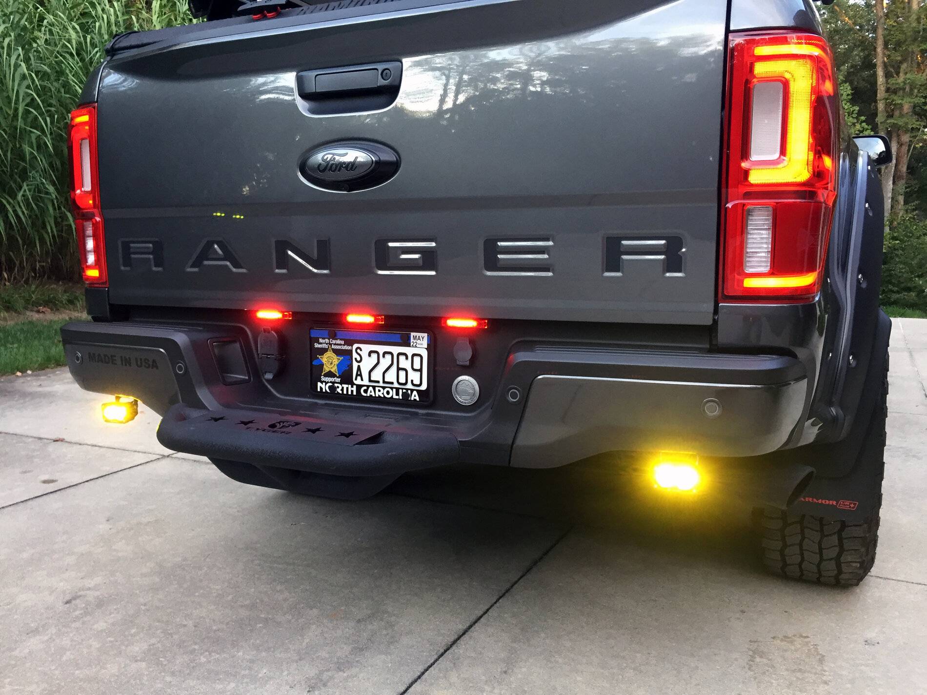

Mystery solved @AzScorpion ...Got some amber lens replacement for the S1 and S2...I like it...compliments the new fogs... ?

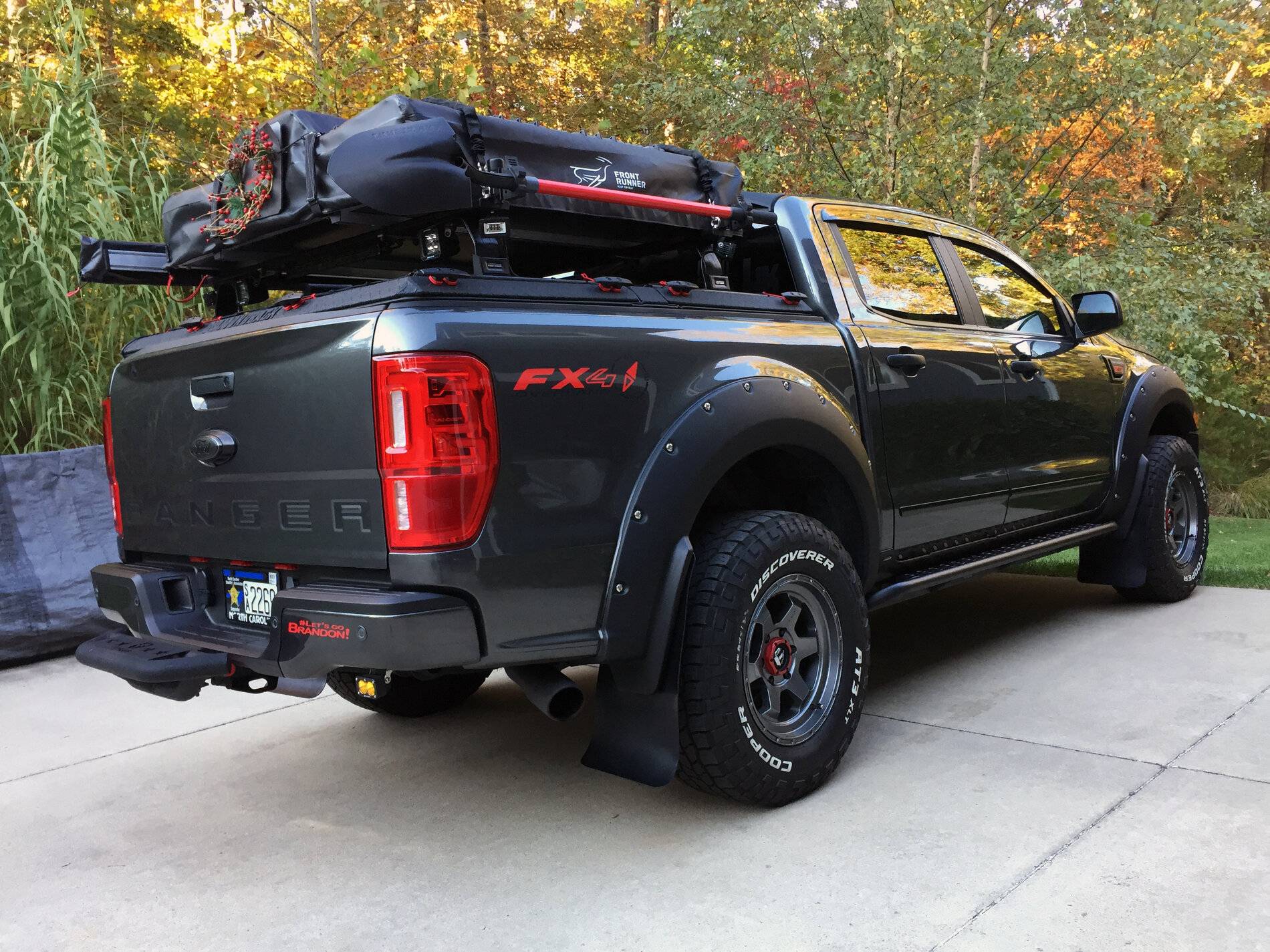

Safari Flaps installed...Rally Armor were too short for a lifted truck so I made a custom set with 60A Neoprene rubber that are 1" wider and 5" longer (12" x 24")...:cool:

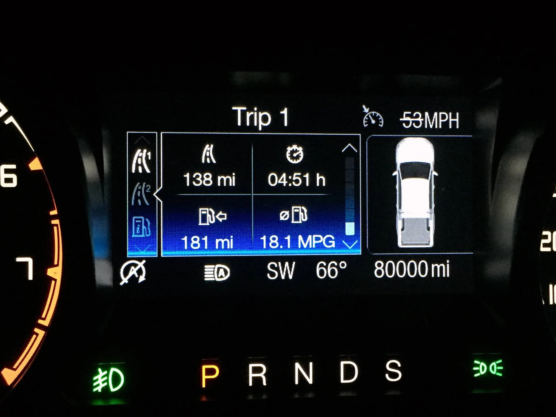

Can't find my Ranger in the parking lot? I have a app for that...?
