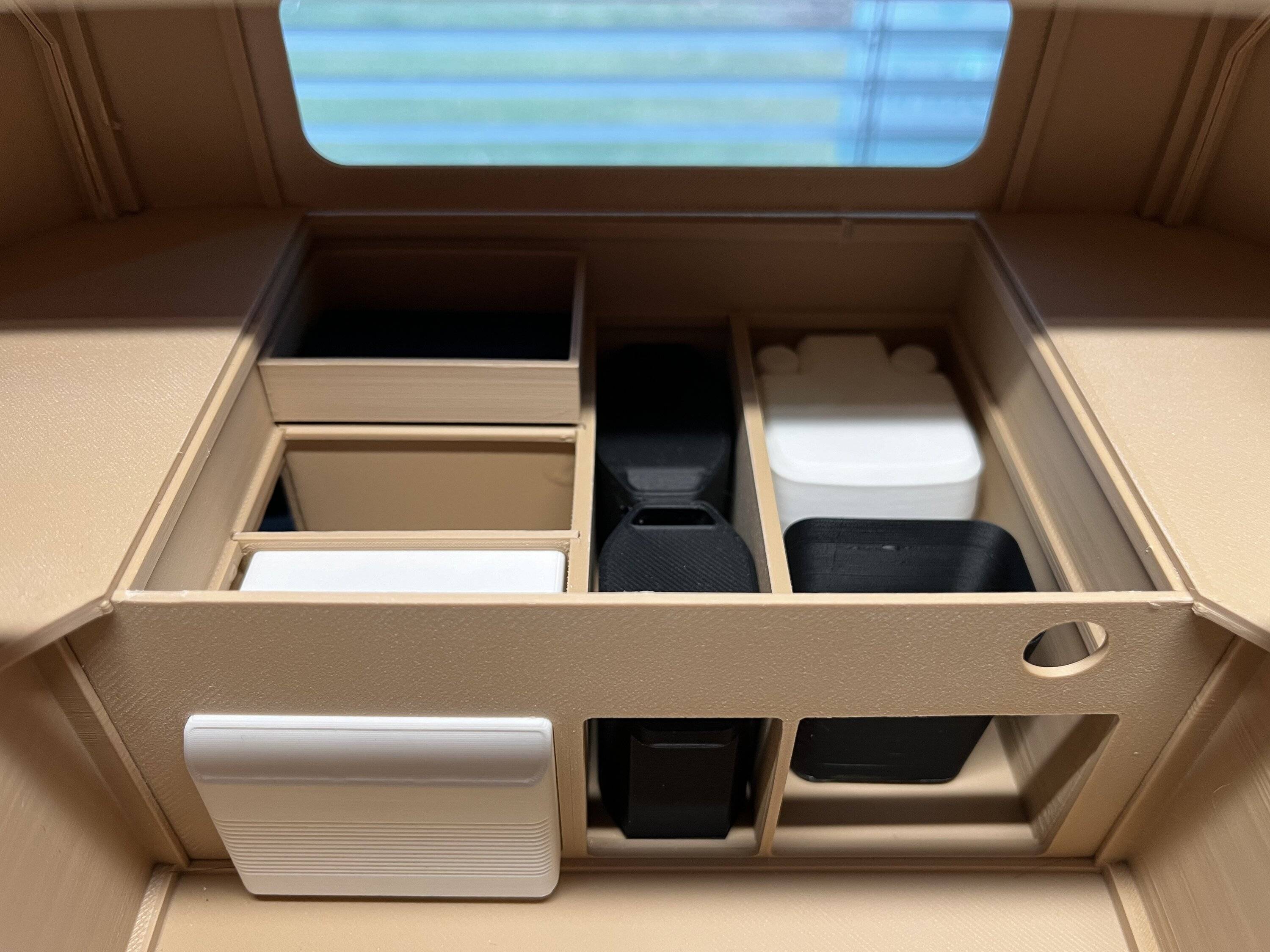

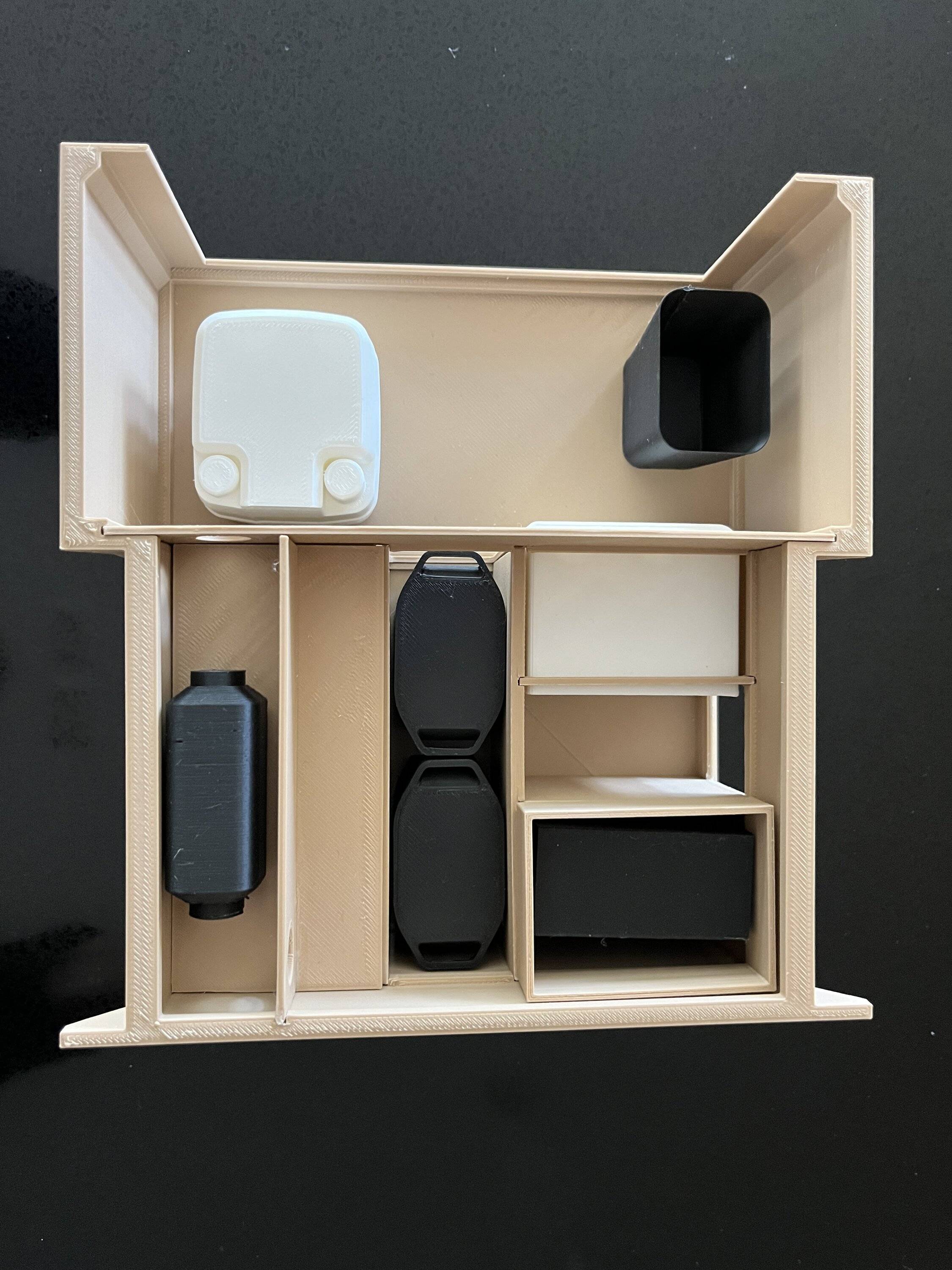

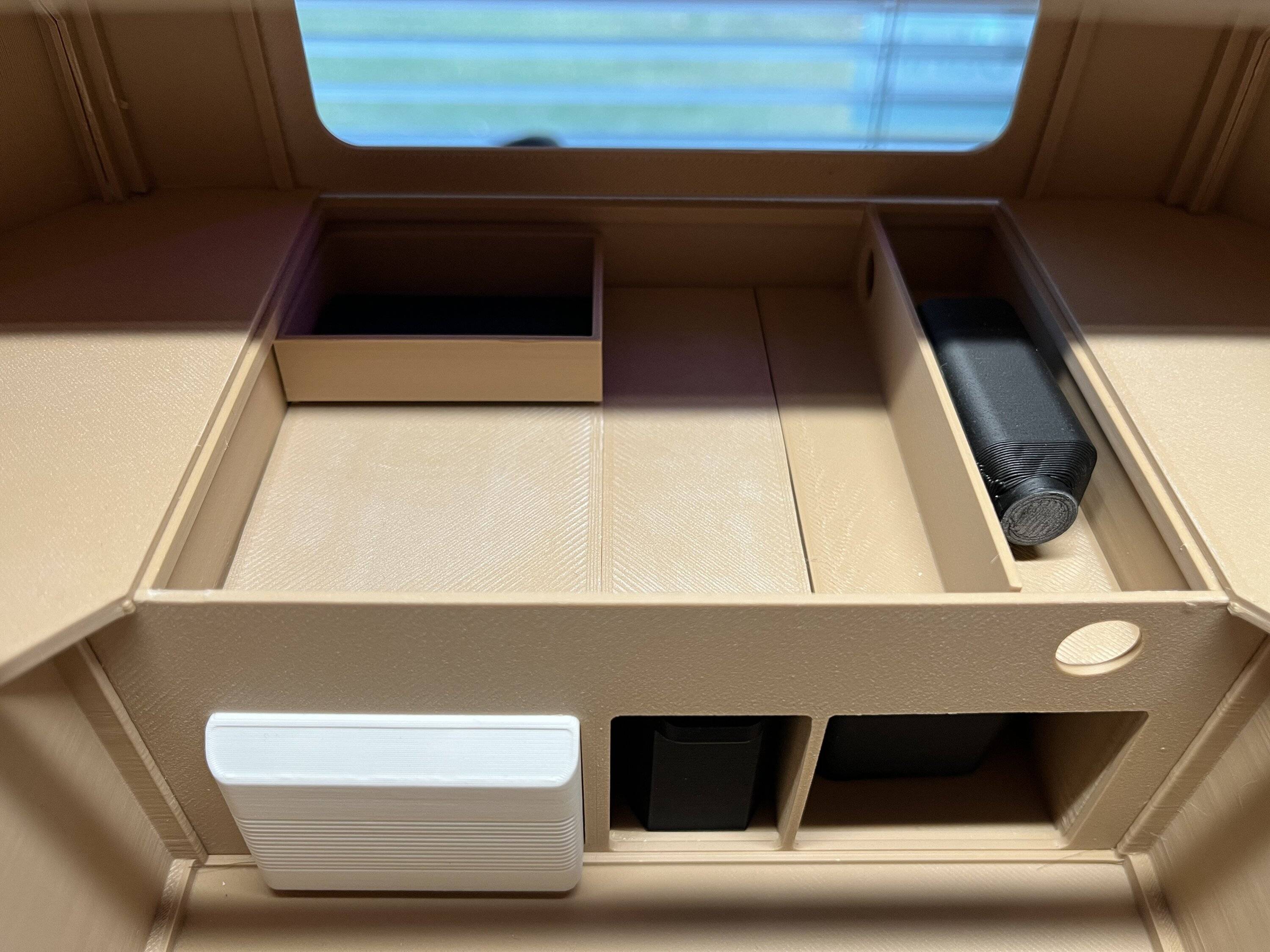

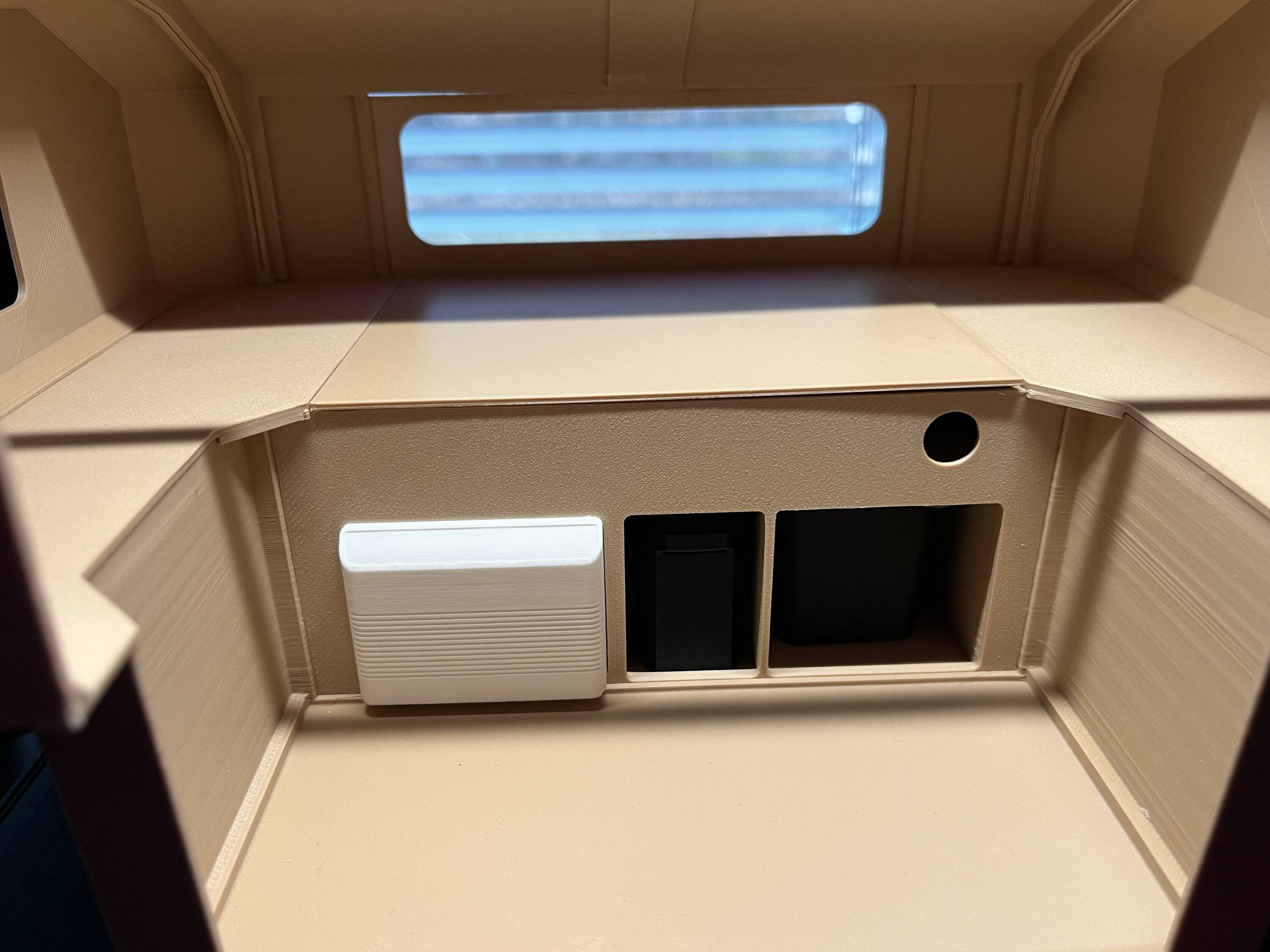

Peek into the tiny home...storage cover plates off revealing the AC, subwoofer, Ecoflow batteries, porta potty and waste basket...
Second layer serves as clothing/supply storage......diesel heater (black object on the right) pumps heated air through round vent (plumbing not shown) by sitting area and drawing in recirculating air from center battery compartment, up through the sub-woofer compartment, then over the clothing and back into the return port at the rear...every space gets air circulation...the AC is compartmentalized and sealed from the interior drawing in cool air from the mesh open bottom through the ribbed spacing of the bed liner...hot air is pumped through a separate compartment (area behind the AC above) and exhaust out the side through another mesh vent...

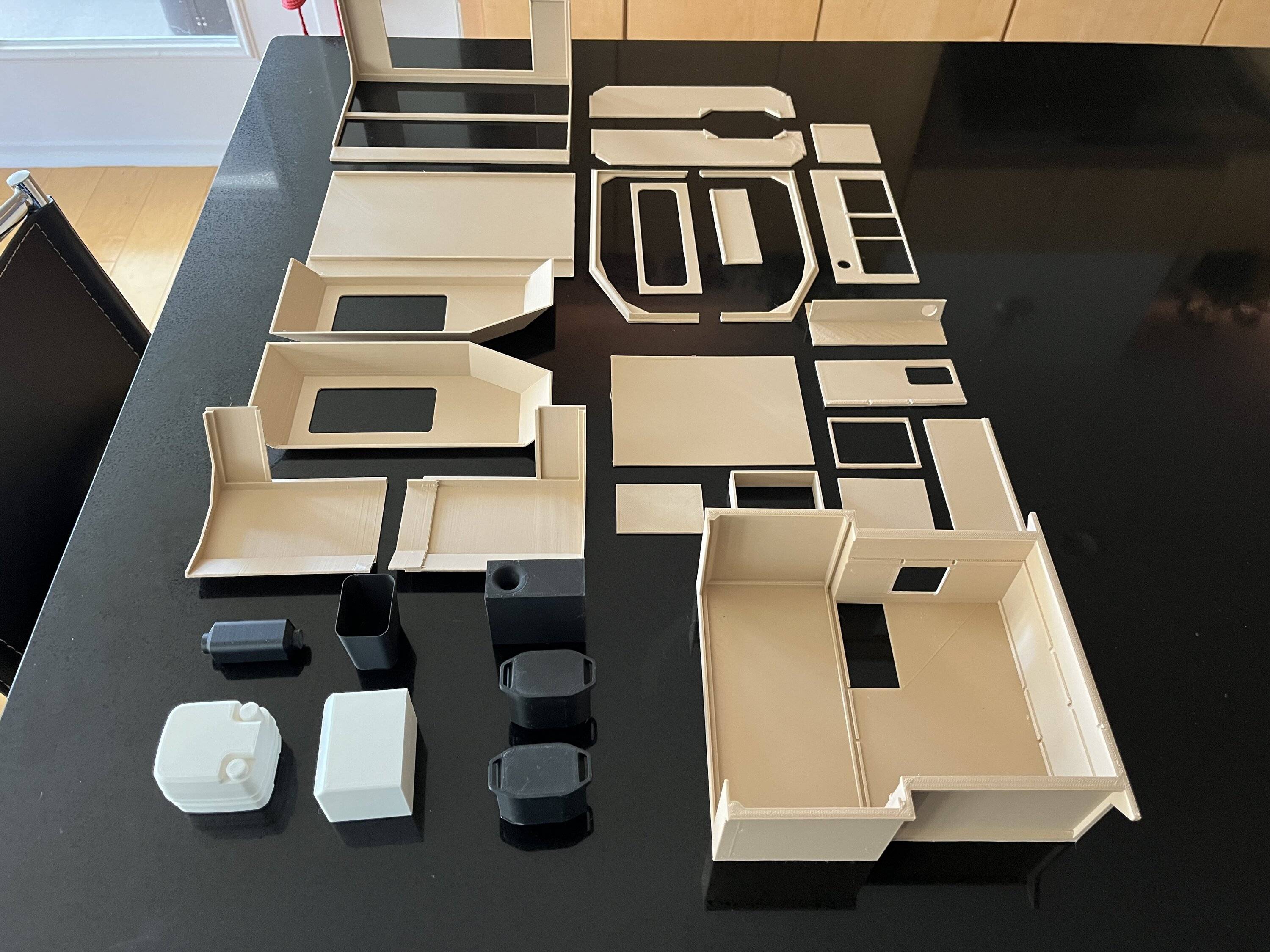

Not the best fit/finish but...all I can expect from a scale 3D printed model...1/8th scale...space feel good...

wow thats a lot in such a small space. so before moving forward do the boys a favor,add the elongated bowl potty. those little square ones and round ones can make you sing soprano if you dont sit down really careful!
