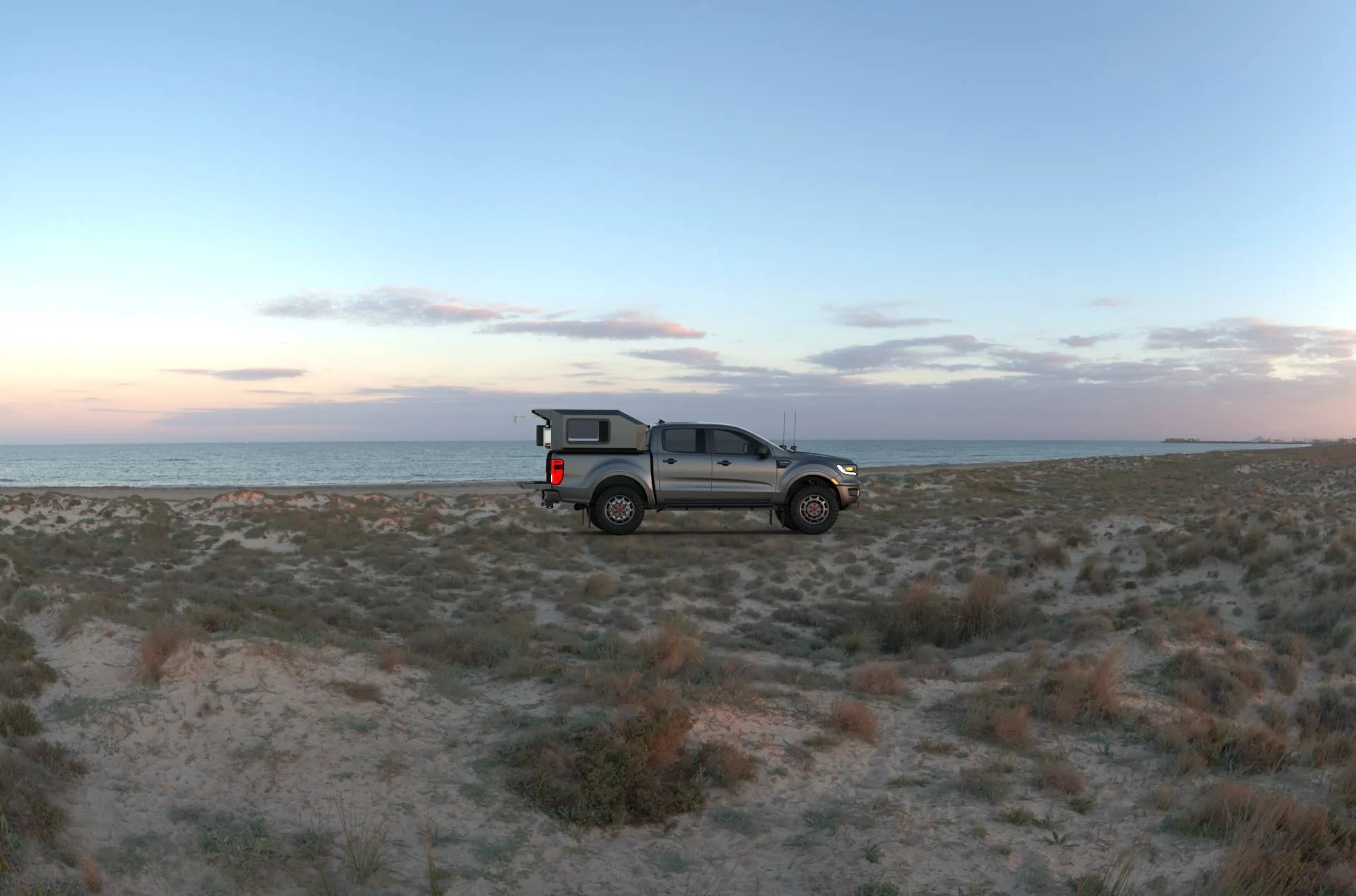

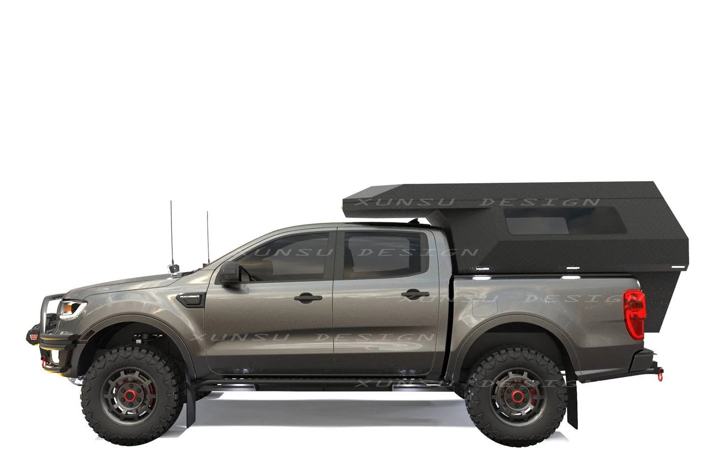

Honest opinion? Design profile leaves a lot to be desired. The best way I can describe it is "looks out of place". Doesn't seem to flow with any particular lines and doesn't look "balanced".
However that is just my opinion.
9,192
28,359
NWO Robot Polisher
I always appreciate your opinion my friend...but for this project, I need to switch hat from "car styling" to "product design"...form follows function is the prime directive...

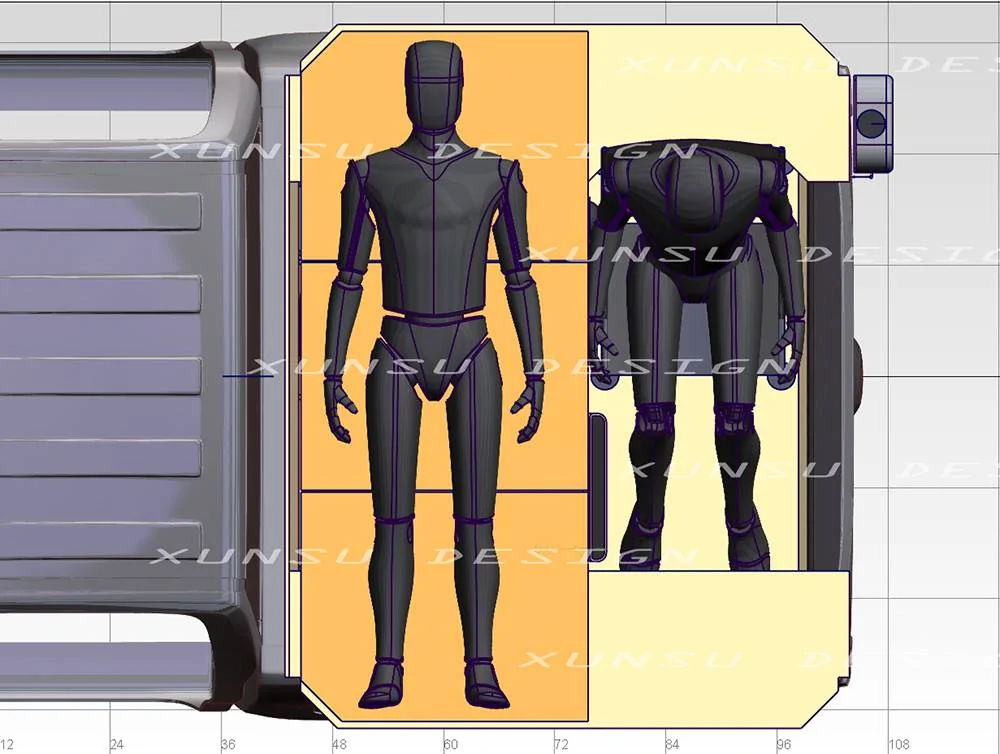

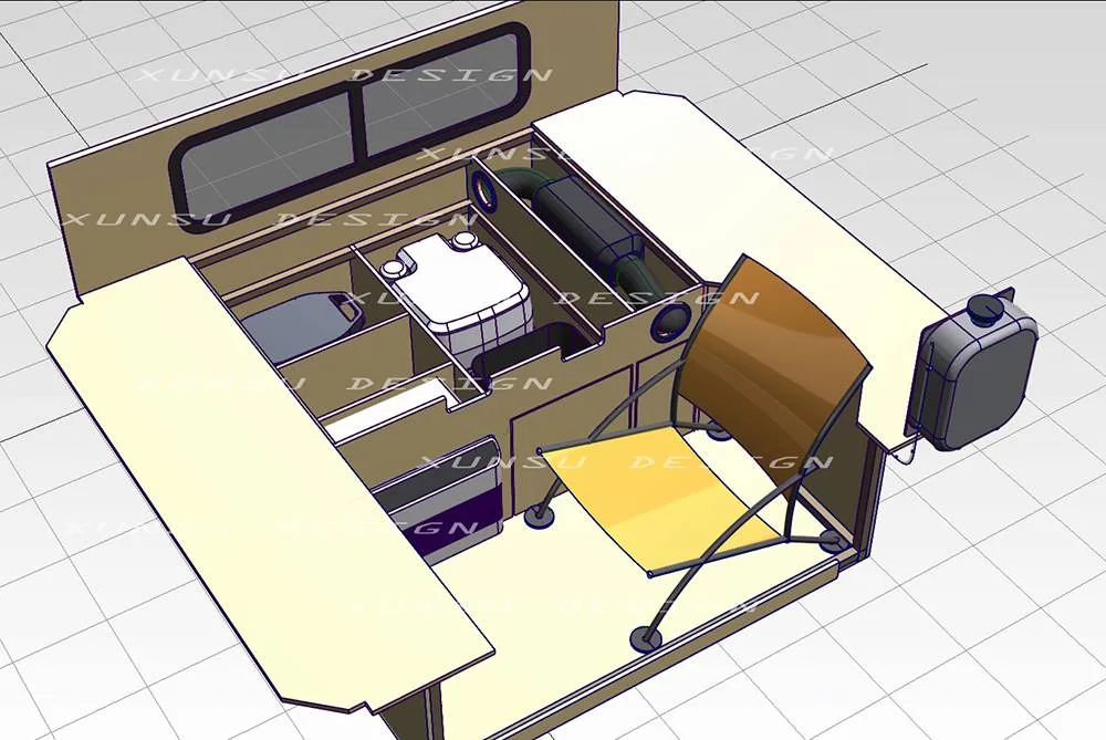

Is that an air tent? Those are very light and strong...not sure if you've read back on my design intent but I'm trying to solve a short bed camping problem that hasn't been 100% addressed out in the market, yet...
1-hard sided
2-sleeps two adults perpendicularly
3-low enough (83") to park in 7' garage door
4-sleeps one but with lounge/work space separate from bed
5-self sufficient, 4 season with AC + diesel heat powered by Ecoflow Delta 2
6-lightweight
Moon Lander is close but too tall to satisfy #3...is clamp on cap design so insulating/sealing bed will be DIY...being low and aero is important to me...

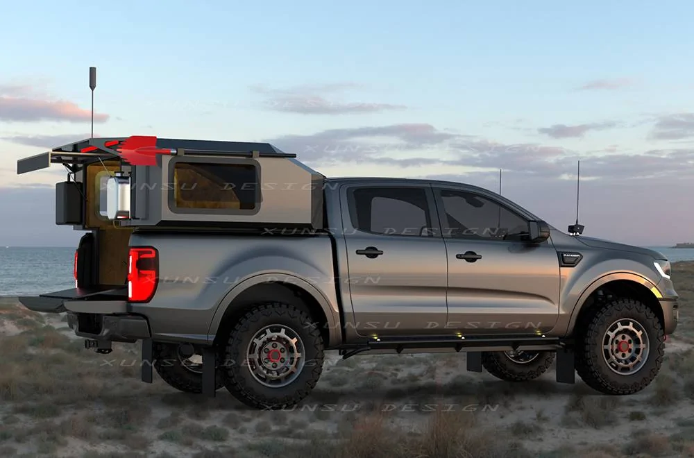

Minimalist comfort...

As I get older, sleeping in a RTT is just as bad as a tent on the ground when you figure in the ladder and setup...rain gets tent wet means packing it away wet...means setting it back up again when home to dry...PIA...I'd prefer to bring along a quick pop up ten with cot than a RTT now...but then again...nothing beats a ready set hard cab set up and that's why I've been working on this project...
BTW...where I'm taking this is on the beach...

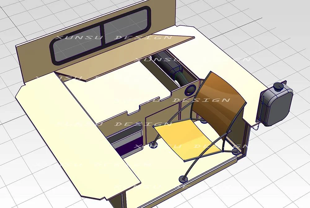

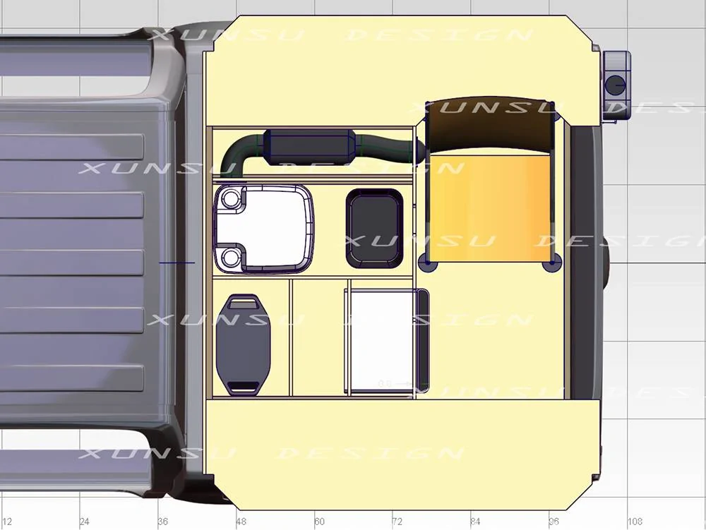

Approximately 35sq feet squeezed in with 1800wh LiPo battery, porta potty, diesel heater, 5K 400watt AC, cloth storage below bed platform, waste basket, cook ware storage under diesel heater, 35" TV fold up, work table for laptop, windows on all sides, an a pair of 130watt thin solar panels on the roof = 260 watt...fridge will stay in the back seat where it is now...

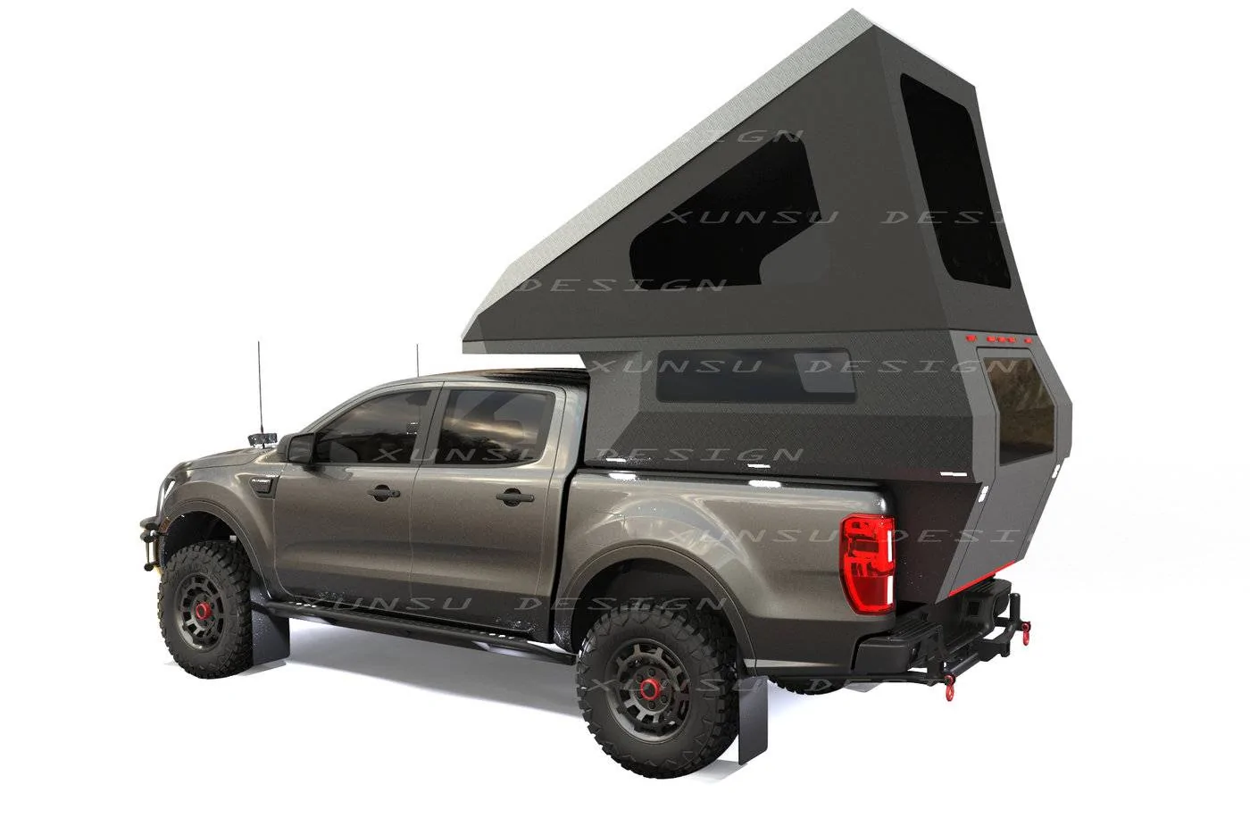

@OFC Ranger this is what I was working on but not going to happen until I get connections with some people with serious fab skills...definitely full CF or composite honeycomb panels...
