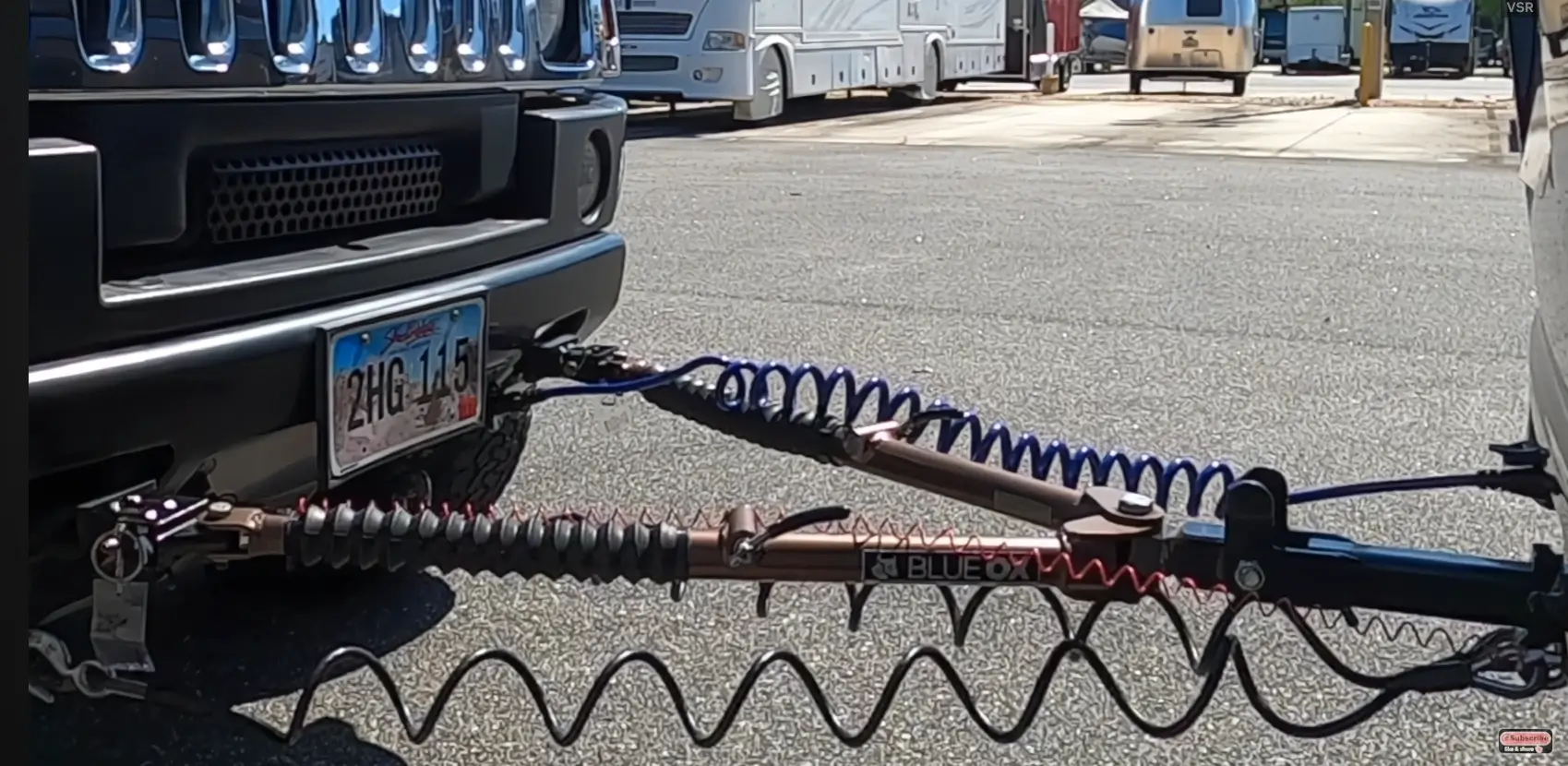

Just curious, what is your towing setup on the front of the Ranger look like?? I have a front tow hitch on the front of my Lariat and often get that message (or a related one) as it can't see around the hitch tongue. On first start it is all good for 20 or 30 miles and then errors out or if I stop and turn the truck off, when restarted it will immediately error out.
I guessing it's something like this so probably not related...

Yes, when removed all is clear. If I leave the brackets in place, the park sensors will detect them and go wonky.

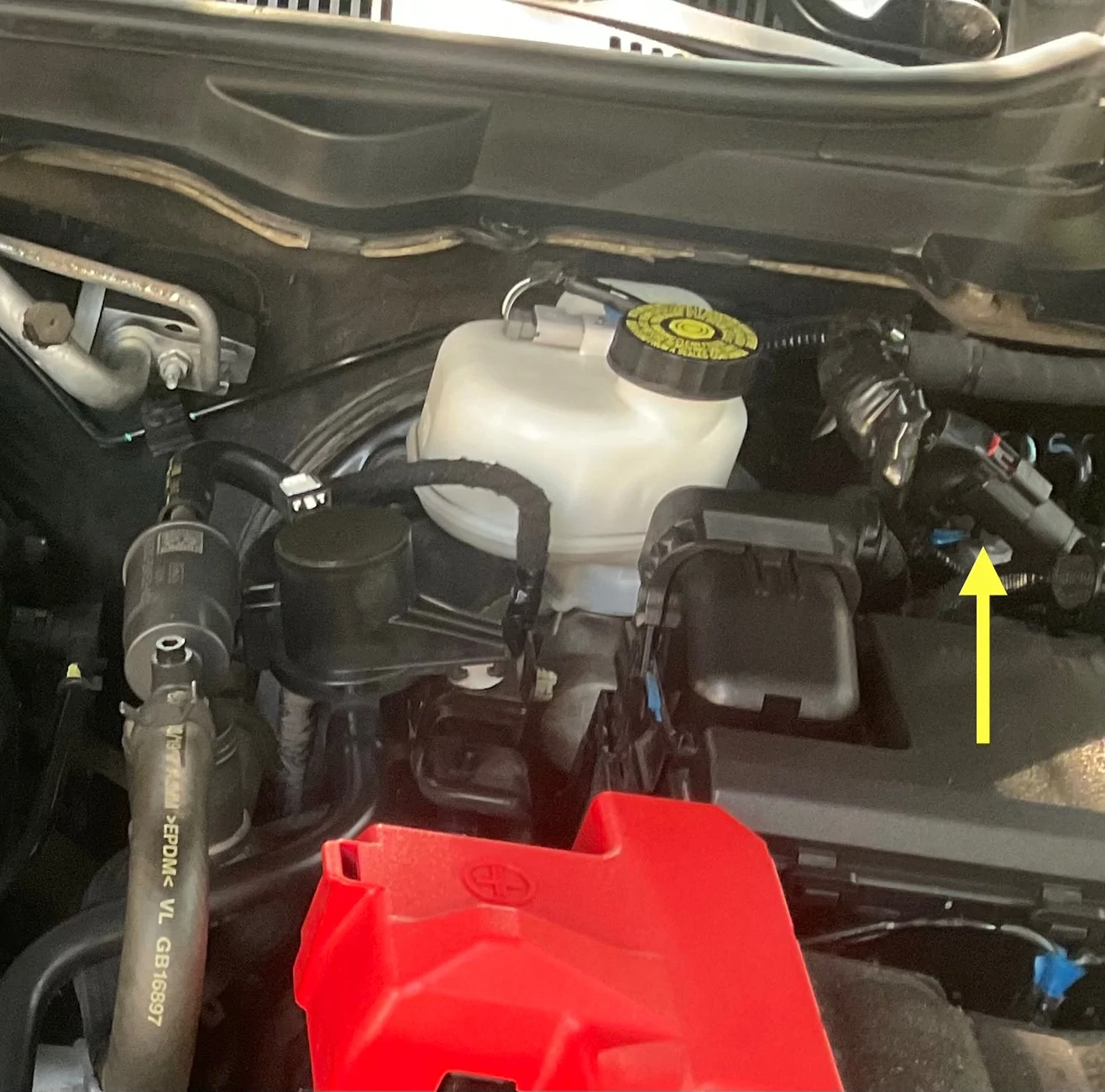

If it persists, check the wire harness connection up by the brake fluid reservoir for poor connection or wire damage.
Rodents chewed mine up and I was getting the same alert message.
Hopefully, you’ve already solved the issue.
Thanks. Ill check that area next.

looks ok.

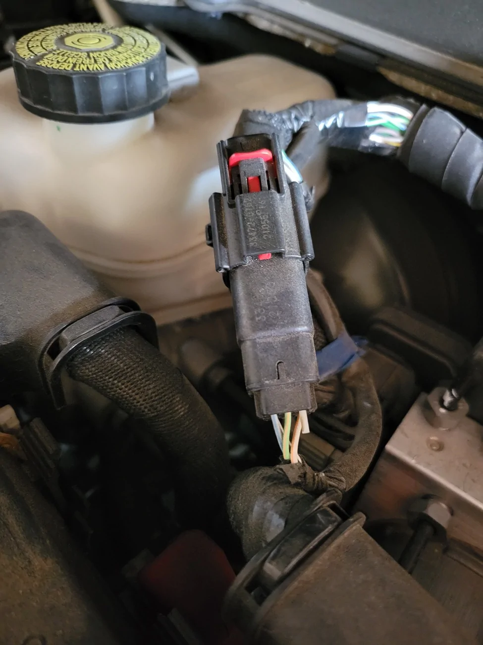

Looks ok but the light gray wire is cut short with nothing to connect to. Normal??
Mine has that too. It is a plastic piece, not a wire.
Since your CCM was loose, I still think you have an alignment issue with it or it is still not fully seated. I had the same issue with mine being bumped out of place and it took considerable force to reseat the module and its mounting plate.
