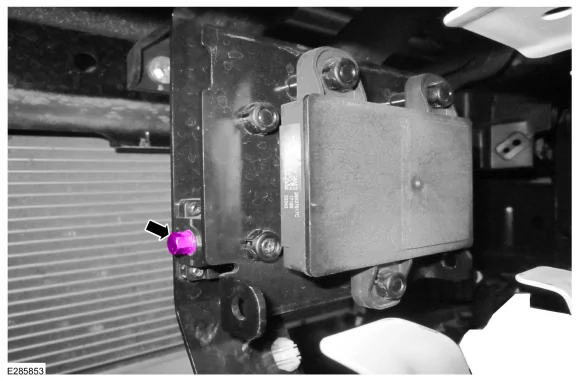

Just a FYI - the cover is just a cover with 2ea push pins, this is the actual CCM mounting to the bracket - the (Highlighted Bolt) is the Vertical Adjustment (Level) using a combo-square and the Horizontal adjustment is via Scan Tool (Software-Calibration) Left - Right of the vertically centered CCM
The adjustment bolt moves the mounting bracket

The CCM is attached to the truck via 7 (as far as I know) mounting pins, 3 for the module and 4(?) for the metal mounting plate. Any one being unsnapped will cause a CCM misalignment. The cover is not what I was referencing. When you get Forscan going, post the DTCs here.
