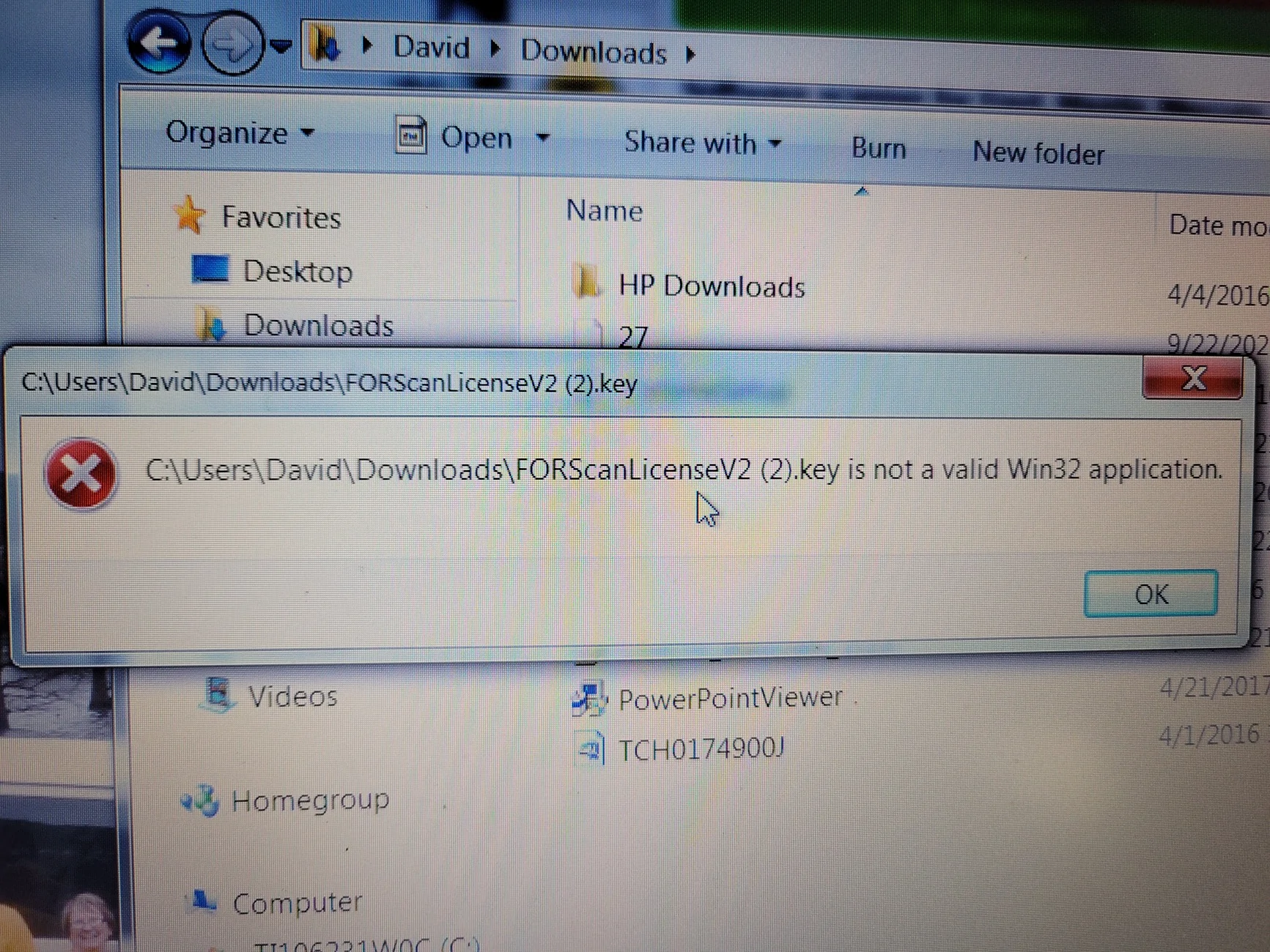

Forscan came in this afternoon and I've got a headache trying to download software. My old laptop has windows 7 and dont recognize the software. No application to open it. Ill try the Bluetooth setup on my phone later. Got to clear my hear.

That is the license key file for Forscan, not the program installation file. The installation file has the words FORScanSetup in it. The program works with Windows 7 and shouldn't be an issue. You use the license key file after installing the Forscan program. The current version is FORScanSetup2.3.70.release.exe.

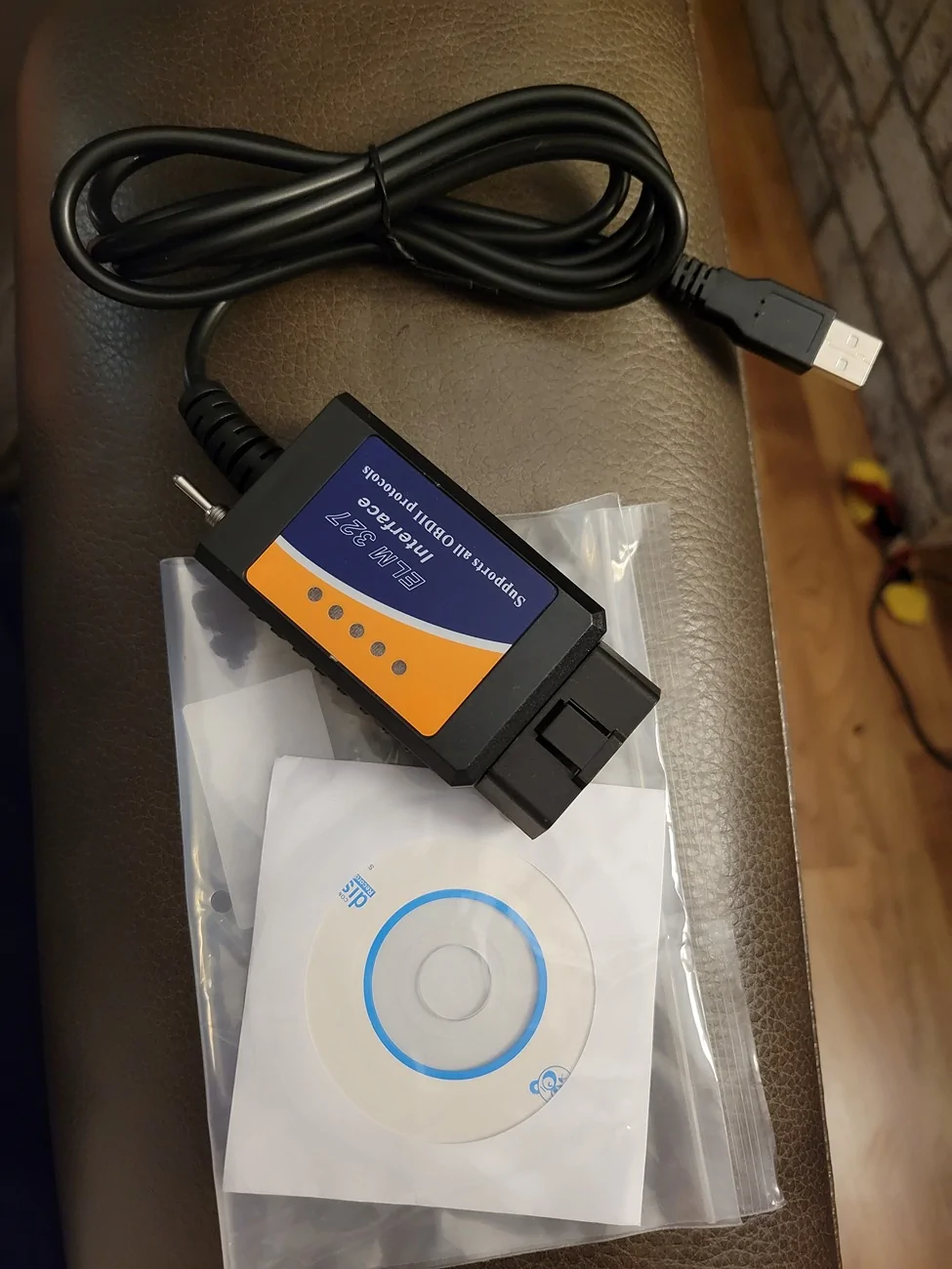

It came with a little cd and no other instructions. Ill get back to it in the morning. I appreciate your patience and help.

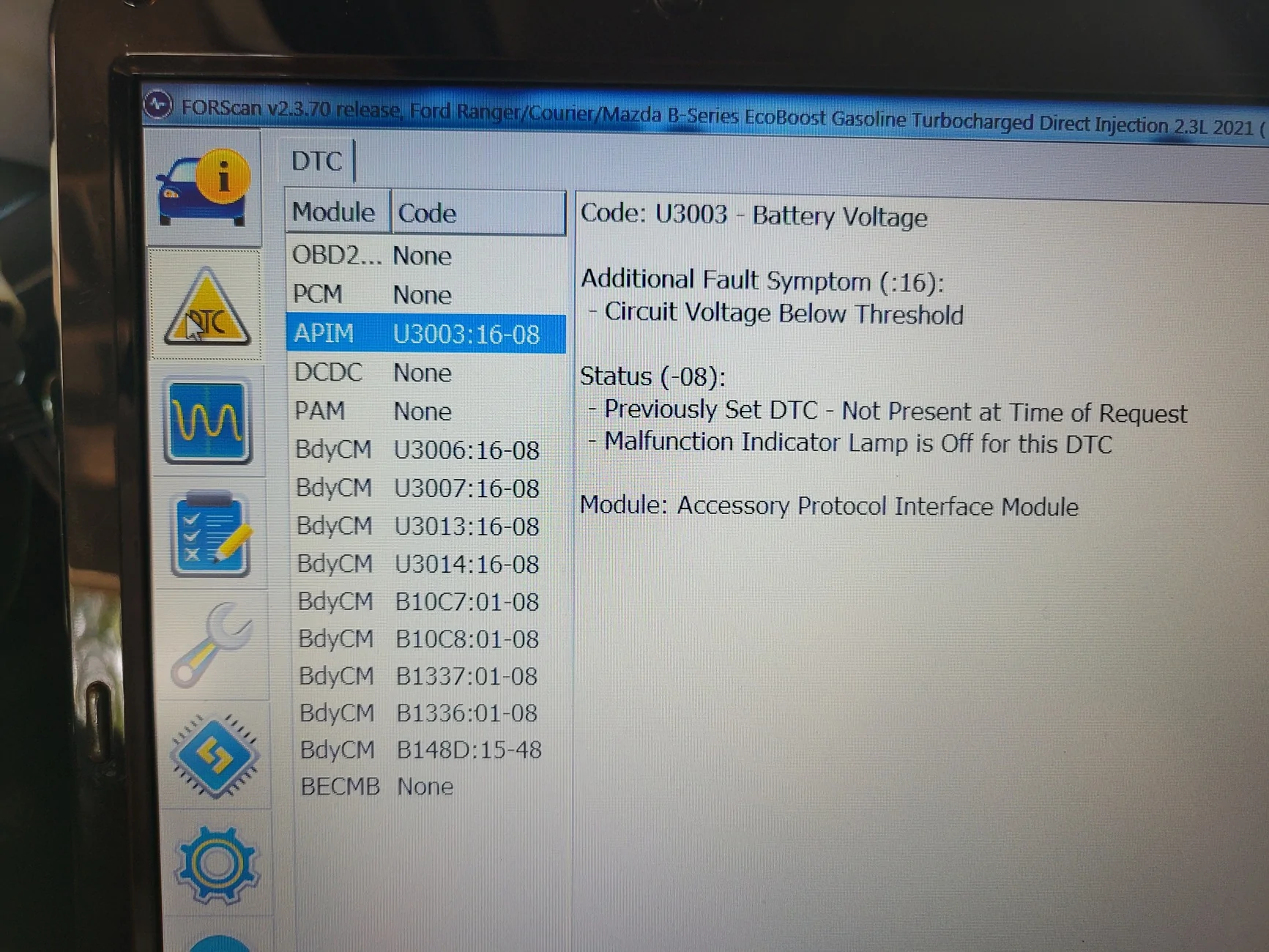

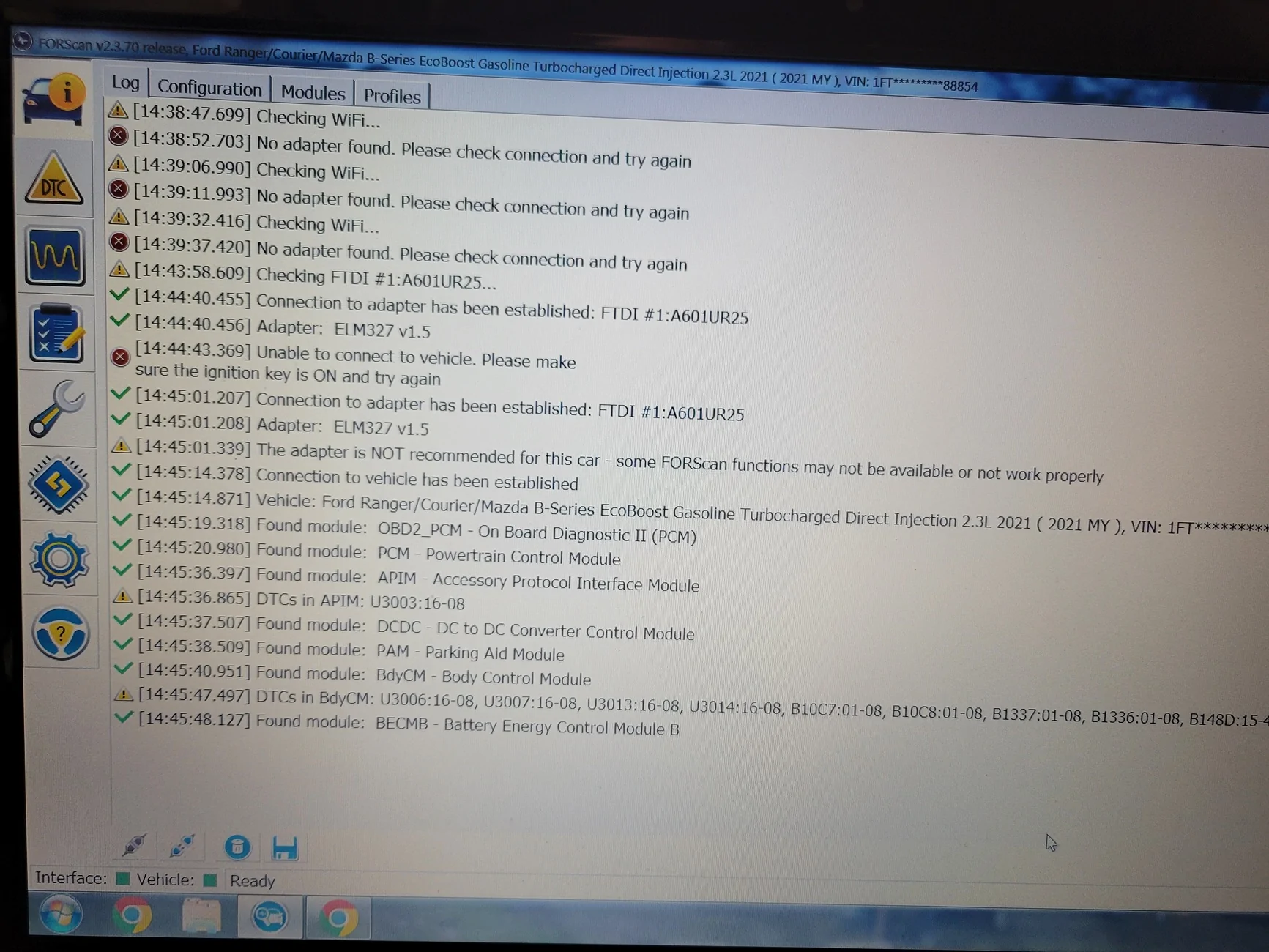

I got it. Here's what I got when plugged in to truck.

Click on the DTC tab on the left to get more information on decoding the DTCs. Also, your OBDII adaptor isn't fully supported by Forscan, so you may not be seeing all modules in the truck. They have a couple of approved adaptors listed on the Forscan web site. https://forscan.org/home.html

Click on each fault code to see what it means. Your adapter is not communicating with all modules in the truck. You should be seeing an IPMA module which is used for the collision detection system.
