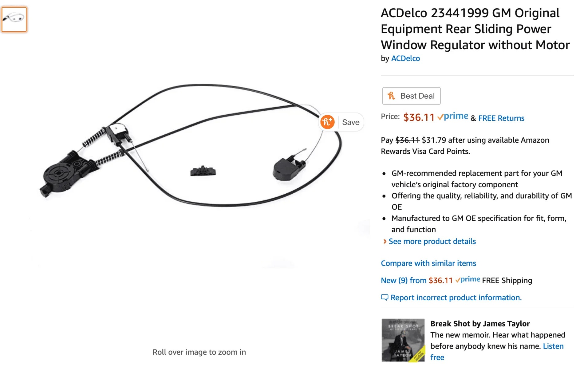

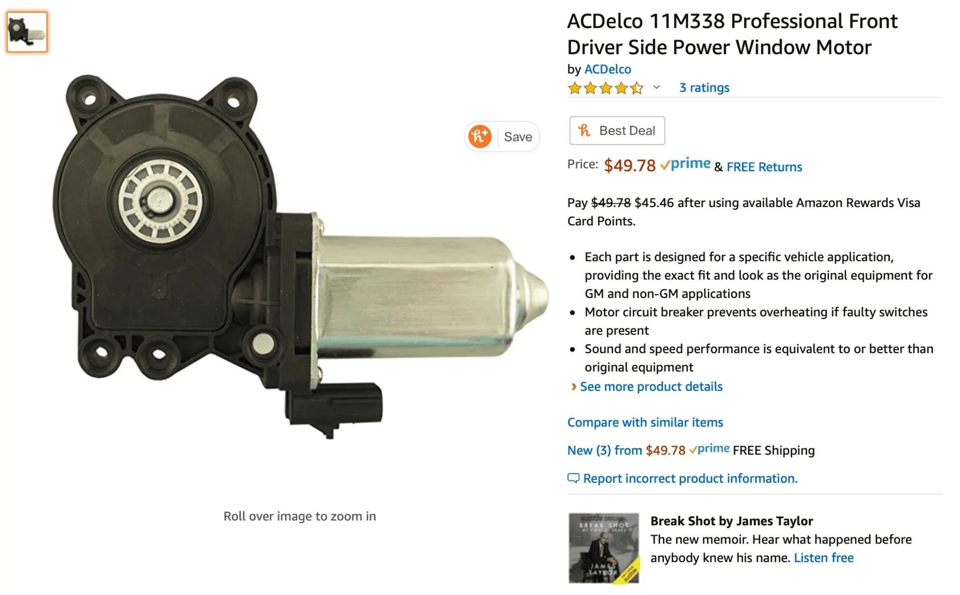

I was the DIYer that did some research on a solution. No kits available unfortunately but I put together an actuator and motor from amazon. Kind of a frankenkit so to speak. While I haven't gotten around to actually completing the install since a baby and winter came, I did manage to do a quick mock up when I found a spare 30 minutes back in October. It did actually move the window but I needed to come up with a different bracket to hold the ends of the cable to each side. My 3d printer should be able to handle this once I draw something up. I have nylon filament that I am planning to use which should hold up to the extremes of temperature. Below is the actuator and motor I went with on amazon. Once the weather starts to warm up again I'll be more motivated to finish this and share the results. If it ends up working out well I'd be more than happy to try and help whoever is interested.
Edit: I should mention the motor doesn't match up perfectly with all of the mounting holes so there is a motor out there that does, it's just not that one and I haven't found it yet. However, I believe the one below matches up at two points. The gears line up well.

Here are some screen shots that may help you do your own search directly on amazon.com.

Phil,
I see the thumbnail images which are clickable links. With the screenshot, you should be able to search Amazon using the GM part number.
